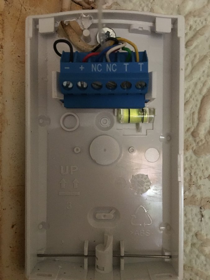

I've recently taken the challenge of setting up the alarm properly and came across a few issues.

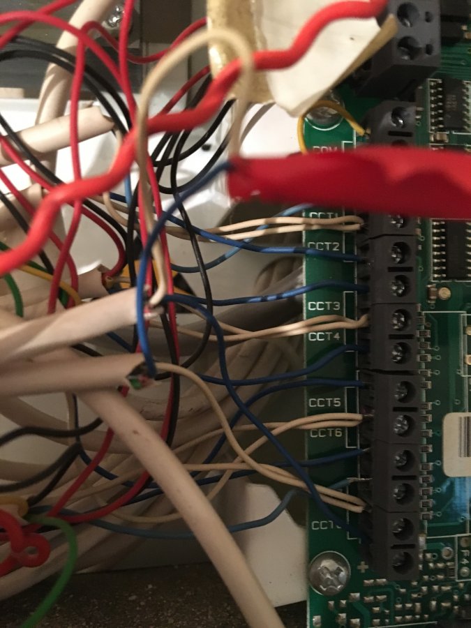

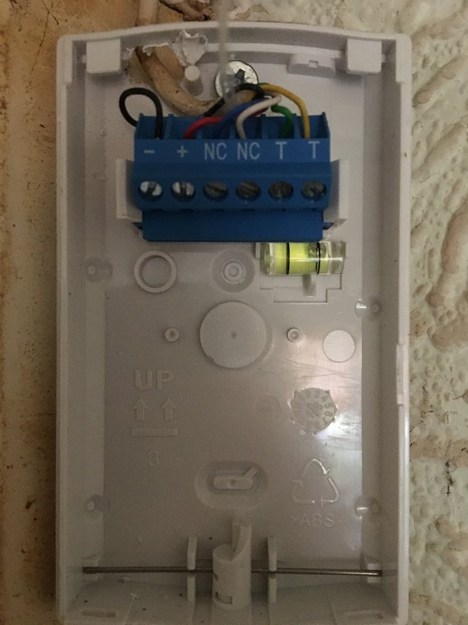

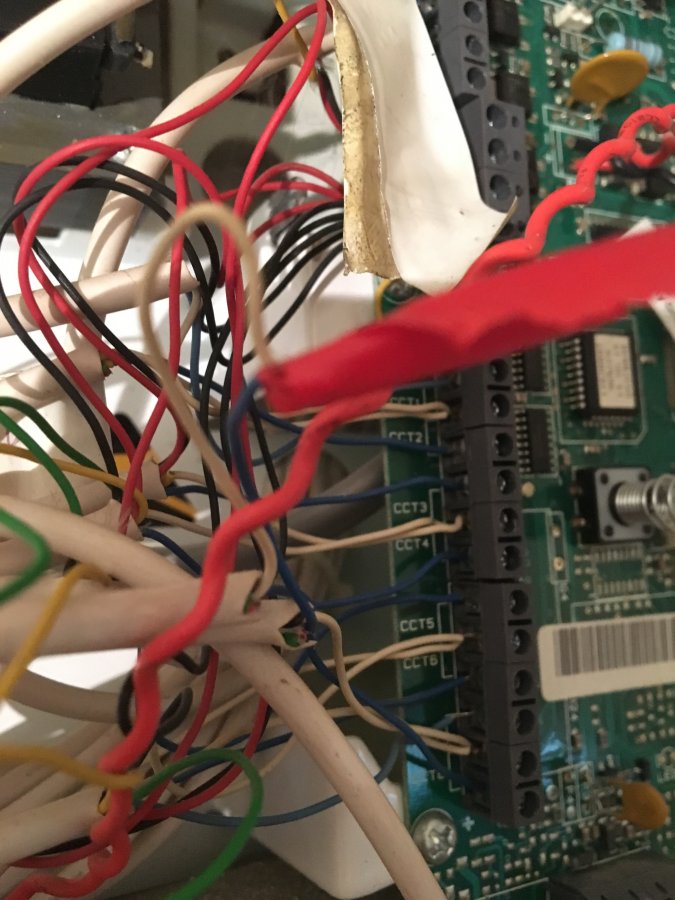

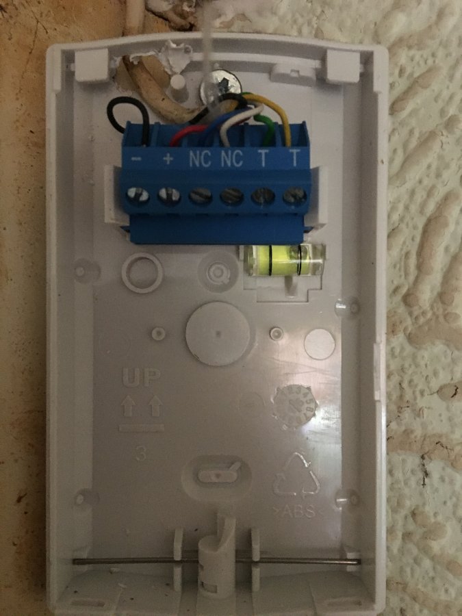

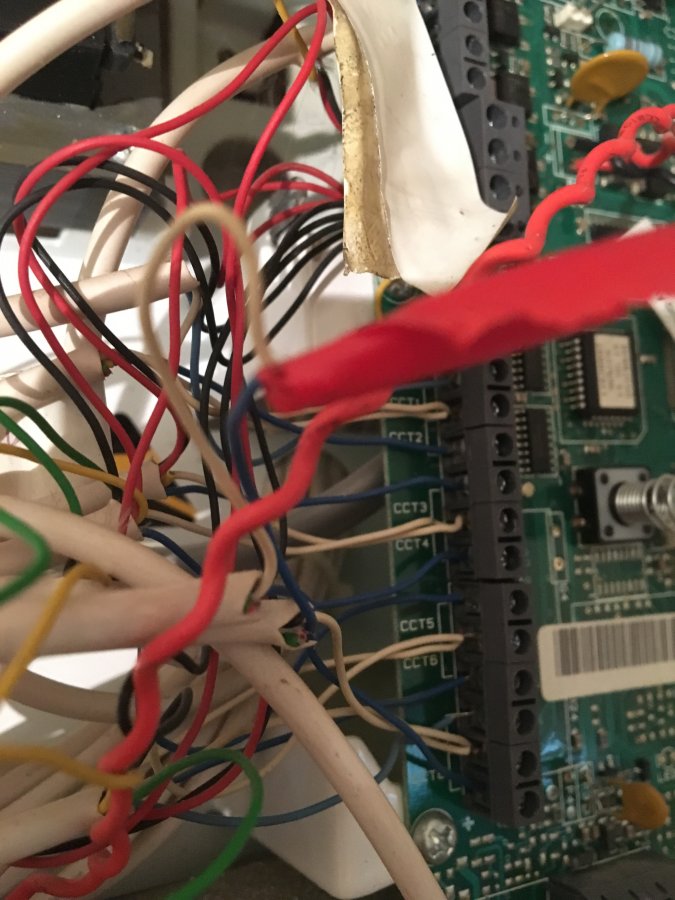

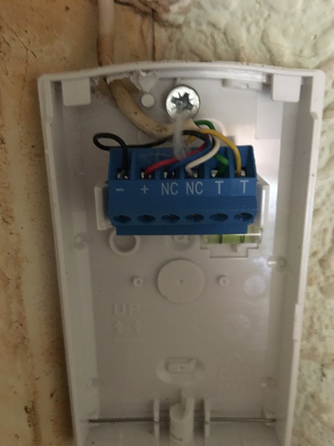

Firstly the kitchen PIR (Zone 04) is apparently always open, everything works normally as in it flashes when you walk in front of it but I can't set the alarm unless I omit the zone. I changed the PIR (since I needed pet friendly ones anyway) thinking it was that but it's still an issue. I uploaded pictures in case anyone can tell what the issue is, I only need a indication of what it could be and I could probably diagnose from there. I suspect something to do with the cable which I hope not because I would have to pull up the floor to replace it.

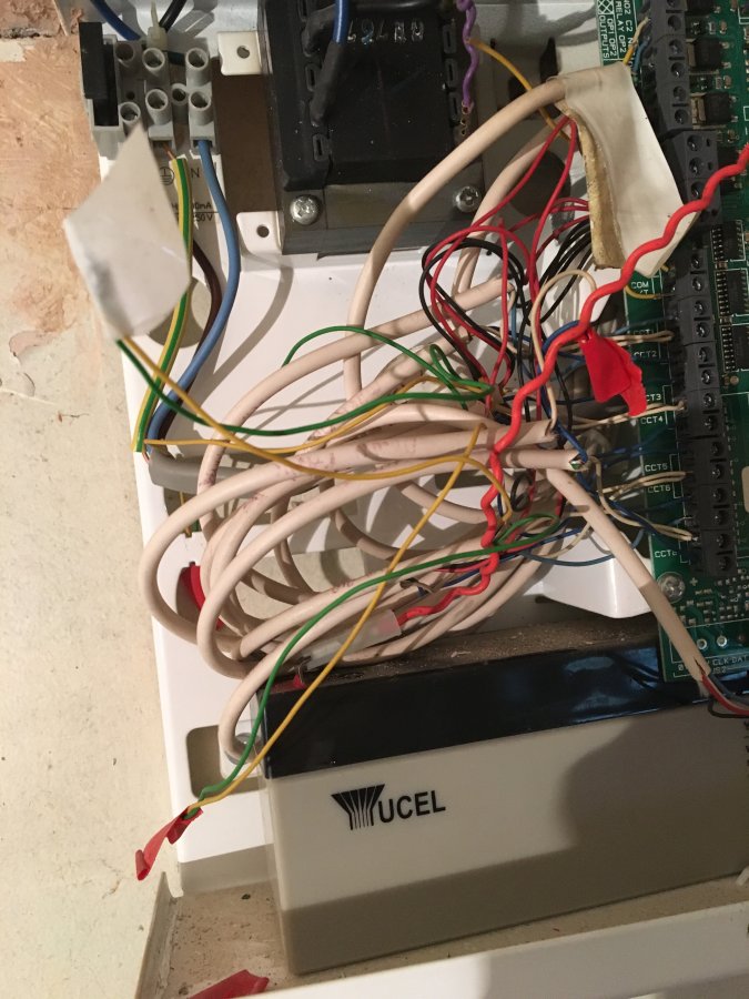

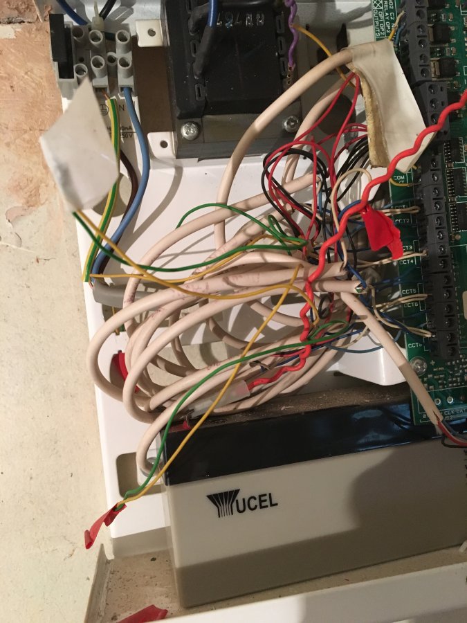

I already had an engineer out a while ago when it had a fault, he setup the alarm again (well hardly; but got it running) but rather than fixing some issues like the alarm PIR I believe he may have cut a wire in the box (in one of the pictures the green&yellow wire which I reconnected with white tape).

a zone remains open, if the device is;-
1. wire is broken
2. fault with the device
3. interference

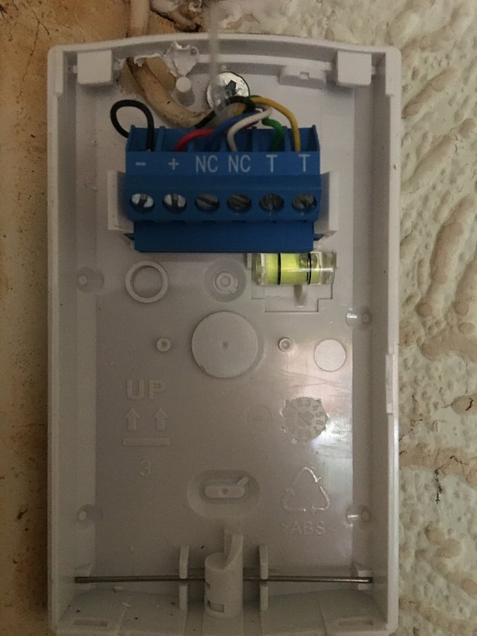

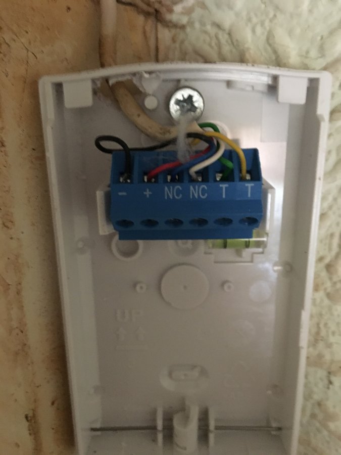

There are 6 wires, two power, NC (alarm pair) blue and white, and tamper pair yellow and green at the PIR end.
you have the alarm pair taped up at the panel?

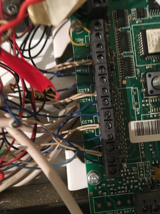

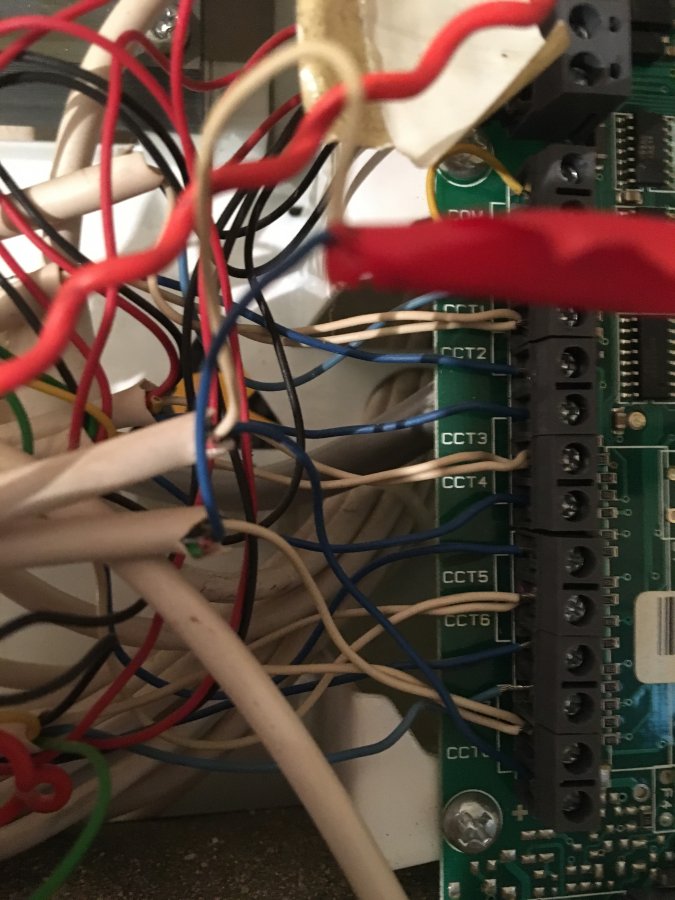

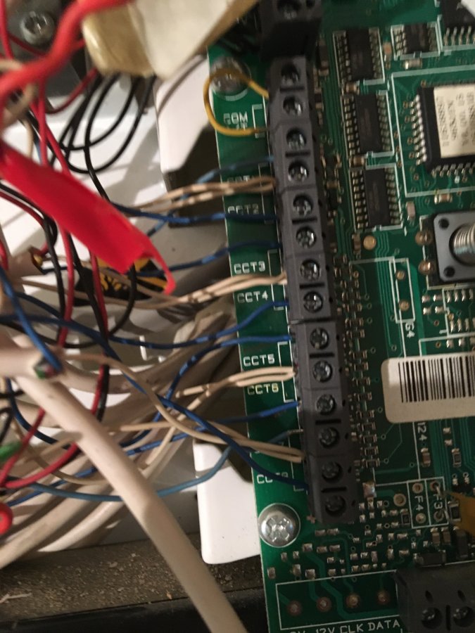

I'm fairly familiar with the wiring now, but the wiring wasn't done by me. I believe the alarm pair is attached to the correct zone at the panel, then goes straight to the PIR? so CCT4 is the zone 4 PIR which appears to be connected? (I added panel images as I'm not too familiar with wiring)
If the zone is open does it suggest the circuit is complete (the NC pair is connected) or the opposite?
If the wiring isn't labelled up, you will have some fun verifying whats going on and what the last guy did.
if it was working after the last visit then it would be safe to assume that the wires are connected correctly, the problem is you don't know if theres a break in the cable.
twist the white and blue together or a link them together at the pir and do you still get it permanently active.
do you have a multi meter?
The wiring is slightly labeled but it's fading I'm trying to make out what it says.
It never was working properly since the last visit but the engineer didn't fix it correctly. I just recalled yesterday when I was messing about in the panel box that the kitchen PIR was constantly coming up on the walk test when nobody was there, but then it stopped when I was looking in the panel to diagnose, perhaps there's loose cabling in the panel?
But it doesn't appear on the walk test now yet it states it's open when I try set the alarm; that doesn't seem right?
I twisted the white and blue together and didn't get permanently active.
Unfortunately I don't have a multi meter, would probably make this process a bit easier eh?.. all I can do is trial and error right now.
Just had another look inside the panel, I can make out the kitchen PIR cable label and a few other PIRs, but it seems to be connected correctly, I removed it and made sure the wire contacts were out and put it back in but still nothing- doesn't detect me on a walk test. I'm really lost now..
UPDATE: I stripped the wires in panel down a little and then reinserted it, the PIR now seems to be working correctly, but whilst I was diagnosing the wires I tried setting off the tamper on the sensors and it doesn't trigger it for any. Could anyone give me an idea why that is, and (tamper wasn't wired..) any help with the other issues in the original post?

a device only detects on walk test if it changes from inactive to active state during the test (usually).
if its already open it wont detect.
if you put a link in at the panel and start the walk test then take the link out does it walk test?
Strange so the PIR was always active before? Could that suggest a cable fault? It's seems to be working fine right now; detects me on walk test; alarm sets correctly.
