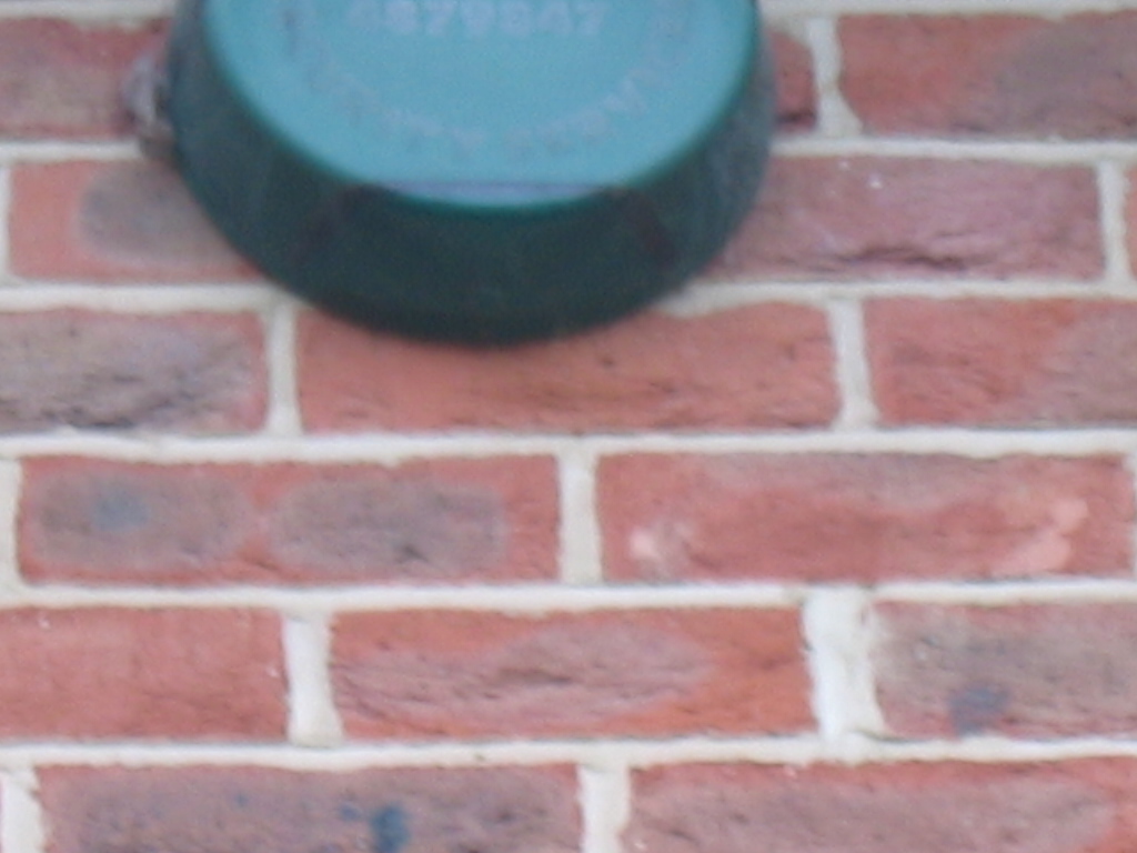

Unfortunately I don't have a crystal ball..so it could be one of a hundred different bellboxes that have been on the market in the last 17 years ! Posting a picture of the bellbox may help ...and if that battery has 10.9v in it ...then it's faulty ....your looking at 13.8v even at this voltage there may be no capacity ..
Thanks so much for your help 'Sparkymarka'. I know what you mean regarding the variety of Sounders. The one I have has been customised to have the name of the installation company on it and that company is no longer in business, so I doubt I will be able identify the manufacturer unless I can get into the box. I will get a ladder out tomorrow to have a close look at it. It looks like it has a special access device on it but I will have a closer inspection tomorrow. Thanks again for your advice.
It was too late for me to get the ladders out tonight so I tried to take a picture using a telephoto lens which did not turn out too well as I was not on a tripod.
I will take a better picture tomorrow and send it on but you may be able to identify the unit with these very bad out of focus shaky images.

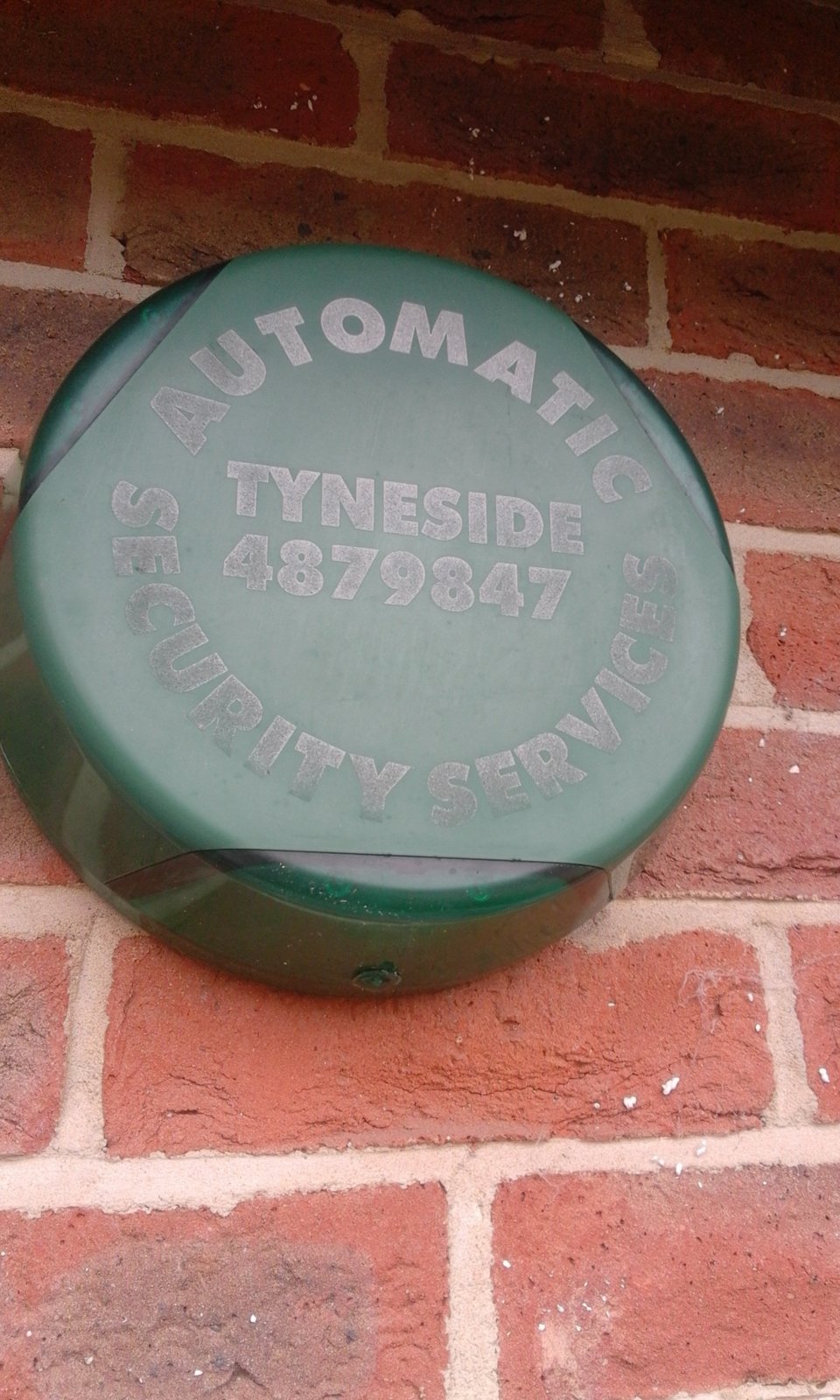

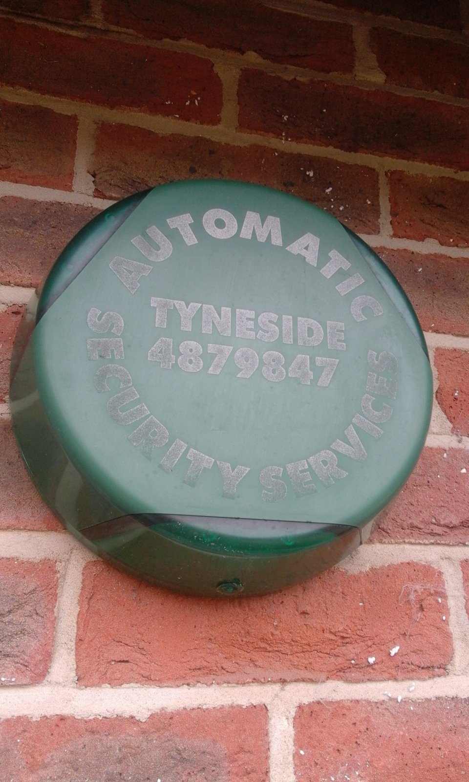

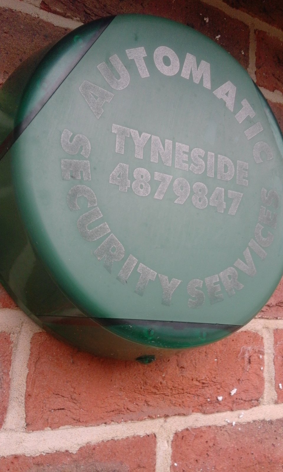

Hi Sparkymarka. I got the ladders out and took some better pictures attached. There is a plastic 'bung' in the bottom and removal exposes an allen screw. Not sure what this Screw does but I suspect it will release the lid, but unless it is a captive I will have problems re-inserting it therefore I am reluctant to unscrew it.
I di what you suggested and disconnected Power and the Battery, the outside sounder went off so I left it for 20 minutes to see if it timed out. Good News it did time out. So all is dead now and hopefully de-activated. Not too sure if the outside sounder will stay quiet because if it timed out then clearly there is some electronic timer somewhere in there. If this timer is designed such that when it times out the Battery is disconnected from the electronics and therefore not subject to failure in the electronics which could re-energise the sounder.
Another web site suggested that the sounder could be silenced by linking TR (presumably Tamper return) to 0v. Not sure if this would be advisable because when I sell my house the new owner would not be aware of this inking out and I would probably forget all about it when I sell up.
Now that it is all peaceful and disabled, I assume if and when I decide to re-instate the system by buying a new Battery, simply re-powering up will be all that would be rewuired, or would I need to do an Engineers reset or maybe a user reset to bring the thing back to life.
If a reset is underrated, does that reset to Factory settings and therefore the whole thing require reprogramming. Also if I leave the thing de-powered, does this result in a reprogramming to be required. The instructions for a reprogram are not very clear.
Anyway here are the pictures I took of the sounders that you may be able to identify,
Thanks again for all of your help, assistance and advice.

Just leave it as it is , make sure the fuse is removed in the spur as powering it up again may restart the bell timer , it should keep all the settings but to be honest due to the age of the panel an upgrade may be better at a later date
