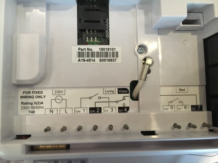

I'm trying to wire my SP Connect to my Valliant boiler.
I've found this but not sure how to wire the heating and water (if needed) to the boiler
Here's the Connect
Here's what I'm thinking:
Connect - 230 L & N to Boiler L & N mains connection (X1)
Connect (if neeeded) - C0M 2 to Boiler L mains connection (X1)
Connect - COM 1 to Boiler L mains connection (X1)
Conneect NO 3 to Boiler RT 230 V AC room thermostat (X1)
Do I keep the bridge on 24 V DC room thermostat (X100) or remove it??
Thanks for any help!!
