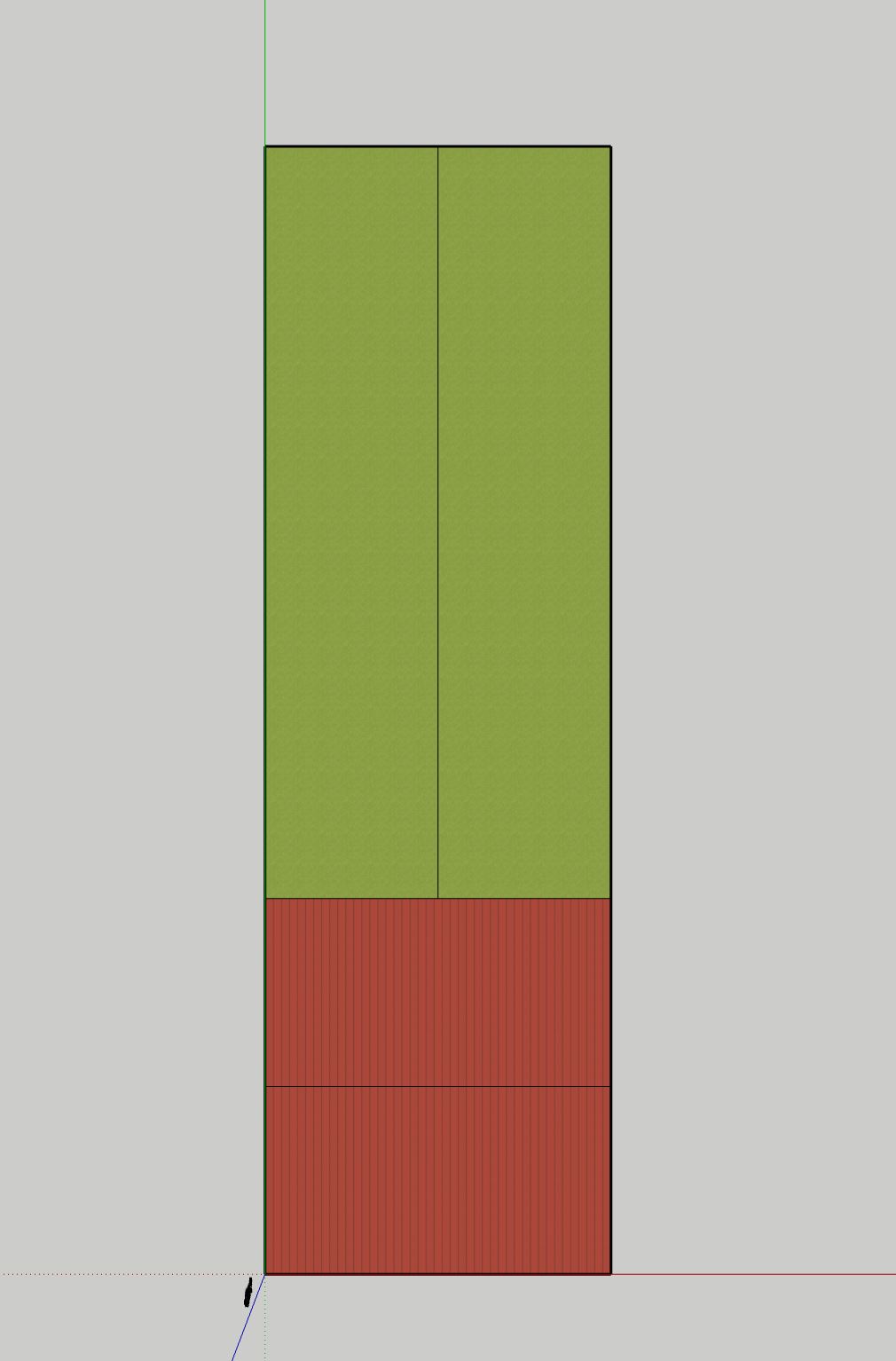

I am attempting to put a fence up along a rather large (150ft) garden. The actual fencing process itself I am ok with having completed fencing at the front of the property successfully.
My question is one of setting out. I need to fence to be at a right angle from the house and to extend in a straight line down the garden.
Does anybody have any suggestions how I can achieve this? I did think about an infrared laser level or something similar but am not sure if that will do it.
The image below is a top down example of what I am trying to achieve, anyone have any suggestions?

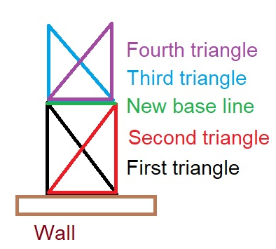

Hi Bernard, thanks for the suggestion. My issue with this method though is how to carry on the measurement to the bottom of the garden.
A string line is stretchy so my measurements are inaccurate. Could I just do this with regular string / twine instead? Or is there a recommended way to extend the line once I have it measured?
Once the 3L base line on the house wall is set then a pair of metal tape measures can be uses for the 4L and 5L
If the ground is level and clear of obstructions then the line can be extended using multiple 3,4,5 triangle and pegs at the ends of the new base line.
So do the initial triangle setup and put a stake in the ground, then string line from the house to the end of the garden making sure the string is touching the stake?
Basically, yes.

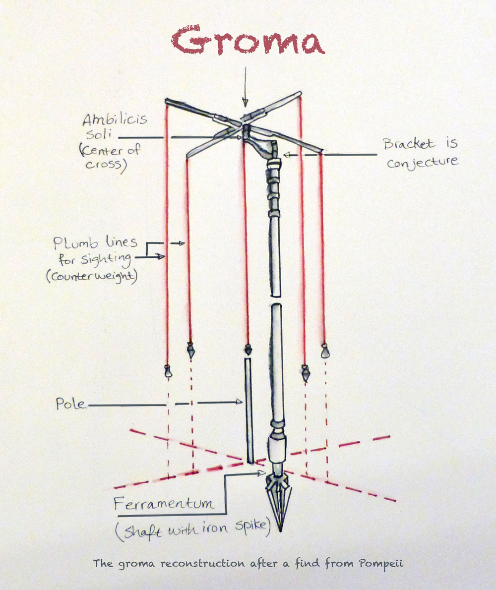

Also, the romans used a square cross, sideways, mounted on a pole.
Hang a plumb line from the four ends of the cross, so it can be held perfectly level.
A pin in the end of two of the cross ends allows a sighting line to check any posts that you insert along the way.
A Groma
