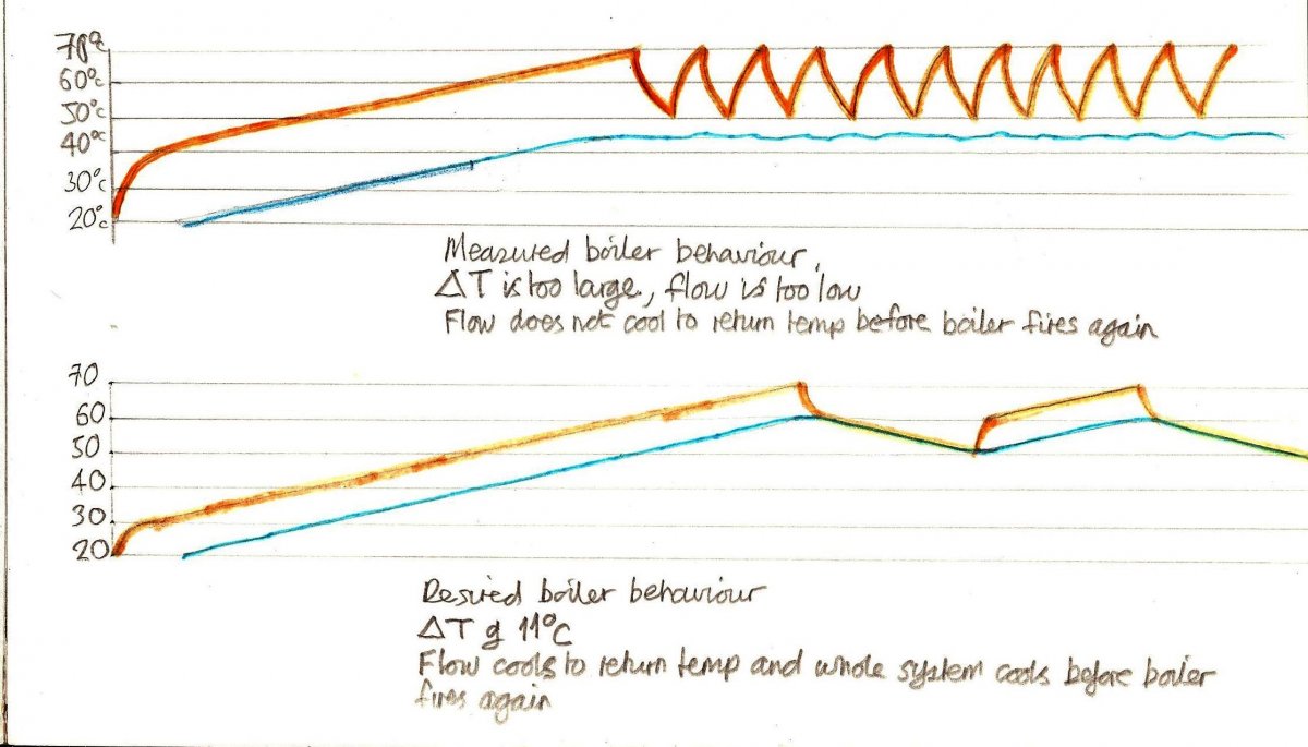

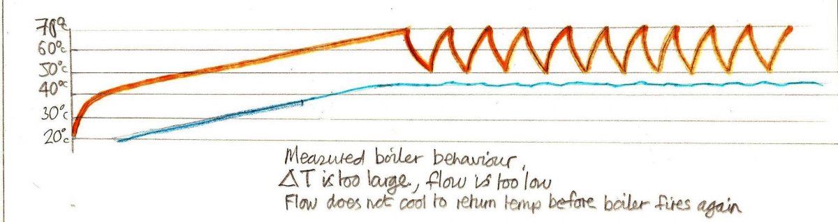

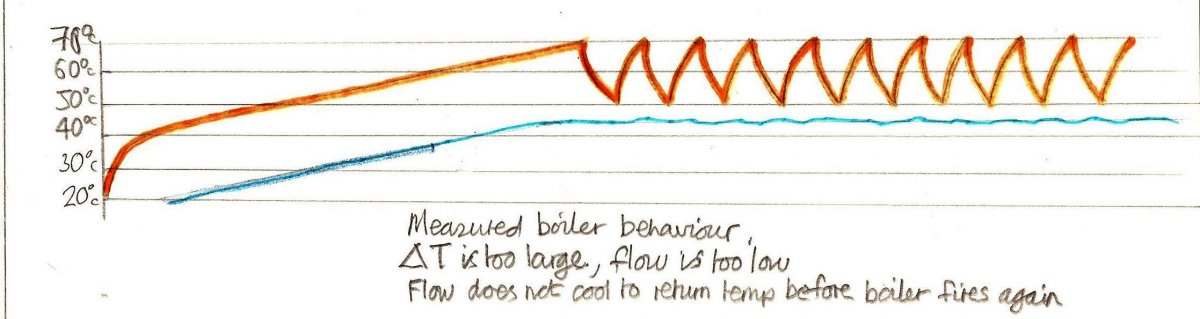

After spending quite a bit on plumbers who did not help, I decided to invest 40 quid in a dual input K-type bead thermocouple digital thermometer. The Rayburn has the flow and return pipes exiting the range on the left hand side. I therefore clamped the two bead thermocouples there. Since I am simultaneously now measuring flow and return I can subtract one from the other. In addition the meter also gives a direct T1 - T2 readout. I have been away for a few days and posting from my mobile, which was not ideal. I measured again on returning home this evening and saw a differential of about 22°C from 70°C flow to 48°C return. So it might vary from time to time but bottom line is that the differential falls in that range of 20-25°C. This differential is really only noticeable before the boiler starts short cycling. I tried to make a sketch of how it looks. Red is flow and blue is return.

Thanks for the explanation. The short cycling is due to the boiler output being more than the rads can absorb. (Do you know the total kW of the rads?)
Your boiler has pump overrun (the pump keeps going for a few minutes after the boiler switches off) so, as you have an S plan, you must have a bypass connecting flow to return. This should be connected to the flow after the pump and before the motorised valves.
1. Do you have a bypass? If so what type (gate valve or automatic) and what setting is it on?
2. Does the pump overrun work? (Pump light stays on for a short time after boiler goes out)
Thank you, but I'm afraid I have to differ. As you can see from the graph, I have 20°C difference between flow and return as the system warms up from cold. Since Rayburn specifies 10-14°C and plumbers tell me that 11°C is the magic number, the only interpretation is that I have insufficient flow. The reason that the boiler is short cycling is that the deltaT that I have is bigger than the hysteresis range of the boiler thermostat.
Pump overrun is nothing to do with it. The boiler is on continually during the period of the sketch graph I made. The sawtooth pattern of short cycling is caused by the boiler thermostat turning the burner on and off.
But yes I do have pump overrun and an automatic bypass set at 0.4
No problem. :D
There's no magic in 11°C, it's 20°F converted to Celsius. 20°F was supposed to be the ideal drop across a non-condensing cast iron boiler.
Yes, a low flow rate will produce a high differential. This will be caused by a circuit resistance higher than the pump can handle at the required flow rate. This could be due to a partially blocked heat exchanger.
Sorry, but I don't agree with that.
The boiler is turned off by its internal stat because the flow temperature is rising above the set value, which will happen if the boiler is producing more heat than the rads can emit.The hysteresis just determines the temperature at which the boiler turns back on. This is independent of the flow/return differential.
Up to a point. With a fixed output boiler where you cannot turn down the heat, the only way it can work is to turn the burner on and off. This will always happen as the system and house get up to temperature. But there is an enormous difference between running for five minutes and off for 5 minutes, which is what I would call normal behaviour, and on for 30 secs and off for 30 secs, which is the short cycling I am seeing . I have expanded my sketch so please take look. My boiler is behaving as in the upper sketch, on and off every 30secs, and I want it to behave as per the lower sketch.
I am also inclined to think my problem is a partially blocked heat exchanger and will be looking to see if a power flush helps.
I didn't appreciate that the boiler was cycling so rapidly as there is no time scale shown on the x axis.
The temperature drop when the boiler is off will depend on how pump overrun is controlled. Some boilers have a timer which runs the pimp fro a fixed time; others are thermostat controlled - the pump runs until the flow temp has reached a set temperature. The manual does not say which type is used, but I suspect, from the wiring, it is temperature controlled.
