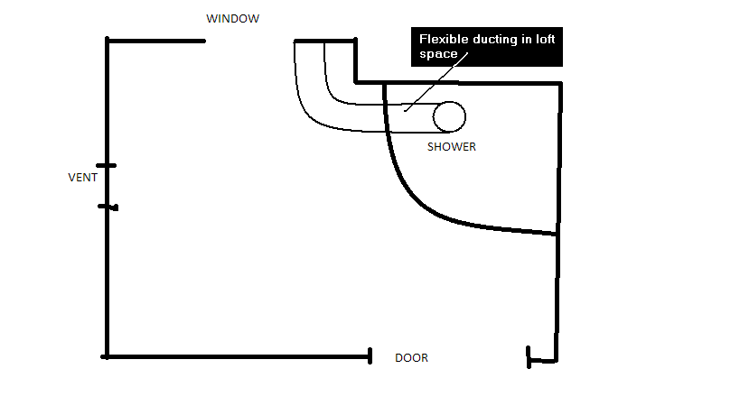

I'm having a complete new bathroom fitted, which will need an extractor.
The fitter suggested that the fan should be fitted inside the shower cubicle, but the existing vent is over the bath on the outside wall across the room.
I would like to know if it is ok to fit it in the shower and make a duct in the loft then down the inner brick of the outside wall to the existing vent, so it doesn't show in the bathroom? I wonder about condensation.
Cheers, Camerart
It should be ducted out through the soffits or the roof, that would be much easier than doing what you seem to be proposing. An inline fan in the loft with a vent in the shower cubicle would be the best way to do it in my opinion.
Where is the door in relation to the vent? Is there a window?
Hi E,
The existing vent wall and the door are on the opposite corner to the shower. The window is opposite the door wall, and I think out of the question, if you are thinking about putting an extractor in it. Thanks.

Hi E,
Here's a picture:
I would like a fan that comes on when the shower is on and goes off after some time. There are no particular damp problems.

Clearly - above/in the shower would be the best place.
Hi E,
It's just occurred to me that I could go round the chimney with a flexible ducting above the ceiling.
As the outside is difficult to get a ladder to (There is a lower roof) is it possible to fit a wall vent only from the inside? Does the hole need to be drilled from the outside, or if drilled only from the inside, do the bits drop outside or do they stay inside the cutter?
C.
There will be some debris that will fall down, but most of it should stay inside the core drill.
