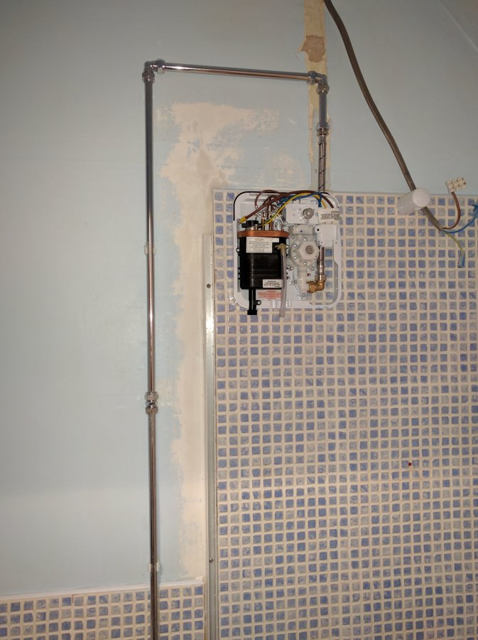

Hi ,
See attached photo for the plumbing route of the cold water inlet feed.
The electric cable also passes in at the top of the shower, which means it is going to be tricky to cover it with a conduit.
I could chase in the cable possibly? I could cover with a conduit as much as possible?
I could just use cable clips ?
Advice sought?
Thanks in advance
Tony
Chase it in. Anything else will look pants. Although the pipework isn't pretty as it is.
Cheers ... it will look better when the shower screen is up and painted etc ... hmmm I didn't think the pipework looked that bad .... how could it look better ???
Take the pipework across underneath, and make a bottom connection, and lose the flexi!
I'd put the cable in some mini trunking if you cant chase it in, cut the end of the trunking as best you can to fit against shower casing, and seal with some silicone sealant to prevent water ingress into the shower.
There will be a fixed shower screen at the side of the bath, so going over it is the only option ... the previous owner cut a hole in the shower screen and had the pipe going into the bottom of the shower.
If I ran a pipe into the bottom it would look worse IMHO (as it would go round the shower!)
I think I'll chase it in
Have you run that cable for the shower ? is it correct size for kw of shower ? have you got RCD protection on that circuit.
Should be a cut out at the bottom for bottom entry pipework, make good the slot in the screen with silicon. Either way, lose that flexi, it is awful. Check the electrics as per above post or you'll melt something (or someone), if electric supply isn't man enough.
I have a new shower screen ... so I'm not even contemplating cutting a hole in it !!!
Maybe lose the flexi - agreed
Elec cables all OK - checked by a sparky.
