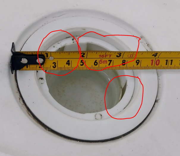

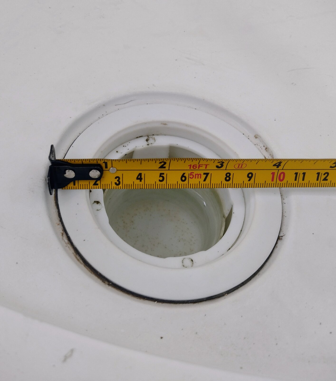

Please see pic of shower waste in its current form.
Can anyone provide a link (e.g. screwfix, toolstation etc) to parts I need complete the job?

What’s wrong with it? Currently has a water trap. Maybe it’s the incorrect depth, maybe it’s being siphoned out? Maybe you could give us more information?
Got a new shower fitted a few weeks ago.
I lost the silver drain cover so it was never fitted at the time.
I now want to complete the job and use the shower, but it smells
And i am assuming it smells because of the missing drain cover, lack of seal etc
So i wanted to ask the forum what parts i need to order.. As i don't want to make a mistake or over spend on parts i may not need...

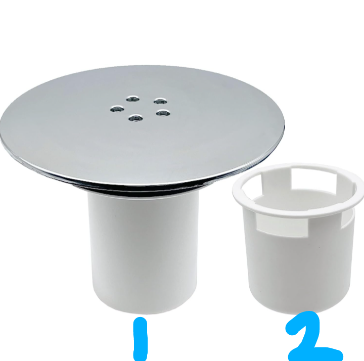

Do i just need the pictured? Also can the size i need be confirmed too?

You'll be lucky to find the correct part, they are normally bought as one unit, and are not interchangeable between different makes.
So what do i need to do?
Buy a complete set of what?
Go back to the manufacturer and ask whether they have spare parts?
What are the names of the parts required?
Do you know what make the trap is? Otherwise, probably best obtaining a new one. I wouldn’t think that’s the reason it smells like a sewer, usually the trap seal (water) has been lost or there’s an open end of soil/waste.
Shower trap, can you access things below the tray?
Doubt it.. But will have to check and report back.
So buy the shower trap pictured and job done?
No, but i can track them down via the bath company i bought the shower set from.
Can i not just purchase the fluidmaster @denso13 linked take the cap and cup (sorry i don't know the technical name) and bobs your uncle?

It does, the long white bit dips into the water and causes a seal. Without it the drain smells come out here, it is the open drain outlet,
Ahhh, I stand corrected, thanks.
Yeah, the standing water without the insert would be lower than the drainage outlet.
Thanks for correcting me.
I discounted the idea of a cover but hadn't considered the insert.
