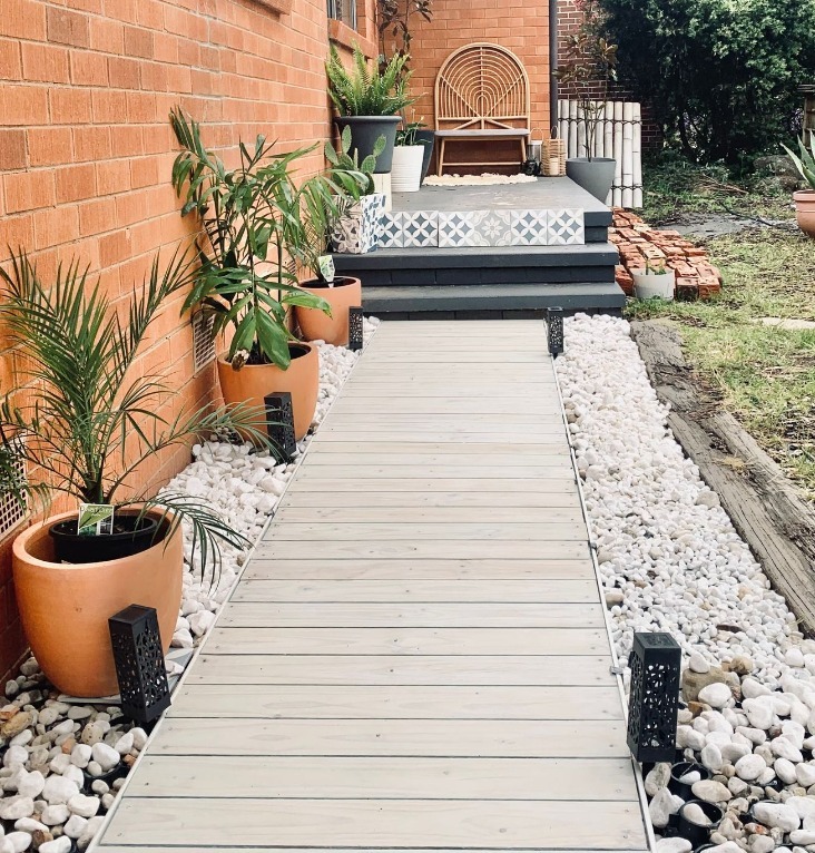

I've drawn up plans for a 700mm wide decking path using timber joists, decking blocks etc etc, but I feel like I'm massively over complicating it. I also want it to be flush with the grass level, so I'll need to excavate a whole lot of soil.

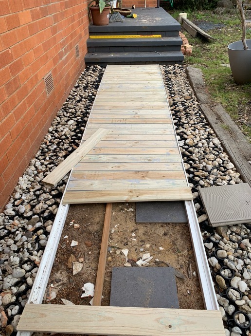

In these photos, I can see the guy has used some kind of metal or plastic L-shaped edging and screwed the wood to that with some slabs underneath to keep it level and spread the weight.
Can anyone suggest something I could use for the edging that I could screw the deck boards to to achieve a similar thing to the photo? Or any other ideas that will make the job simpler and cheaper than doing all the usual decking gubbins that are intended for larger areas with more traffic?
Happy to be told I'm just being lazy and I should do it properly! I don't mind about this lasting years and years as I'll be doing something better in a year or two when I've got the means.

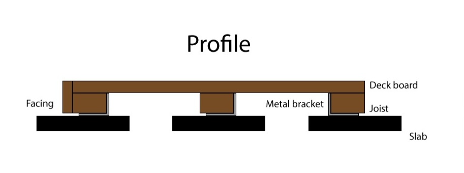

I'm going to do a mad experiment with a few old slabs spread apart that I'll attach rust proof angle brackets to the top of. I'll set 3 joists long edge on to the brackets and screw them in, then screw boards on top of the joist. Then I'll walk on it and see how it feels.
That'll be as low profile as I can think of for much less excavating, and leave no wood in contact with the ground.
I know it'll probably be crap, but who doesn't love an experiment?
