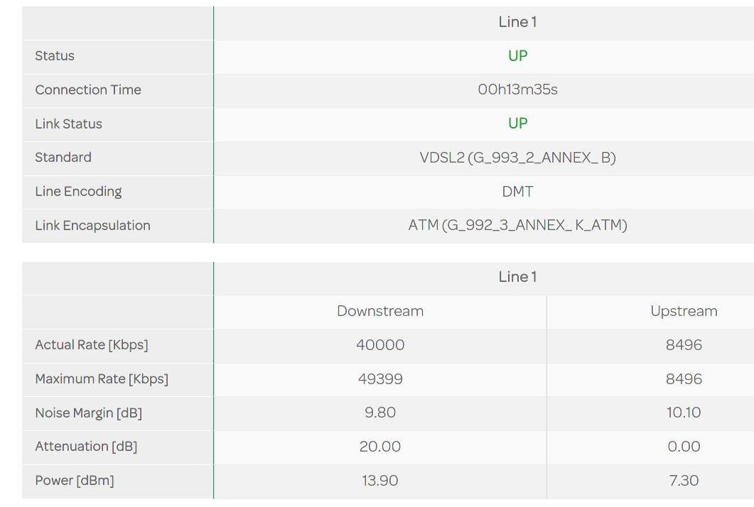

I've done a TT speed test and also looked at the line data values reported by the router. I actually have TT's Fibre 65 which is available in my area so speed I'm getting is pitiful.

Your router is reporting a downstream rate of 40Mbps, which is probably reasonable, but the device that you are doing the speed test on is reporting only 19Mbps. The problem seems to be on your side of the router.
Unplug/switch off all devices that might connect to your broadband except the one that you are using for the speed test, do you get a better result? Try the speed test from another device, when that is the only device connected to your broadband, do you get a better result? Preferably use cabled ethernet devices rather than WiFi devices for these speed tests.
While the router is reporting 40Mbps download speed a single wired ethernet device should be able to get about 35Mbps rather than the 19Mbps that your device is reporting.
There are three possible bottlenecks...
1. Connection speed as reported by the router
2. Download speed, which will be less than the above figure, but could be much less than that if the ISP throttles your speed or there is local congestion.
3. Then there is your connection to the router itself. Wifi is the slowest, wired LAN the fastest. Speedtests should always be done via a PC on a wired LAN, if you intend complaining to your ISP.
