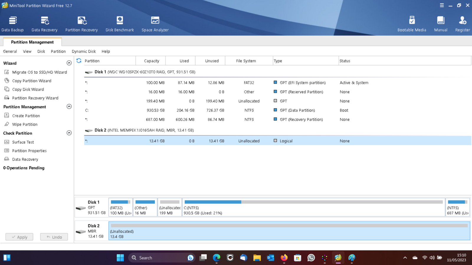

This laptop is still not running as it should! Win 11, it has a 1Gb HDD, 16Gb SDD, and used to run much faster/more responsive.
Cold boot is especially slow, so is coming back from hibernate.
It slow loading any software for first use, but much faster if closed and reloaded a second time.
Disk 2 is the intgrated SDD drive, shown as 'unallocated' - Might that mean it is failing to use the drive properly?
I may be wrong, but I believe that is what a Hybrid SSHD may look like to Windows.
If it is a hybrid drive, the SSD portion is purely acting as a large and fast cache.
The SSD has a limited number of write cycles - if it was getting near to EOL, the drive would revert to standard HDD speeds.
Ok, I'm not quite right - I had a closer look at the screenshot, the 2nd drive is a 16GB Optane drive.
In effect the Optane drive works in conjunction with the separate HDD to create a sped up hybrid drive.

The partition information (probably!) looks as it should...

Some troubleshooting steps to follow, if your Optane drive has become disassociated from the HDD...

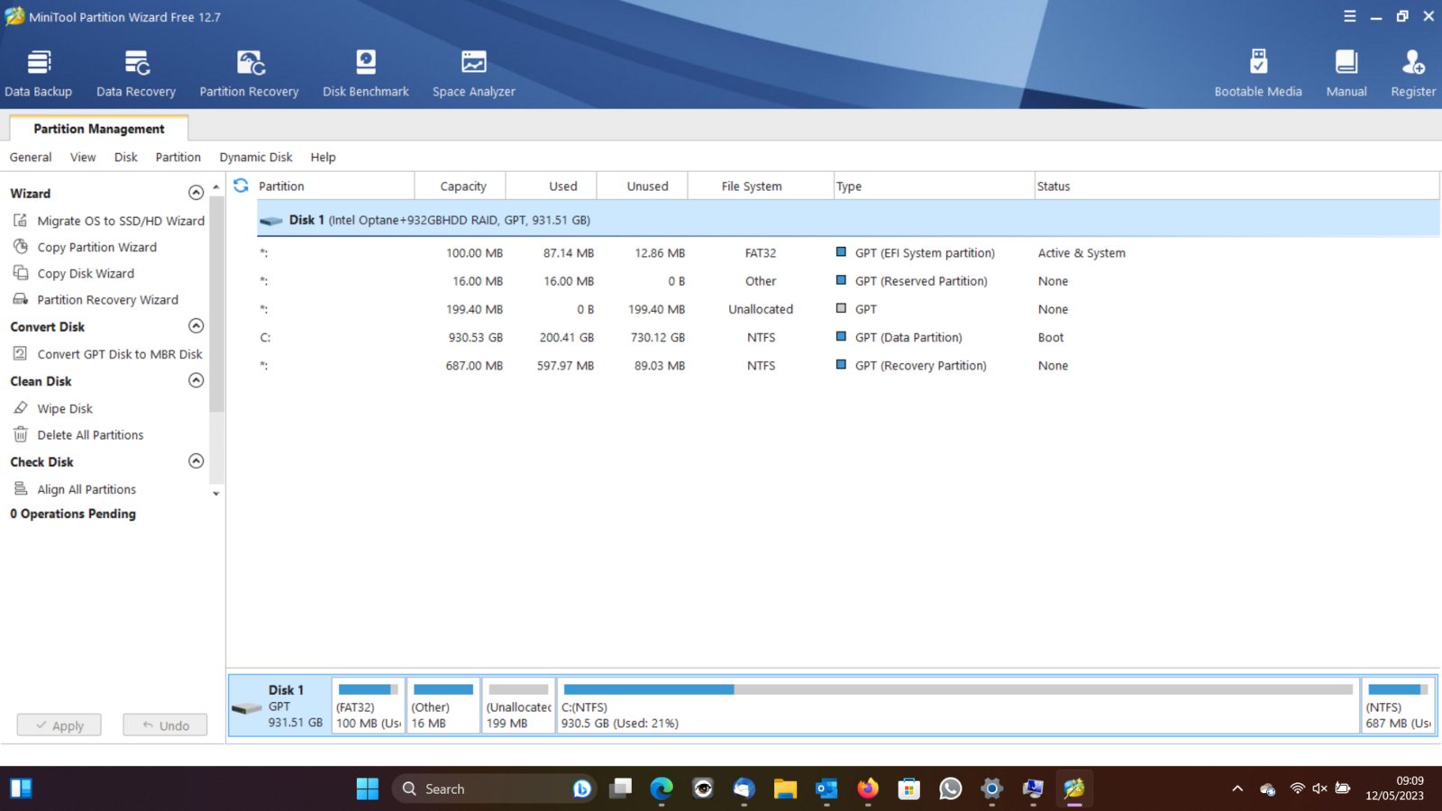

Nail, head! You were absolutely correct, the Optane drive was not enabled. It is now back to flying the way it did when I first bought the laptop - thank you very much.
Unfortunately, earlier in the evening, I ordered a large SSD drive, to swap out for the HDD. Never mind, it'll come in.
