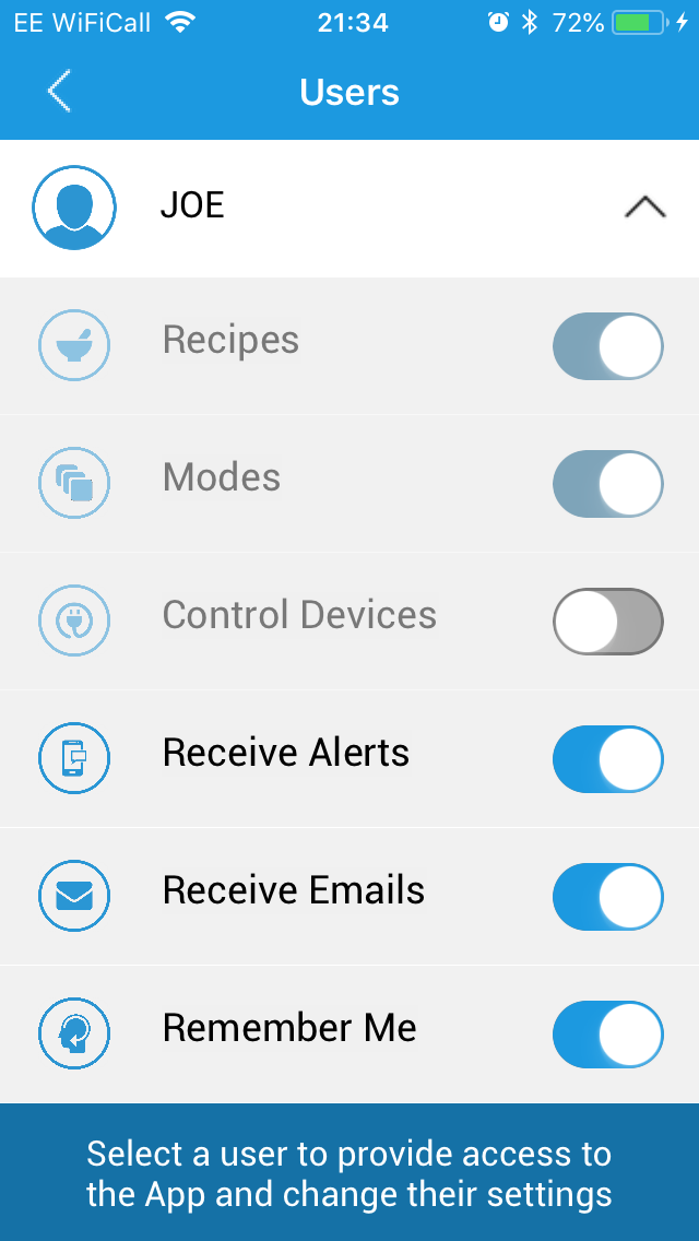

Problem is i have set up email notification easily with smartcom you just add emails and if people want notifications next to users, but theses no option to add phone number here and when i go into keypad not it say 'cannot use' in the area you used to be able to enter them, there is an option to add push notification for alarms in smartcom but no where to add number maybe im missing something simple?
aslo if there a way to change what you get notification for as at the moment it notifies me of every time a user logs on and everything would rather just get one for alarms?

Add users
add app, generates app code out it on another phone, user logs in with there panel pin??
doesn't work on phone numbers, app code gets the details for the panel, adding user allows user to log in and add email etc
Probably thinks push notifications are texts ?....
that correct, i do!

At the moment only change via the panel and turn off open and closes in udl digi options, program digi.
