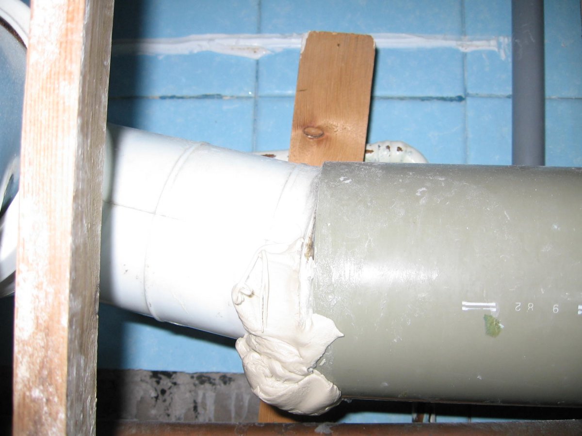

Here are 3 photos showing the connection. As you can see, I've tried to seal it with Plumbers Mait but I'd like to fix it properly. A couple of people on another forum advised me not to use a flexi connection as they weren't reliable so I'm feeling quite unsure now about what to do.

Thanks for the pics.
Its possible to pick up the soil pipe by using a some WC connectors including an Offset Connector & a Multi link - you appear to have an offset of about 20mm but this must be measured for accuracy.
It might be made easier by cutting back the soil pipe to give a little more room? Dont attempt to force anything.
Not having accurate measurements, or being there, makes it hard to give sound advice.
If you attempt to DIY it then abandon the present fitting, and clean up the spigot and the soil pipe - use only new stuff.
Flexi's are always suspect and you definitely dont have room for one.
It might be a case for getting in a plumber - as a DIY'er you could use a lot of your time, and find in 3 months or so that its leaking behind the boxing-in?
Perhaps your soil pipe connection was codged in from day one?

Thanks very much for the advice. I was already a bit dubious about whether or not I'd be able to do the job myself but after reading your post I'm thinking that I'm probably not up to it so I've decided to get a plumber in. I might be able to do it but I wouldn't want the scenario that you refer to ie. 3 months down the line find that I've got a leak and it's now all boxed in. I think, as you say, that the soil pipe might have been codged in from day one.

How much of the grey soil pipe is available? I dont see why a 90° flexi wouldnt fit, although not ideal, it may get you out of your current fix. I'd make sure it was supported though with something to prevent it sagging and pulling out the soil pipe.
Otherwise, looking at that, if there was enough space, I'd try and fit an adjustable (or very slow) bend to compensate for that angle, then slot the pan connector into the bend. If its internal and not visible then an underground bend can be used, these are available in 15° angles, if that is too much, then 0-30° adjustable bends are available.

I do wonder why some people seem to think that flexible pan connectors are the devils own creation.
Where there is an awkward fall or connection run due to a badly sited soil waste pipe, I have found a McAlpine flexi's have worked well.
Like everything it's all down to being fitted correctly without too tight a radius, with the correct level of fall and fixed squarely onto the spigot and into the soil pipe and then the toilet being fixed securely to the floor. With all that done correctly then I find they can be an excellent solution for what's sometimes an awkward problem. I have used them without any issue or call back due to leaks/blockages.
