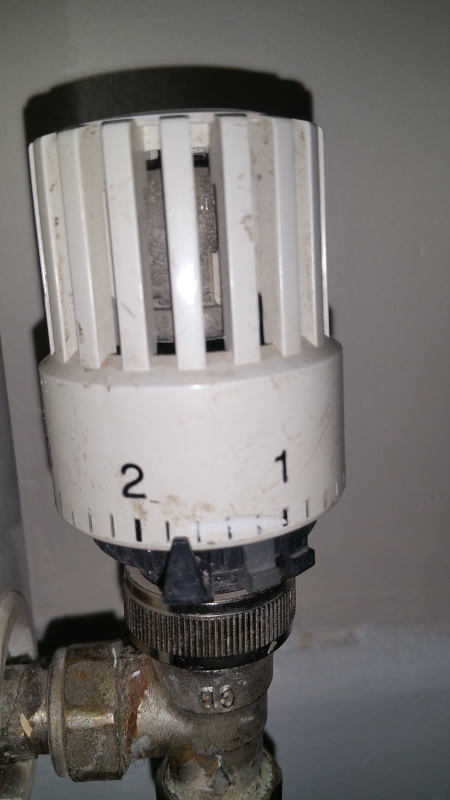

Also does anyone know what the w little switches on the trv are?
They are grey and black and can be pushed down or up.

Now what did I say earlier Ali, open up the lockshileds to half or one turn, and then balance them. If there's any crap in the system, it can block the lockshield, and not let much water through, so the pipes wouldn't get hot either. And open up the TRVs to 5.

You need all TRVs set to maximum when you try and balance them; then you turn the TRVs down to control the room temperature, otherwise the TRV setting can fight with the lockshield setting.
