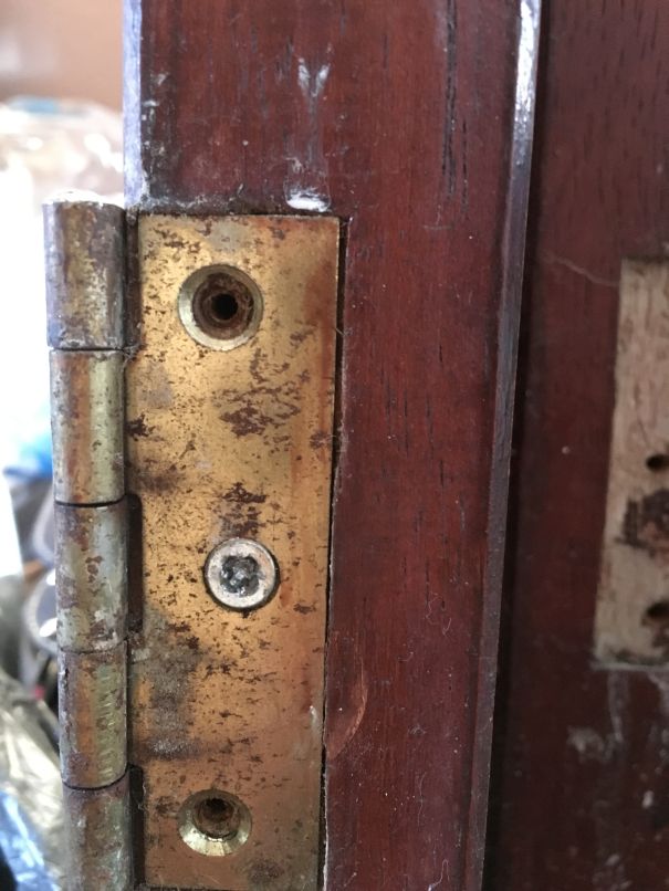

6 hinges, 3 screws per hinge. None were great but all came out ... bar this one...
I've tried putting a stack of pressure on there & going real slow with a PZ2.
I tried hammering a flathead in there.
I tried hammering a torx bit in there .... ruined both of those bits.
How to get this bugger out?
Thanks.

There is also another way? simply drill out the screw? you have several similar screws so you can choose a drill that is just slightly thinner than the screw main body size [the shank of the screw not the thread]
Do not worry about a wide drill hole, it can be enlarged later when the screw is out, and a suitable sized Dowel inserted with a wee drop of PVA glue, you can then simply insert a new screw.
With all due respect to using a screw extractor? they do work, but I must admit I find them fiddly on wood screws?
Please tell us how you get on?

I've never drilled out a screw before to be honest. Do you just get a small drill bit & do it like that or does it have to be larger than the screw itself? Type of drill bit too? Make sure it specifies metal?
We all have our own methods, Mr.C......if you can't turn the thing, forget about extracting devices, the screw shank is simply too thin.
So......if you drill the head off, the hinge will shift and the door taken away. You'll be left with a metal screw stub which you may be able to grip and turn with Mole grips. However, one of my techniques is to drill a small hole (maybe 2mm) down alongside the screw shank which will allow the screw to loosen a bit - knocking it from side to side helps. After that, tap in a match stick or two coated in PVA glue into the hole......let it set and then it's in with the new screws at your leisure.

The screw I extracted was a machine screw, achieved by using an aldi extractor set. I just used lots of pressure with my drill on a very slow speed in reverse.
I had 3 to remove, two came out using this technique. The one I tried to drill first snapped.

Ive suggested it before in another thread and will suggest it again...dremel a slot in the head and use a flat bit driver.
litl
I read on this forum that putting a fat rubber band over the screw head can help the screwdriver grip when it has been previously chewed up. Not tried this technique meself yet...
Drill the head off with a countersink bit or a large normal bit
Take the hinge off and then there will be enough screw to grip with pliers or mole grips
