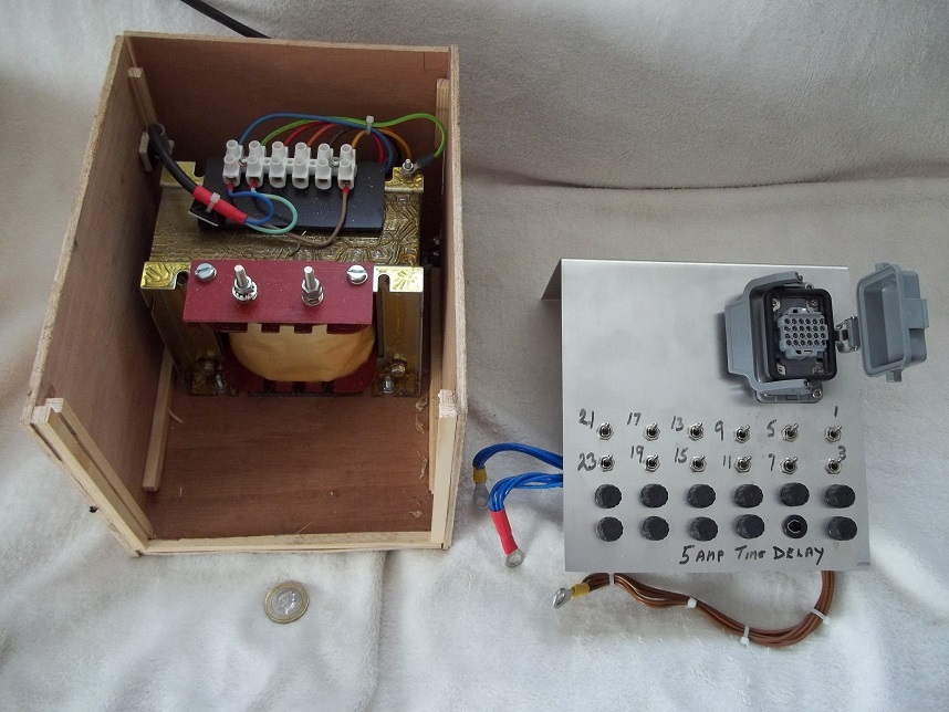

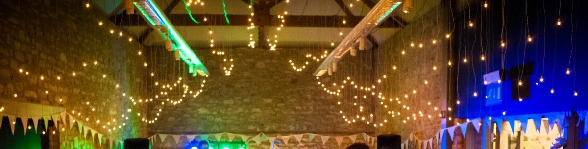

372 incandescent lamps, 12-15 volt 2 watts each. Slightly under run at 9-10 volts to get the warm orange glow. ( without the disco lights the lamps made the perfect lighting system for the event )
12 strings each with 31 lamps and 9 metres long then 6 metres to the power supply.
The transformer and fuse board to supply them. 2 pound coin for size comparison.
A single SMPS would have been smaller and much cheaper, 12 separate SMPS units would also have been cheaper but both SMPS options created problems that made the SMPS options impossible to use.
