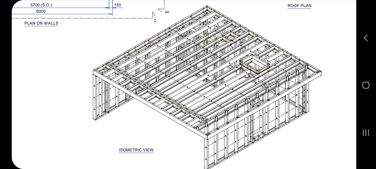

Hello! I am going to build a steel frame garden room (light guage steel) of size 6m x6m, with slimline sliding doors spanning the whole width of the front wall. There is essentially no steel on the front wall apart from where the side walls (150mm studs) come up to the doorline and past it on the left side for the 750mm overhang. I wanted to achieve that true floor to ceiling look with the sliding doors so opted to have no lintel underneath the roof joists where the sliding doors will sit. I'm now worried that this will lead to a compromise in the structure either from day 1 or some point down the road. I have attached an image of the structure I am looking to build which will hopefully make what I'm saying make sense. Any advice would be greatly appreciated!

general comments
will need planning permission and comply with building regs
no expert but expect a heavy duty rsj and matching legs on the front like a goal post to take the load and prevent racking

So do you think the way the structure is currently designed would not work? That front plate perpendicular to the roof studs over the doorline is not acting as a lintel here in your opinion?
it needs to be significantly rigid enough to support the front edge load and the racking load
in your design, half the roof load or there about will be over the front opening now timber i can work with and be reasonably confident but steel is an art i can only suggest from a position off informed but open knowledge meaning i am still learning
you need someone experienced in this actual situation to give a proper answer i am not fully confident but to be fair i tend to fully overengineer but thats in my mind so maybe correct or not correct and misguided but who can tell (n)

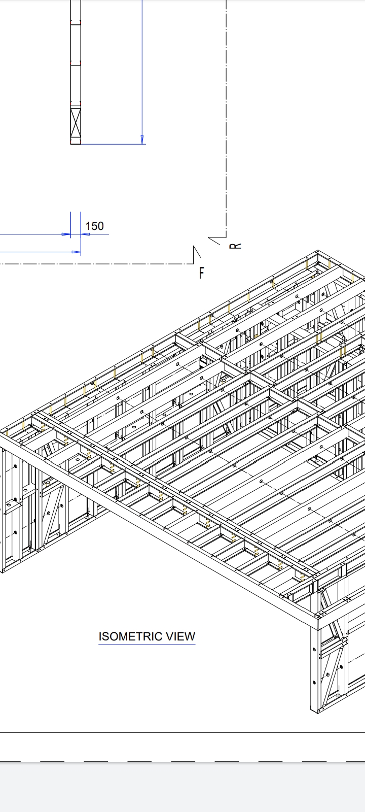

Also how would you recommend fixing a big set of aluminium sliding doors to the frame at the opening?

Before you get bogged down with vapour barriers and PIR, you need to consider the potential for serious side-sway, particularly if using light-guage steel.
Ideally, you should have a properly-designed moment frame at the front, but that might need some conventional hot-rolled sections of a larger section than you envisage. The roof plate should also be made as rigid as possible, and securely fixed to the tops of the perimeter walls.

your big problem is a structural engineer won’t want to calculate your design, so will specify beams, posts etc to pass.
