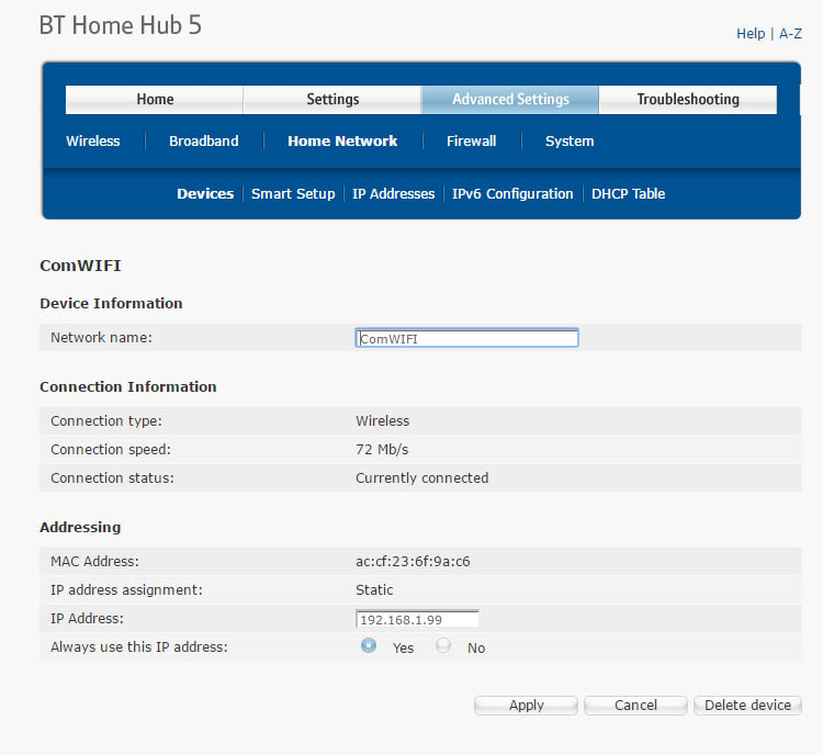

An Update:
Following a post on a BT HomeHub site where it was recommended that I triy 2 things:
1. Disabled Smart Setup - I don't know what this does?

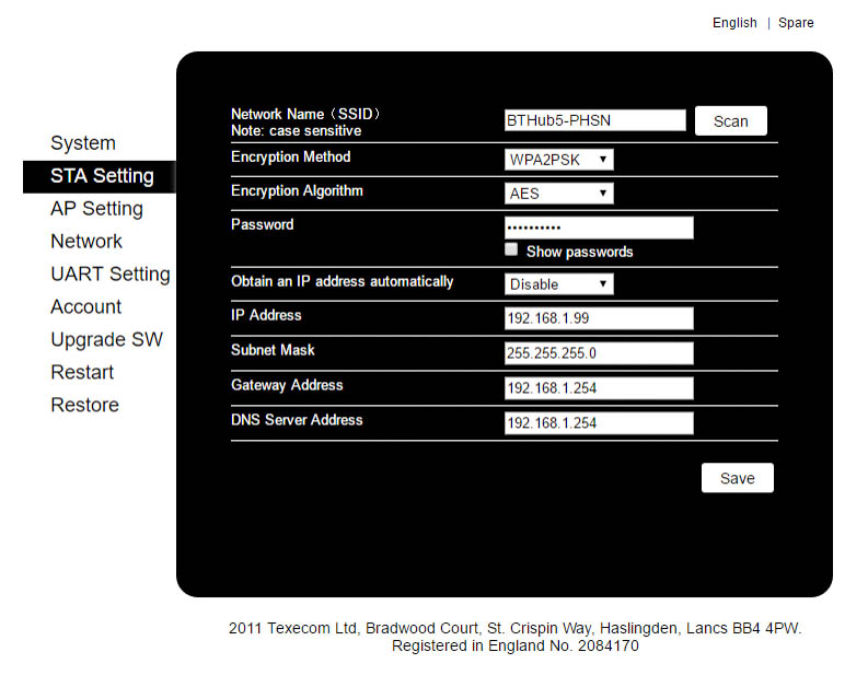

2. Choose to use an IP address outside of DHCP. I tackled this slightly differently by changing the range of DHCP so that the IP address (192.168.1.99) was now outside of the DHCP. I waited until the lease renewed and then tried the app - nothing.
I logged onto the Com-Wifi module and reset the IP address, Subnet Mask Gateway & DNS and restarted the unit. BTHomehub 5 now does NOT see the Com Wifi unit. I can still log onto it from my PC, I can ping it but cant get the hub to list it as a device.
I then changed the DHCP range to include the ComWifi and it sees it again and the app works. Very confusing.. I am now wondering if I loose connection when the lease runs out - currently set to 24 hours.
Would welcome any thoughts.

Its now looking like it is a lease problem. The lease expired last night and the ComWifi is now absent from the list of connected (or disconnected) devices. I cannot use the app to log onto the system but am still getting notifications and can still ping the ComWifi. Wintex still works. Somehow once the lease expires on the ComWifi I loose the ability to connect to the unit via the app. Can anyone explain this?
A quick & dirty bodge is to set lease expiry times to a very large number (effectively infinite). If your HomeHub features this functionality, try it, but it's only a medium term solution as you will eventually run out of ips. Forcing dynamic ip to become static only works for a bit...
Thanks for the comments Paul. The longest I can set the lease time for is 21 days. To be honest that gets me over the problem of holidays etc whereby I should be able to maintain connection (this of course assumes that the lease thing isn't a red herring.
Re the app knowing the ip address of the Comwifi - it doesn't ever change. you enable 'Obtain as ip address automatically to initially get an IP address' you set it as static on the router and then when you set up the alarm panel the enable changes to disable. I am also pursuing this on a BT Home Hub forum and the suggestion there is to set the ip address outside of DHCP range. I tried that yesterday (by changing the DHCP range so that it didnt include the ComWifi and the hub didn't see the ComWifi.....
I have posted a few screen shots:

OK - so I have now chosen an address outside of the DHCP range (so shouldn't be affected by lease times) and have changed the panel etc to reflect the new IP address. I can now see the ComWifi at new IP address on list of connected devices but (obviously) I dont see it on the DHCP Table. So now its wait and see if the app stops working........
