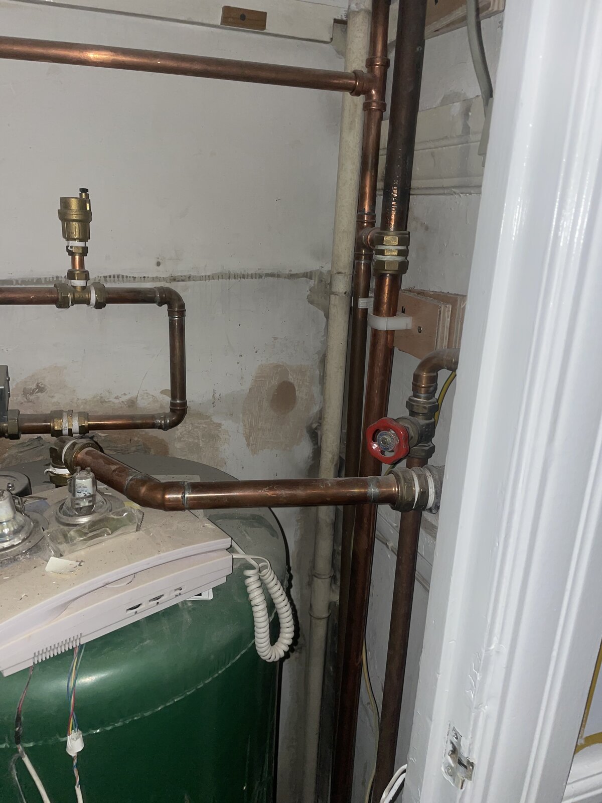

Are the cold feed to the Pump and the cold feed to the HW cylinder on two separate pipes coming from the loft tank and what size vent is on the HW cylinder?.
There are two pipes from the cold water storage - One for cold water to ST pump and one for cold water to the hot water cylinder - Both open full.
The cylinder I have is this one
https://www.gledhill.net/products/vented-cylinders/envirofoam-stainless/
It has 28mm feed from tank to the hot water cylinder and 28mm vent at top
The flange on side is 22mm -

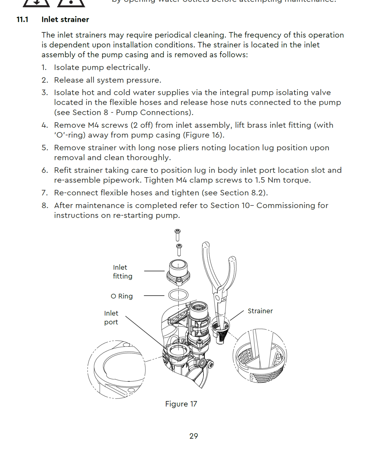

There may be filter/strainers on the pump inlets that can be cleaned.

Do you really think the strainer is blocked up - Not easy to drain down hot water and inspect the pipes!
There should certainly be some gravity flow through the hot, should be practically the same as the cold. Are there any "penny slotted" type valves where the flexible hoses are connected to the pump? You should certainly determine the reason for no flow.
There are no penny slots - There are turn knobs for isolation which have been fully opened !

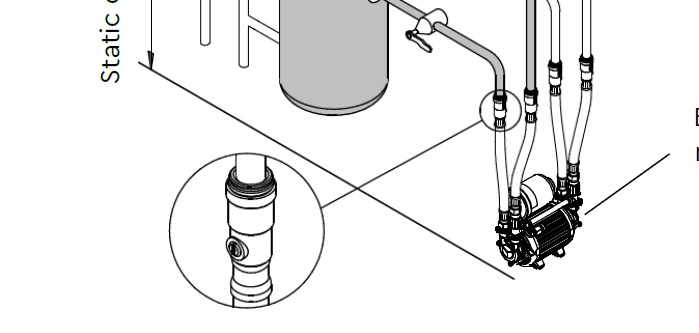

  • Stuart Turner Twin Pump Installation.pdf

Then I can only suggest, like the others above, a blocked filter on the pump hot inlet or some other restriction on the hot supply to the pump.
Whilst you've got the pump inlets undone you could open the hot and cold isolation valves and check (bucket+measuring cup) that the flow rates to the pump under gravity are roughly equal.
