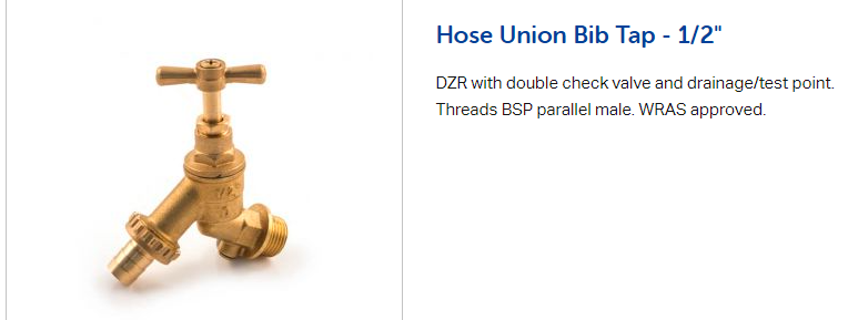

I was not actually thinking of 'single check valves' but, rather, of things like this (although I'm a little surprised that they can get everything into the small amount of space available:

Check valves are simple to fit (usually) if required. On toolstation the hose tap with check valve is 10p more expensive than the one without. For two on clearance the one with the check valve is actually cheaper.
I don't think anyone has suggested that cost, or non-simplicity of fitting, are an issue - although I would point out that I was told early in this thread that check valves incorporated into 'hose taps' were not generally 'acceptable'. However, standalone check valves are cheap enough, and easy enough to fit.
You can get a double check valve for less than a fiver. I don't think it is unreasonable to do at all, if deemed required.
