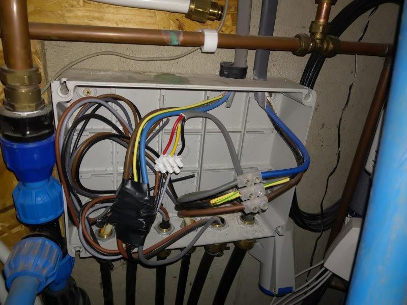

Here's the old box.

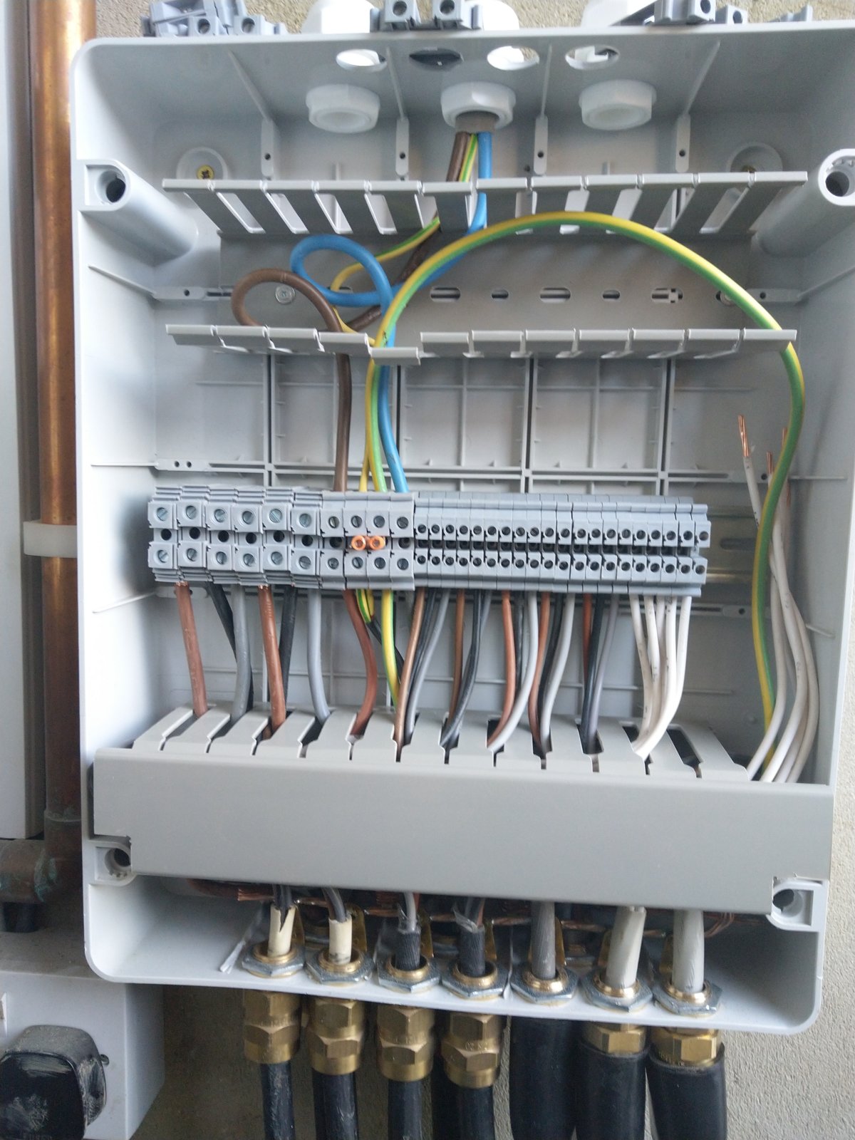

Here's my new box mounted on the other wall with one of the 16mm2 cables moved across to try the layout. I'm going to have to redo the gland because the armour has come away.
What size should the earth tag cable be? Is 2.5mm2 ok? These circuits all have RCD protection upstream, so any current in the earth cable will be for a short time presumably. I've soldered 10mm2 cable here which was a bit of a pain to bend, so I'll know for the next box(!).
I've also tried to gland another 16mm2 cable with these BW type.
https://www.cef.co.uk/catalogue/products/23128-25-m25-bw-cable-gland-pack-pack-of-2
and failed completely. I couldn't get the armour to clamp properly as I tightened the nut. Some ends of armour came out of the nut. In contrast I've had no issues with the CW type which has a ring, not just a nut. I'll try again tomorrow.
Others more knowleagable than me may be disagree but I'd say the earth on the armours should be the same size or greater than the largest conductor (so if they're all 4mm then a 4mm earth would do, if one of them is 6mm then use 6mm earth). Dunno why you're bending it- if soldering just line the tags up and fire it on. Have to say your existing box does look rather shoddy- its good that there's spare on the SWA but the 'electrician' could have made it neater

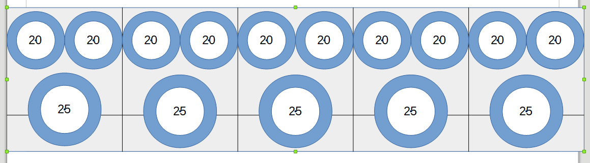

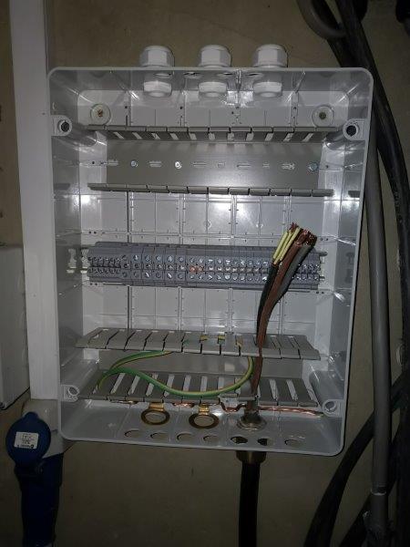

Progress so far. I did test the spacing with a piece of card before drilling the box, and I can just get the spanner on and rotate the nut. But yes it is tight, and I hadn't allowed for the thickness of 2 dust covers next to each other.
I made a template in Draw, printed it out, pritt-stuck it to the box and then used a step drill to make the holes. The paper and glue then washed off under the hot tap. Accurate and worked a treat, and the next box will be much quicker.
Once I'd improved my accuracy with cutting the armour strands to the same length, then everything went much smoother!
