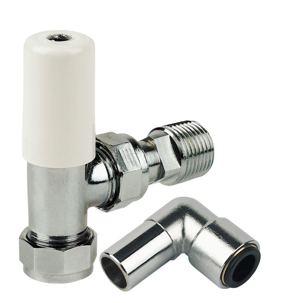

I wonder if you could get away with using something like this;
ae235
http://www.screwfix.com/p/terrier-push-fit-lockshield-radiator-valve-10mm/92200 and http://www.screwfix.com/p/pegler-terrier-ii-white-chrome-trv-elbow-10mm-angled/88878
The push fit fixing might give you an extra bit of length
