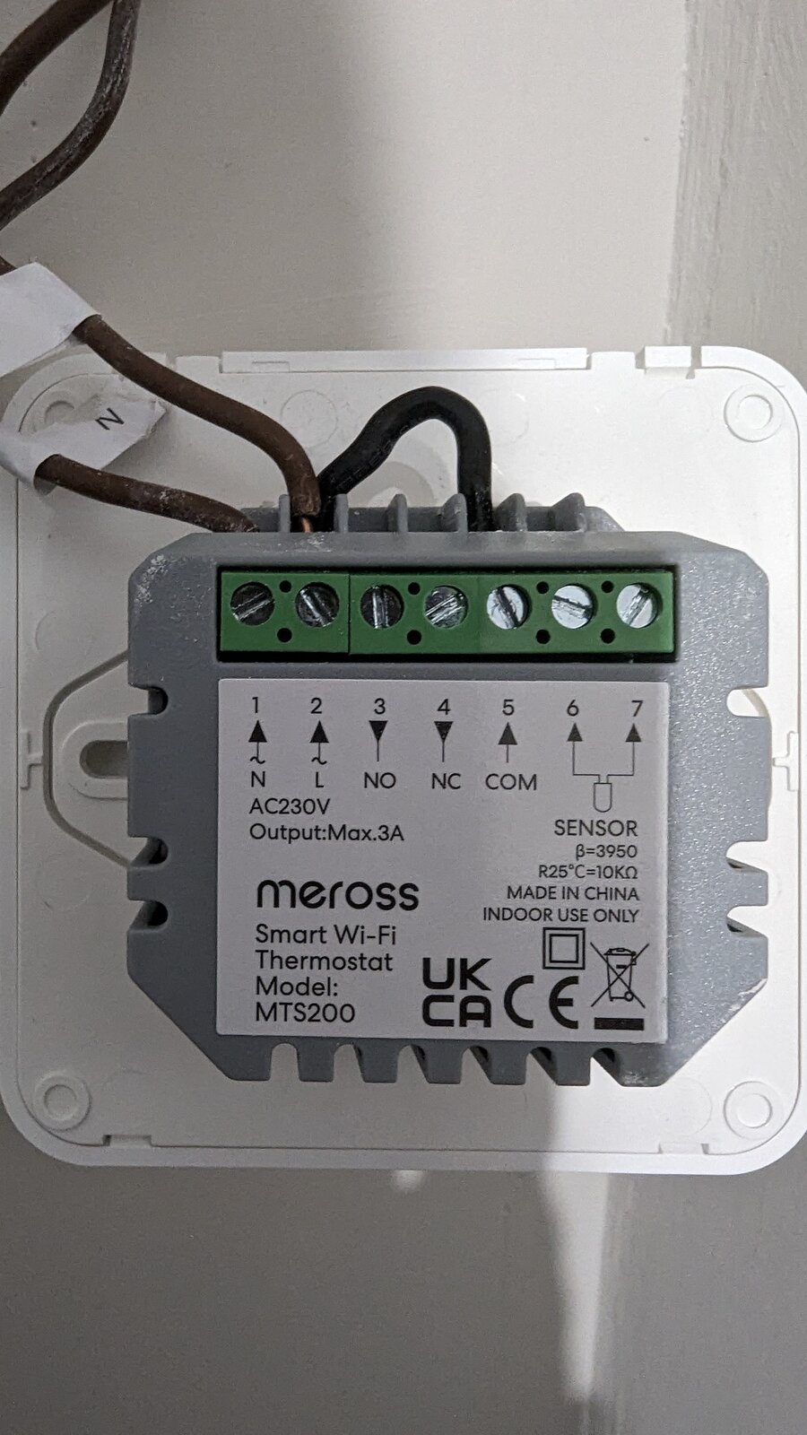

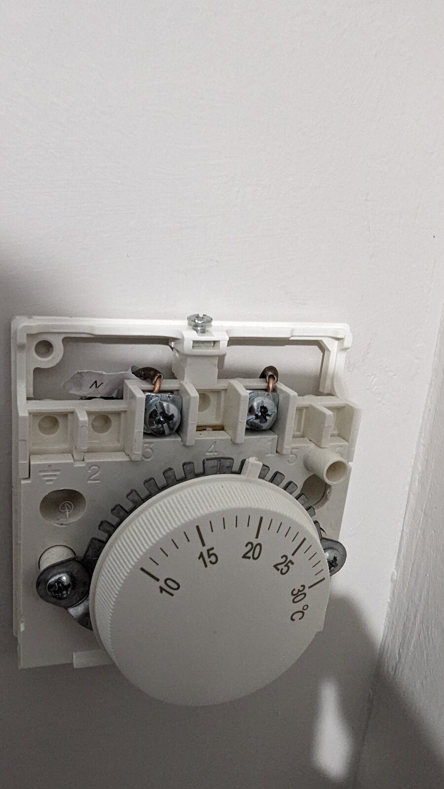

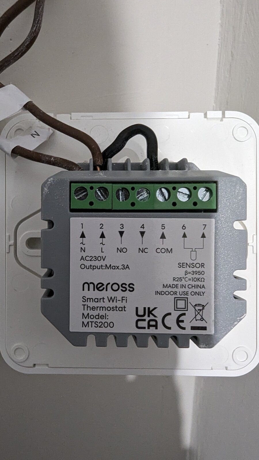

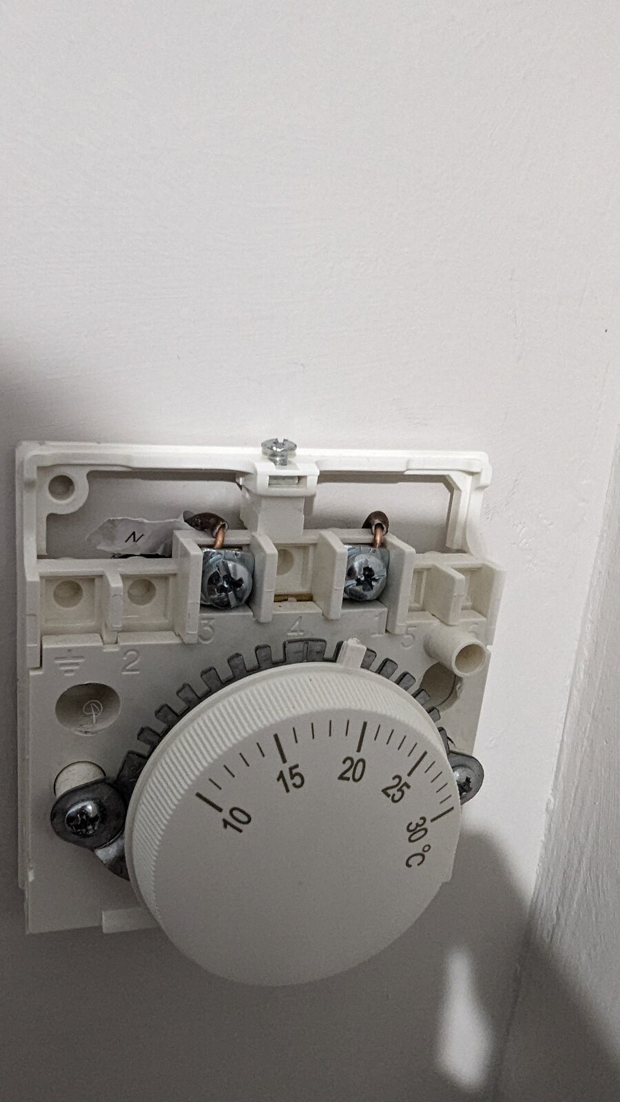

Hi guys, I want to replace my 2-wires mechanical thermostat with Meross MTS 200.
On the picture of mechanical one, the left wire is N, right one is L.
I tried to connect wires to Meross as on picture, thermostat displays data, and I hear "click" sound when it wanted to turn on the heating, but the radiators remains cold. What I did wrong? Any advise will be appreciated.

Ops, in this case I need to return the Meross to Amazon maybe. Thanks!
However I've found the yellow wire not connected to anything. I guess it won't help in my case?
Colours usually mean feck all in a heating system, so if it’s traceable and can be connected to Neutral at both ends, you might be able to get it to work.
