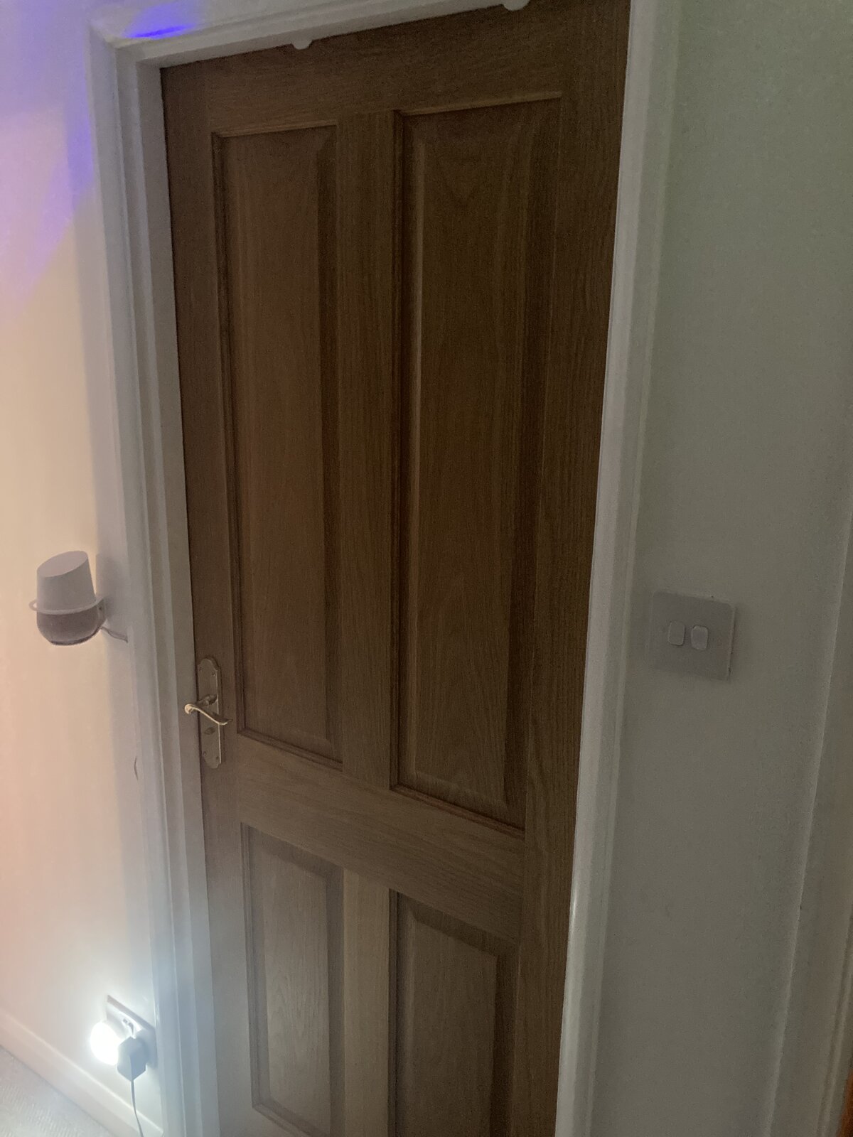

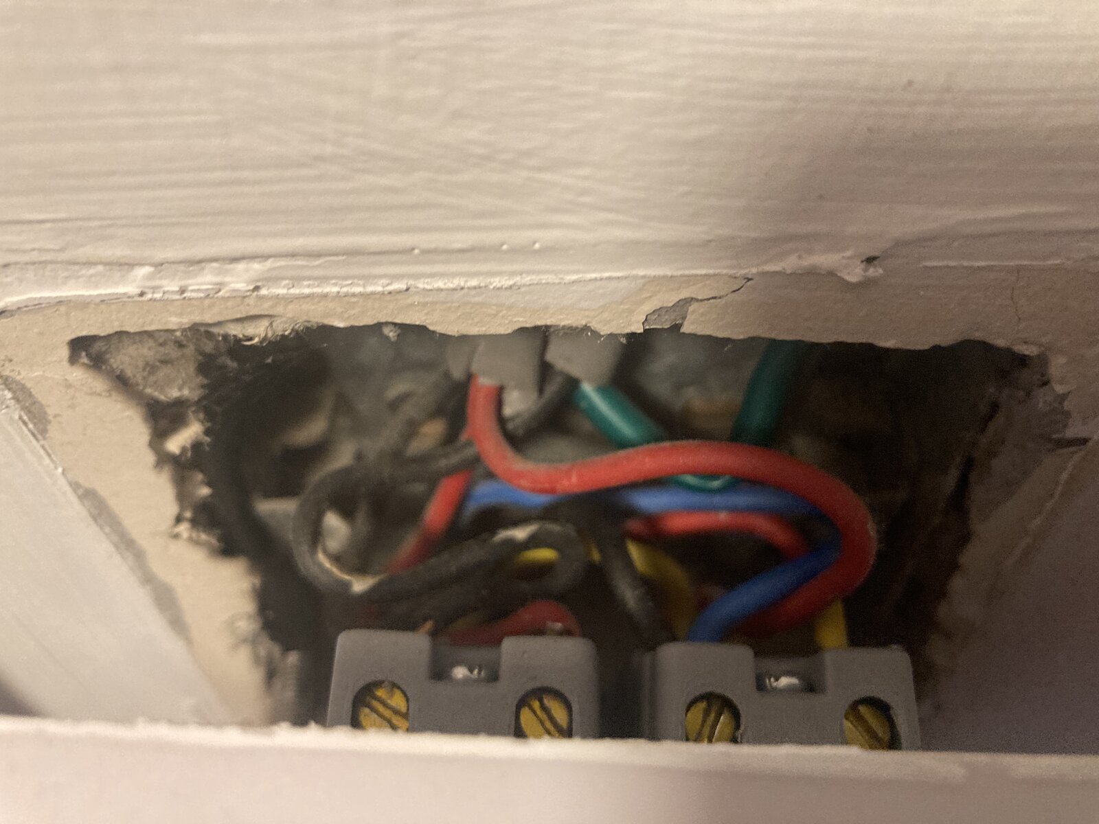

This is what I have currently. Two gang light switch controlling shower room ceiling light and hallway- door is the shower room.

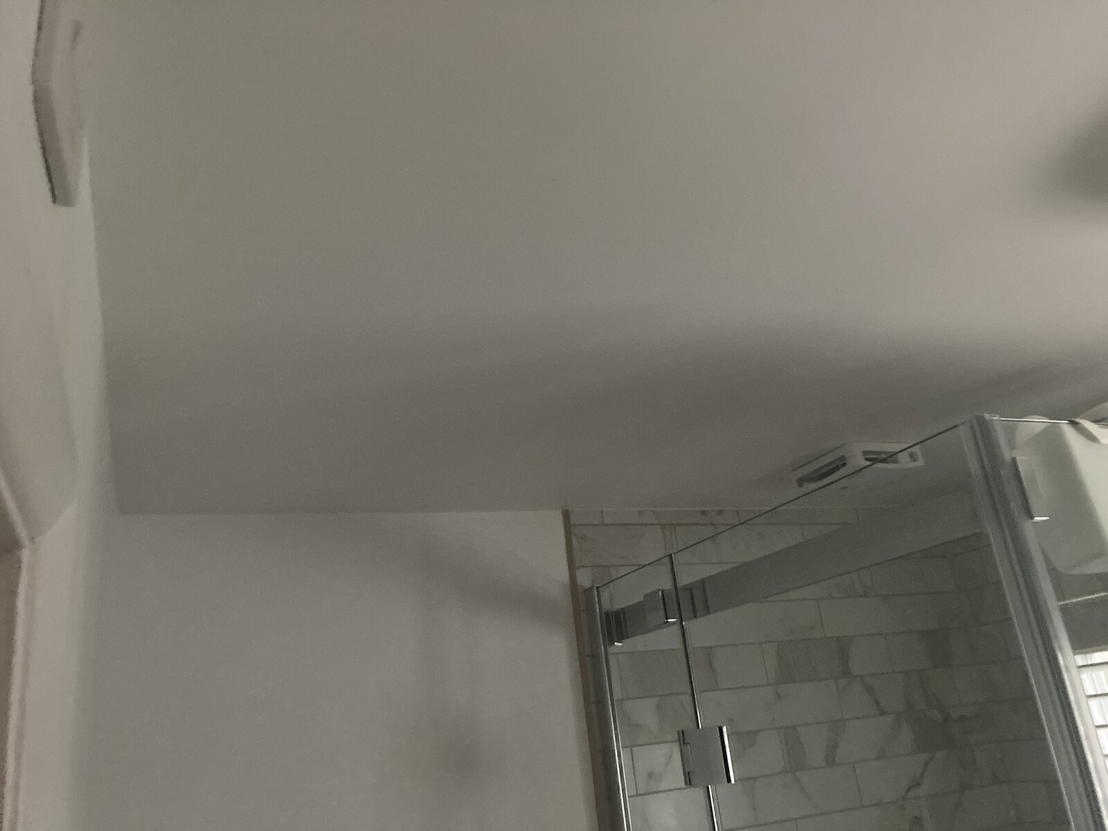

Isolator switch in shower room above door (this is more than 60cm away from cubicle), and fan directly above shower (over 225cm from floor level. It is a 240v one).

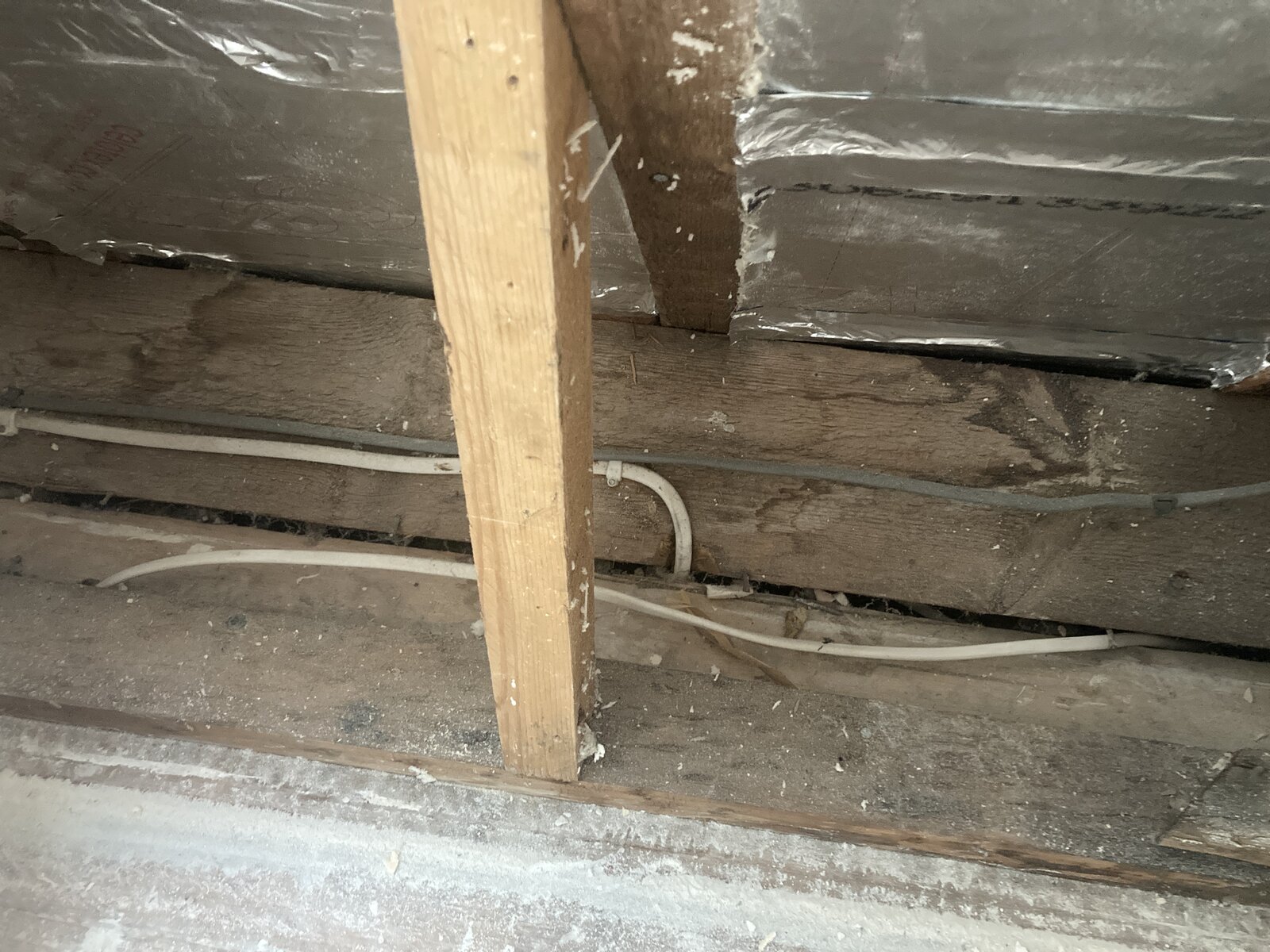

The last photo shows cables running directly above, which is a loft room currently being redecorated so can easily access. The white cable is the foreground will be running to the isolator switch (the hole where this goes down, is directly above the switch. Not sure where this will likely be running from where it disappears out of view to the right?) and I can just about see the cable going to the extractor fan- this is all twin and earth cable.
Happy to call an electrician if I need to but equally if something is easily do-able I would like to tackle it myself :)

Taking on board all the above advice (or trying to), if I leave the permanent live wiring in place but then run switched live cabling from the ceiling rose, to isolator switch (it's a three pole one, with LI and L2 in and out), then run triple and earth to the fan?
Yes, but if you are able to do that then why not replace the rose to isolator cable with 3c+E as well?
