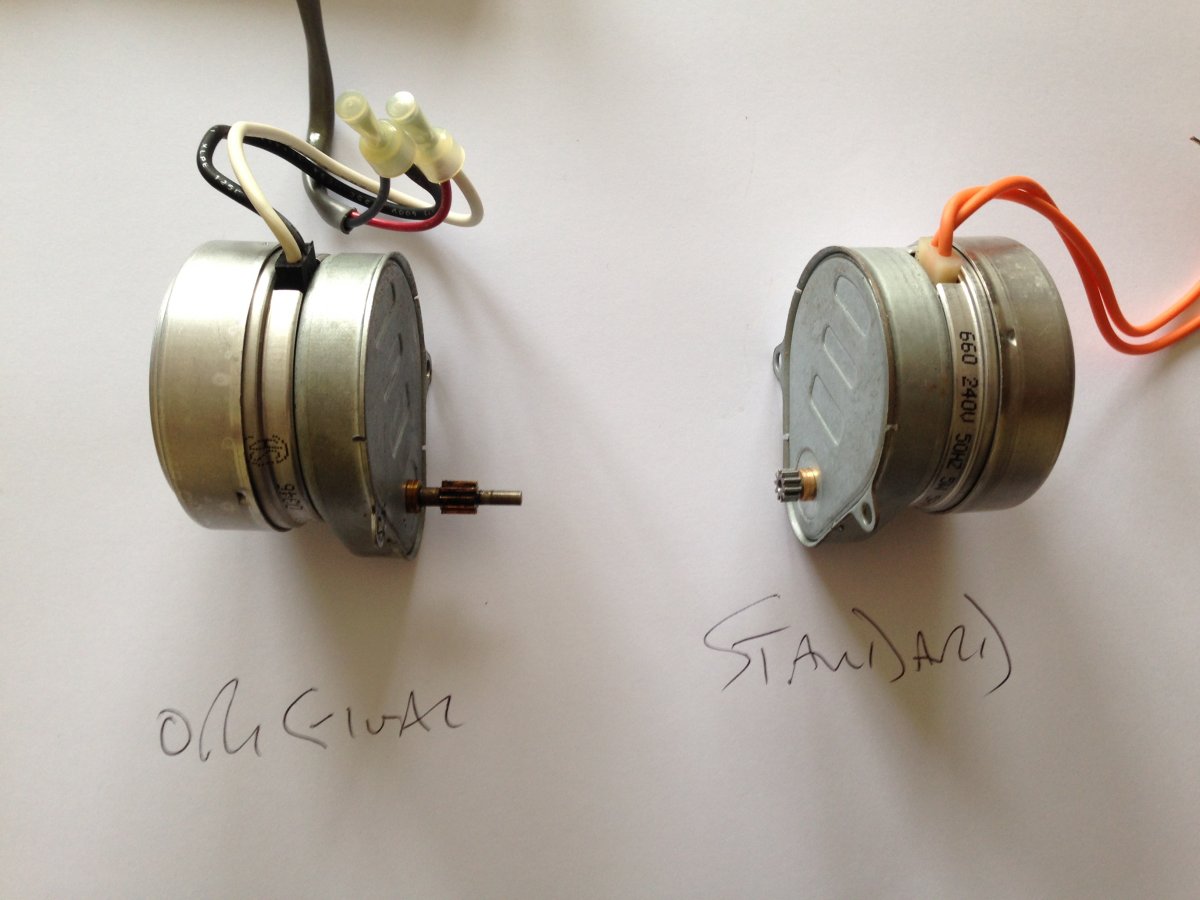

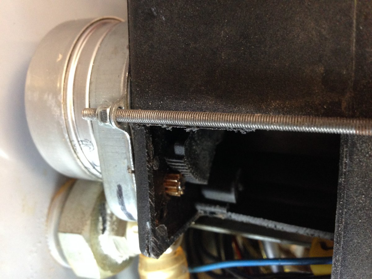

I have a problem with a MAN gas boiler, it has a actuator (driving the divertor valve) that uses a synchron motor.
This motor has the same body as a standard Honeywell etc replacement motor but the complication is that the output gear on this motor is about two to three mm further away from the casing than a standard motor and it also rotates in the opposite direction.
I can accommodate the directional problem (using the standard motor) by fitting the motor on the outside of the actuator casing (effectively upside down) but when fitted this way the teeth don't fully line up.
The question is does anybody know of a motor that has the output gear sat further away from the motor body than the standard replacement motor?
Thanks.
Paul

As I said in the opening thread I have the actuator working in its modified mode but the motor gear teeth are half meshed with the mating part and I don't know how long it will last, hence the need for an extended synchron motor shaft.
Paul

The original motor and a standard replacement motor are identical apart from shaft length (as photo)
Original manufacture number "660F 230V 50HZ 5W 5RPM 38903R-6-121-130 0346"
Replacement motor "660 240v 50HZ 5W 5RPM 38526L-5-6-130 1113
The difference is minimal, a longer shaft and right hand rotation.
The photo shows a standard replacement motor installed but not fully meshed
The extra length of shaft beyond the gear is not required as it only shows the position externally that the actuator is in.
The Chinese can supply, minimum order required 5000 so it's a case of finding something I can get to work.
My reasoning is that if I can effect a "safe" repair then it's more money in the inheritance pot
Paul
