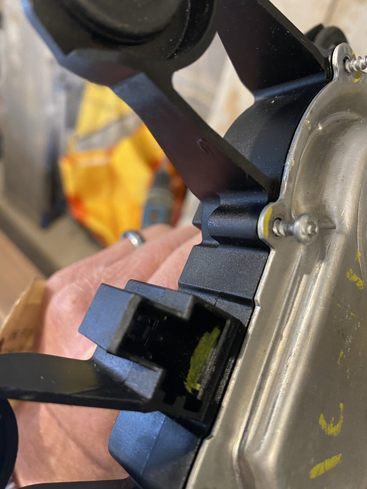

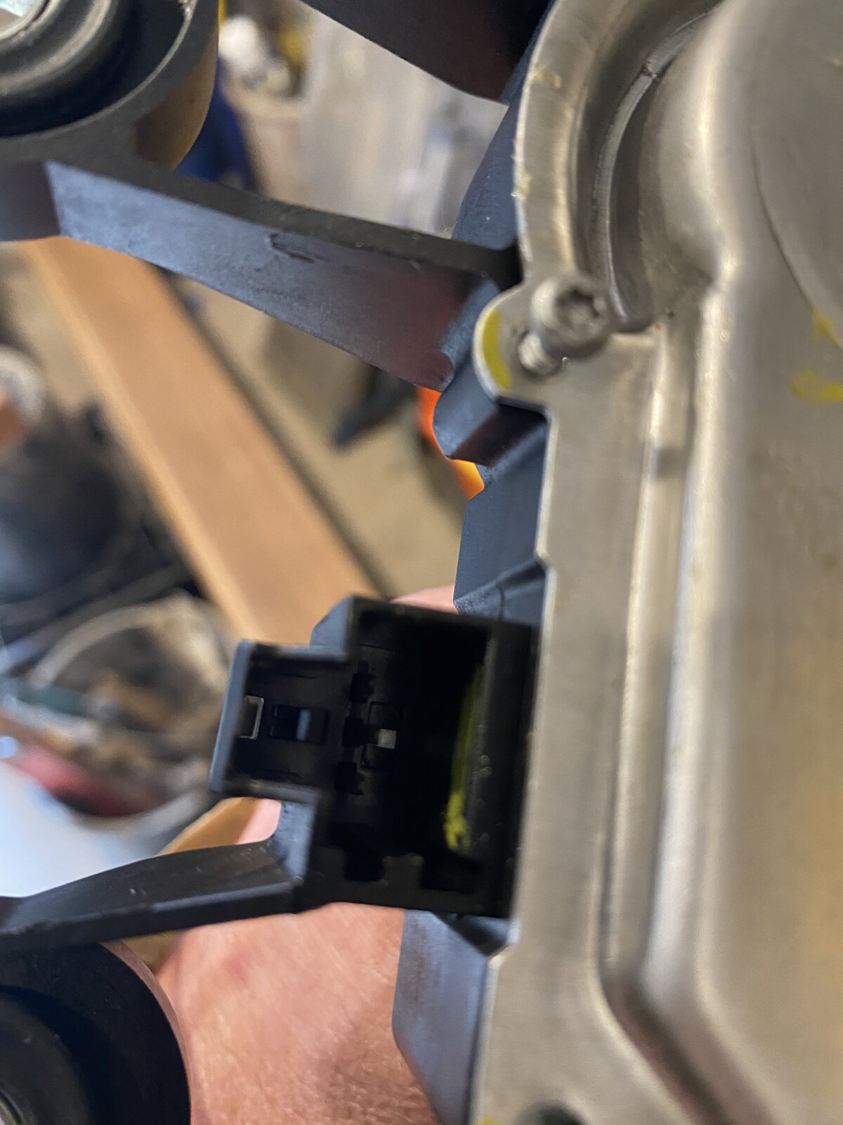

Got a rear wiper motor I’m working on and want to plug it in on my bench to a 12v supply as it’s a faff doing it in the car (and it’s cold)
It’s got a male connector with no flex, and I won’t be able to connect croc clips to it easily without shorting the connections as the pins are close together - am I missing some clever way of doing this or am I best just cutting the wires on the car side, using the female socket and re-crimping them later?
Cheers
Not quite sure of the connectors but perhaps a couple of small screwdrivers to act as probes to touch the connectors with the leads of the battery you're using clip onto the screwdrivers shanks?
Got a picture of the motor's terminals?

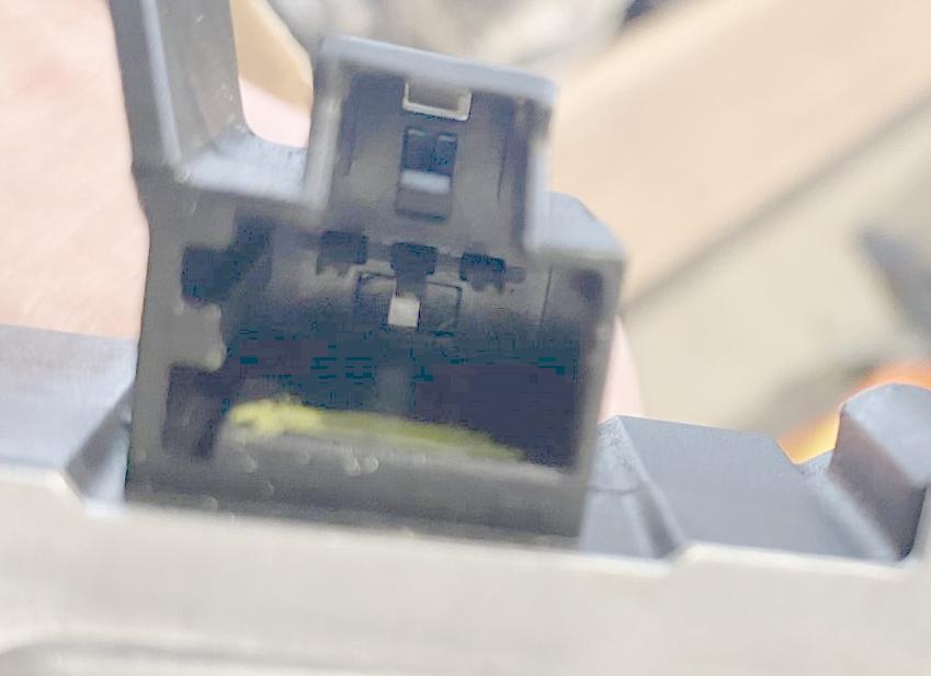

You can just about make out the connector (3 pins inside the black housing) in the pics.
Trouble is, I want a persistent connection to it while I’m working on it (croc clips kinda thing) rather than occasionally touching a probe to it

One answer is to go to a local breakers and snip the plug off if there's one in stock.
Can't quite make it out but if its spade connectors, make a little harness to your own design.

That’s a good shout re. Spade connectors, although I think these are smaller, more like pins. I’ll check though as I’ve got a load of female spade connectors. Tbh, it’s no biggie for me to just snip off the harness on the car side, and crimp it back on when I’m done. Wish these were standard but it seems every one is different :)
If you cut the wires to get the plug off the car, I'd suggest soldering and shrink wrap when you reattach.
Cut some insulation (i.e. plastic tube) from a suitable sized cable that will fit over the male connectors and will hold the back probe pins in place.
If you don't have any back probe pins, use needles (or solid core domestic wire) to which you can attach crocodile clips.
As above but perhaps strip and solder tails on the wire ends then use the insulation to hold the tinned tails on to the terminals. Needless to day, care when pushing them on so none of the contacts snap off.
