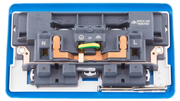

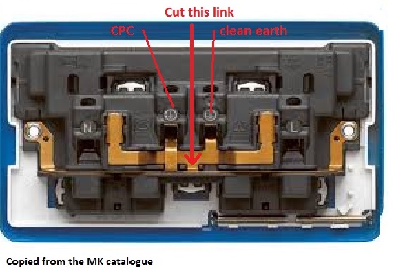

There is often confusion between a "high integrity earth" and a "clean earth".
High integrity earthing involves one or more alternative earth cables from sockets to the main Earth terminal at the consumer unit. The earths in sockets connect to this earthing system,
Clean earthing involves two separate earthing systems. The cable and metallic fittings ( back boxes etc ) are protected by the standard earthing system of a conductor in the cables. The earths in the sockets connect to a separate earth system which is grounded to a clean ( free of electrical noise ) earth. Often a ground rod or rods.
The link is cut if a clean earth to sockets is required with a separate CPC earthing to the fixing screws and ( in this socket ) the metallic front plate
The terminals with the half circle are for a clean earth that protects the equipment plugged into the socket. A clean earth is NOT the CPC and should NOT be connected to it. A clean earth uses a separate wire which connects to a local Ground and as such is not affected by electrical noise that is present on the CPC
Where there is no provision or need for a clean earth then the two earth terminals must be linked so that the CPC is connected to both the Clean Earth terminal and the CPC earth terminal in the socket.
Clean earths are used for sensitive equipment and for communication equipment where the case / frame of a machine must be at true ground potential to avoid potential differences along communication cables that connect the frame of one system to the frame of another system at a remote location.
