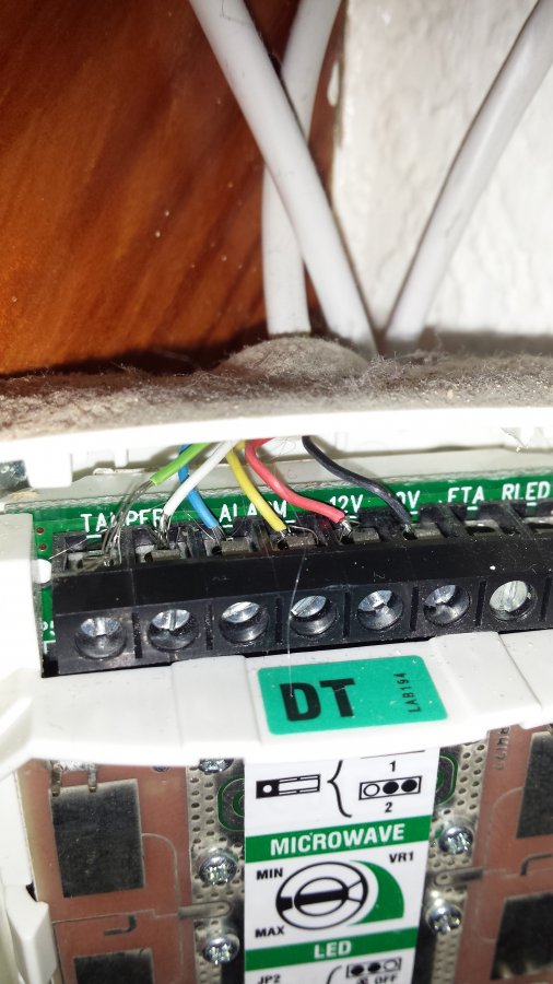

PIR on stairs is a Texecom Quad
Excuse the cabling I hadnt terminated it all at that point it was all just in place for reference.
I need help wiring the RKP tamper, Do I wire that also into the T & R terminals on the panel then link it into T & R in the keypads ?

how many wires from your door contact to zone 1 on the keypad (Mapped to zone 2) zone 2 not in use on the panel?
But does the dt have built in resistors ? Can't see from that photo , set of jumpers below the microwave sensor ...
Right Ive got zone 1 on keypad mapped to zone 2 on Panel and Upstairs RKP has zone 1 mapped to Zone 3 on panel which I have set as guard.
As for door contact I have 4 wires, Ive used Black/Red for A and Blue/White for T... Chime isnt working at all so im wondering if the contact is actually working.
No idea about resistors in the PIR, There are Jumpers for the Microwave etc...
