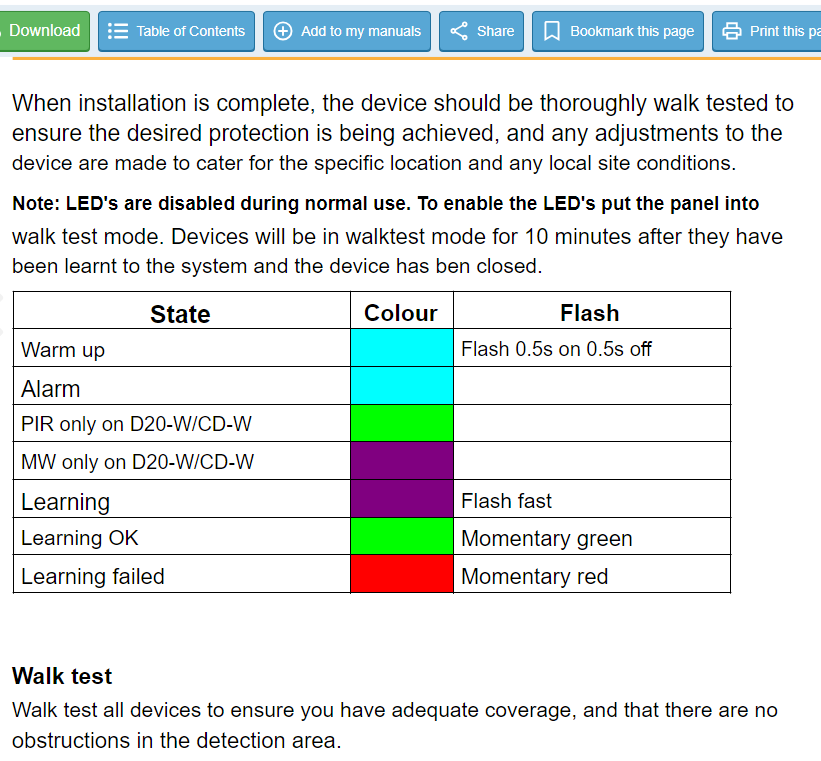

Hi;
I'm having a few issues with this brand new device.
It has been learned on zone 25 .
I can trigger the pir and the blue light comes on and then goes off after say 10 seconds.
If I take the pir to the final destination i.e. garage and fix it , when I add back the cover I get a pink light and green which should mean its connected.
When I try to activate the sensor in the garage , sometimes I get a solid blue light and the blue light does not go off . I take it down to investigate and start again and sometimes I get no blue light at all. What do these two behaviours mean ?
I cannot find this detail in the texecom manuals.
How can I tell that a pir may be out of range or not connected to the system once in position? I assume red going by the manual https://www.manualslib.com/manual/2125200/Texecom-Capture-P15-W.html?page=24#manual
regards
Tom

Wireless PIRs only come on when in walk test. You can do a walk test from engineering or from master user code.
Walking past the sensor when it isnt in walk test mode, will activate the device but not illuminate the LEDs
When looking for the ricochet network it may come on a certain colour.
This is in the manual please see the colour codes below, as previously explained wireless sensors do not illuminate unless in walk test mode.
If you have a any LEDs on outside of walk test and after the initial learn sequence is finished then there is an issue.

if it’s working properly now sounds like it hadn’t settled down after learning ie out of walk test, didnt know it goes into walk test for 10 minutes after learning on might check that one day. We always do a walk test after commissioning mode is completed and we do that twice. Reason we do the commissioning mode twice as we have seen signal security improvements according to ricochet monitor completing the process twice over just once.
This info from support may save others the pain I had , in the future
The PIR indicator will pulse blue for approx 1 minute after learning on, then when it's fitted into the backplate will stay on for approx 10 minutes, following that the only time it will illuminate again is during a walk test, in normal operation the indicator will not come on, this is to reduce battery consumption.
When arming the alarm the PIR's locations should be clear of movement otherwise you will get zone active messages, this is normal, once the system has armed any zones with a P15-W will not trigger the alarm for approx 4 minutes, this is because the detectors are put into a sleep mode.
The wireless devices need to be commissioned after they have been learnt on, this is done in order to build a mesh network between all devices in case the main communication path is blocked they can signal through each other back to the expander (receiver), if this process has not been carried out then the operation may not be reliable, Texecom is the only system on the market that meshes the detectors, the process is patented.
To mesh the network depends on the system, if you have a standalone Ricochet expander simply remove the cover (keep the control panel in the engineers menu) and leave it for approx 30 minutes, this starts the process, then secure the cover back into place.

So on the Elite PIRs behave differently to the Capture which is to be expected.
Elite PIRs learn and flash and need to be placed into walk test to activate and light up after learning on.
Capture after learning on goes through the warm up cycle and then is ready for activation, flashing blue light during warm up once flashing stops its ready for activation.
The blue light on the Capture however does not stay on for 10 minutes, however it does appear to stay in walk test mode (10 minutes or so)
It activates every time then restores shortly afterwards, then the light can be reactivated after that it doesn't illuminate unless in walk test mode.
