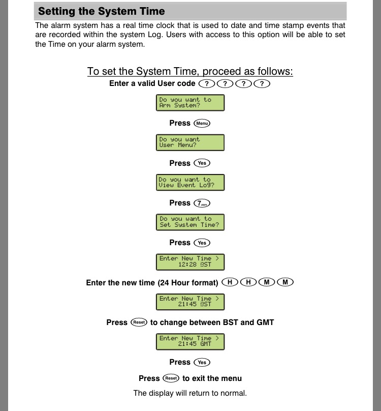

To set time enter code & press menu follow on screen menu to navigate to set time.
At least for me, "menu" doesn't do anything, doesn't give me a set of menus to navigate. Looking at the user and installation instructions I think it's likely I need the engineer code for that.

See attached. Instead of the menu button you can scroll down until you see the user menu option. Might sound like a silly question but are you using a valid code? If you tried defaulting the panel codes then it may now be 5678
