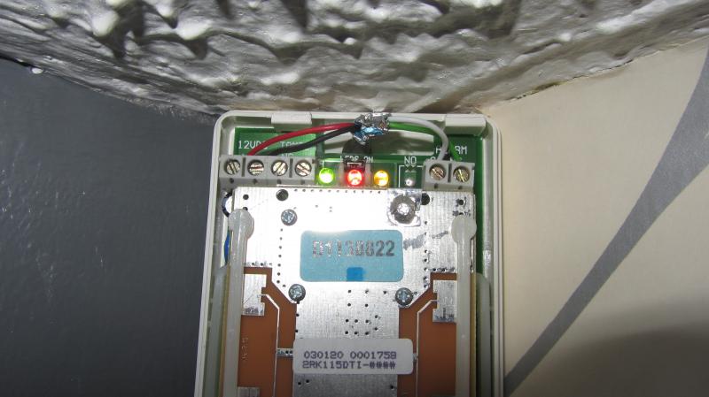

This is the 1st PIR on zone 1. The entry/Exit route.

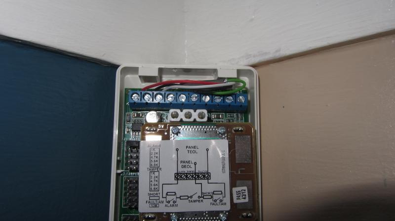

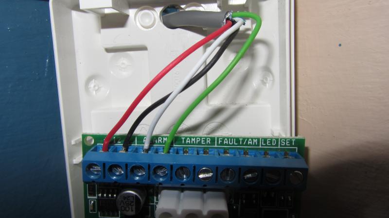

These are the images of the second PIR in the lounge on zone 2

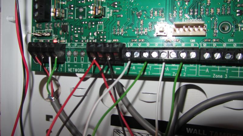

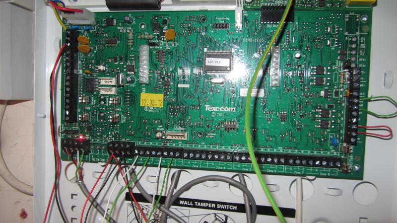

This is the panel and how I think it should be wired.
I'm open to complete and utter constructive criticism so don't hold back.

PIR End is ok but at the panel, the alarm circuit (green & white) should be connected to the terminals marked A. The Green you have connected to the tamper terminal therefore your loop isn't complete.
Move the green to the terminal to the left and put a link between the two terminals marked T
Hope that helps
nope all wrong what are you wanting to do ? 4 wire no tamper or eol wiring ? as it is at moment you need to either fit resistors or lose the tampers, if you want to lose the tampers wire into the first two connectors on the zone ( alarm ) and link out the tamper zones also you have a jumper on the detector set a 1k remove it. to be honest if your having problems wiring this you are going to struggle programming it.
Im not too bothered about tamper. Ok so i will remove the green from the T side of the zone and stick them in the right terminal on the A side of the zones then Link the T's together?
I have now removed the jumper.

What sort of cable is it? It doesn't look like alarm cable. Its shielded but the shield isn't connected to anything. Its huge!
The holes in the back if the PIRs where the cables enter want sealing with silicone.
Label the cables in the panel so that you can identify them in 6 months time if something goes wrong.
If you twist the wires together in pairs they will be easier to identify and route neatly within the panel.
Use resistors and wire it EOL to use the tamper. Do it now, not later, much easier to do it once correctly than change it later.
The holes in the back of the panel where the cables enter should have rubber grommets in them.
Those loops of cable on the right are about twice as long as they need to be (just me being picky ;) )
