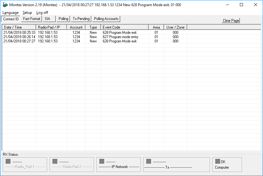

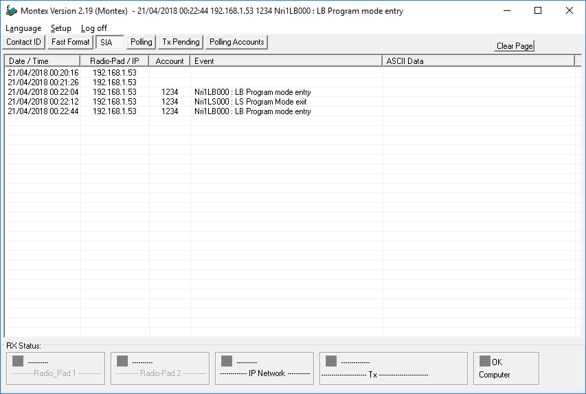

okay I have set up
This panel isn't as old as yours but setup and working, installed montex and texbase from scratch and it automarically setup the BDE, downloaded from Texecom so this is the latest version
changing it to contact id.
