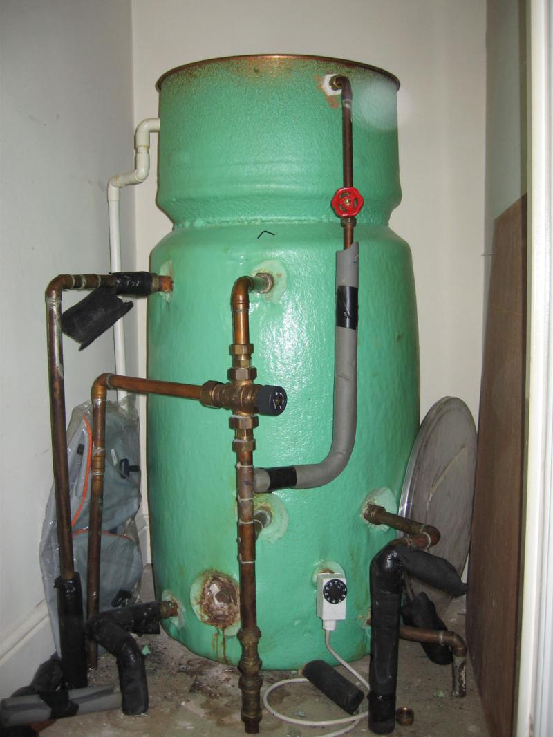

I think i have a faulty cylinder, so i have 2 options
1) replace cylinder with 'like' for 'like' replacement.
2) because the cylinder and boiler are over 10 years, replace both and put a combi bolier? (save cylinder space).

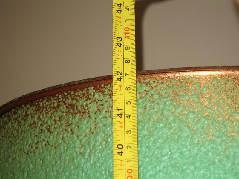

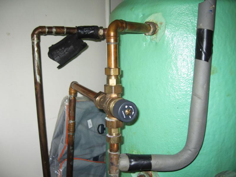

The only problem i have is identifying my cylinder, i have spoke to albion's technical :D , and sales who have given me different part number. I have attached a few photos, can anybody recommend what this cylinder is a replacement?.
Many thanks
Nick

If you isolated the cold water into the cylinder (left of cable on floor), does the cylinder overflow?
Keep it simple. Do not jump in feet first.

Thanks for the quick response, really appreciate it. I will try isolating the cold water tonight.
Agile i have just looked at the megflow, there are various different types of cylinders, do i need to know the spec of mine so that i can get a cost for a 'like' for 'like' replacement?. At least these have a 25 year cylinder gaurantee. when i asked about the albion, i was told 10 years is about correct :eek: :eek: .
