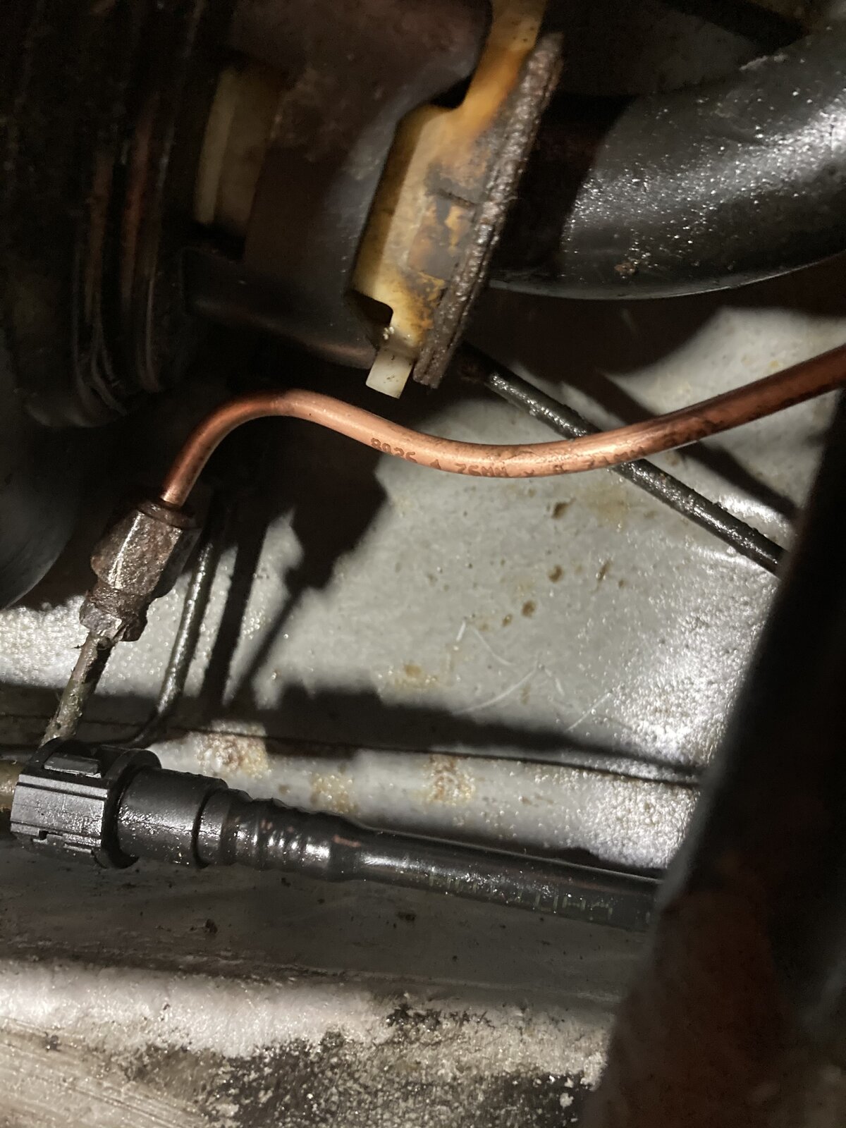

I took my mates car down for an MOT for him today. The testing station will do me no favours (well, not many:whistle:), but they know me and won’t have me over. The car passed, with no problems - brakes fine, efficiency fine. They printed the ticket out and literally on my way out of the station, the brake pedal didn’t quite feel right. When I got onto the road I checked them again and there was definitely some pedal creep. Took it back to my workshop, pressed the brake hard and it dropped quicker. Looked underneath - brake fluid ****ing out at the rear! Jacked it up and checked and the pipe that went over the rear axle beam (impossible to see) had corroded and was leaking. I can only assume that during the brake test, the pipes saw pressure that they hadn’t seen since the last brake test. Luckily it was a section that went from the fuel tank area to the o/s/r flexi hose. When I undid the pipe at both ends and pulled it out, it came out in three pieces! Luckily I had some copper pipe and a flaring tool so I could make one up using the old nuts but this is exactly why the mot is valid only at the time of the test and does not guarantee anything.
