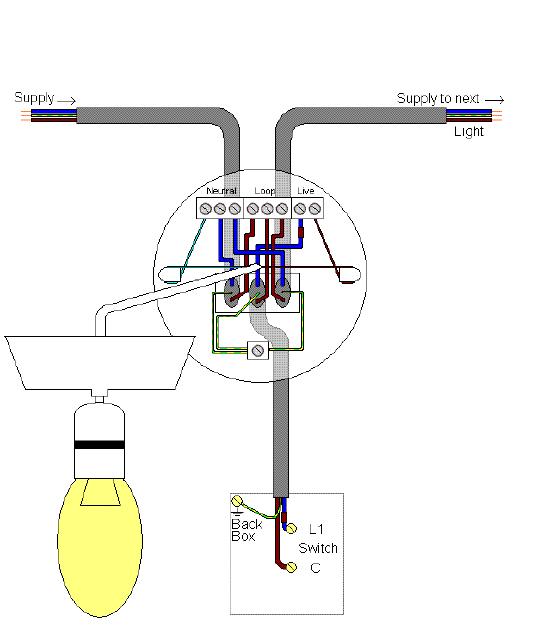

We also tend to loop at the switch especially on new builds before the dot and dabbers come in.
On re-wires we tend to loop at the rose.
quite a few customer now ask for just one tail drop for ease of fitting modern light fittings.
We also tend to only fit 25mm boxes to accommodate modern switches.
I have not purchased or fitted 16mm ones for ages.
I've owned 2 properties built in the 90's, and they both loop at the switch. I think its a lot easier to work with, probably because I fitted spotlights in most places!

As to where to daisy chain from using the switch box means longer cables and no permanent line to charge the batteries on any emergency lamps. There are times when one has to do something non standard but unless there is no option the idea of having a supply non switched at the ceiling rose makes sense.

My house was built in 1988/89 and the ground floor lighting is looped at switch, upstairs looped at light. Any comments on that?
Picking up on the use of text-speak, I do not believe it should be used on a forum such as this, but abbreviations such as BTW, HTH, LOL which have been used for many years, are permissible. Text-speak very often mis-spells words, or shows other ambiguities, and on fora such as this where advice is requested, an accurate understanding is of prime importance. I do use text-speak for quick text messages, such as "pik u up l8r" or "c u l8r" but only to those people who I know will find its use acceptable.
I have also seen this a few times, it could be a different team of sparks doing the wiring.
That circuit may have been rewired.
Or access, there is more access to the upstiars light cables due to the loft.
So sparks do the downstairs hiding the cables under the floor rather than having to move many more floor boards from upstairs.
There may be more reasons, of which other will post.
One reason for this may be that downstairs has wall lights and outside lights, so one cable at these fittings is desirable.
