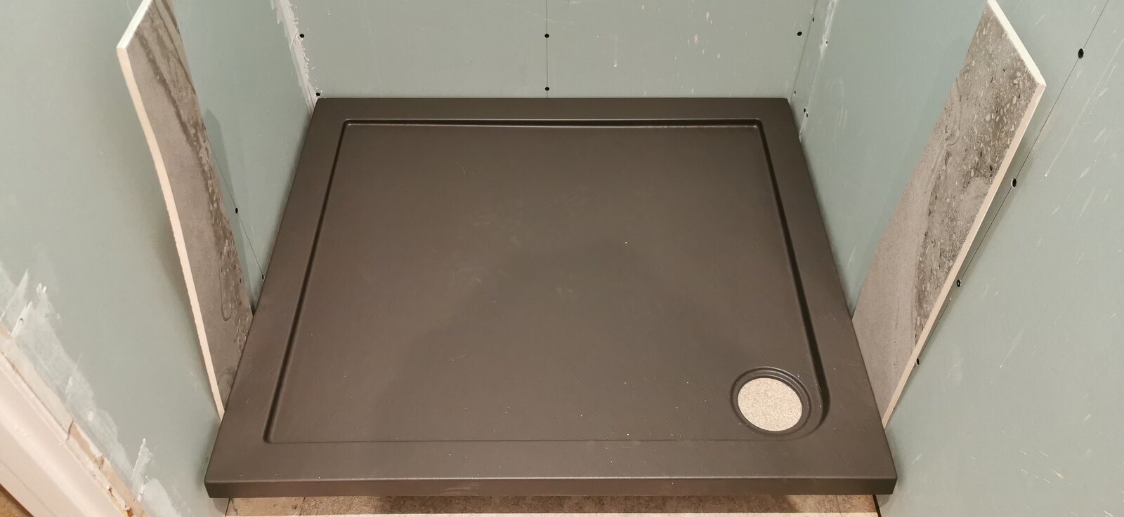

Hi,
I'm redoing my ensuite and through an accumulation of a victorian plumbing shower tray being 890 instead of 900 advertised and my tiles being 6mm instead of 10.2mm like advertised the tiles slot down both sides of the tray. What can I do to get over this as I belive the tiles need to drop down onto the tray.
See attached photo.
Thanks!
I'd add another board on one side if it was me. It's all mechanically fixed so not too big a job. Slightly thicker adhesive and you're sorted.
Watch out that the new plaster doesnt strip mositure from the adhesive too fast - your tiles wont be properly fixed in that situation...
