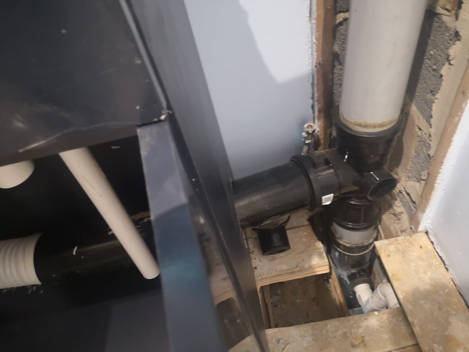

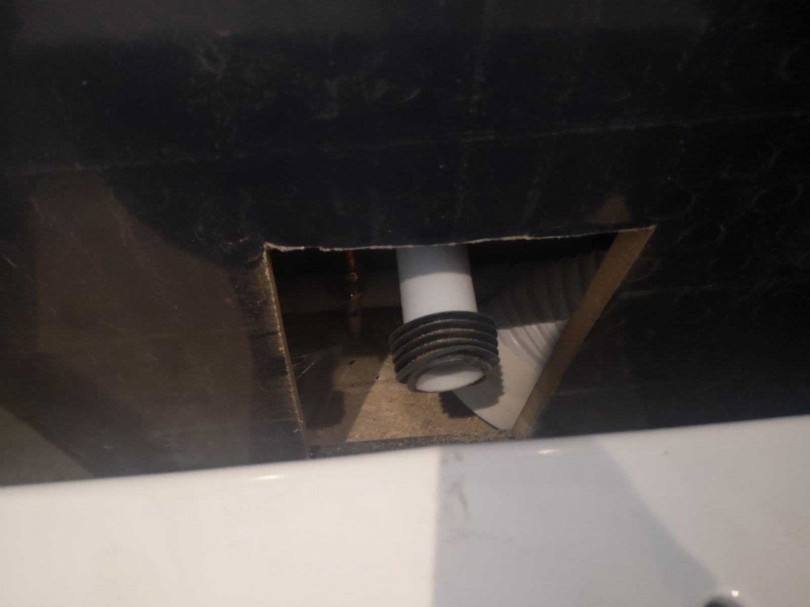

I have a plumber doing some work for me at the moment, he's fitting a toilet and sink combined unit.

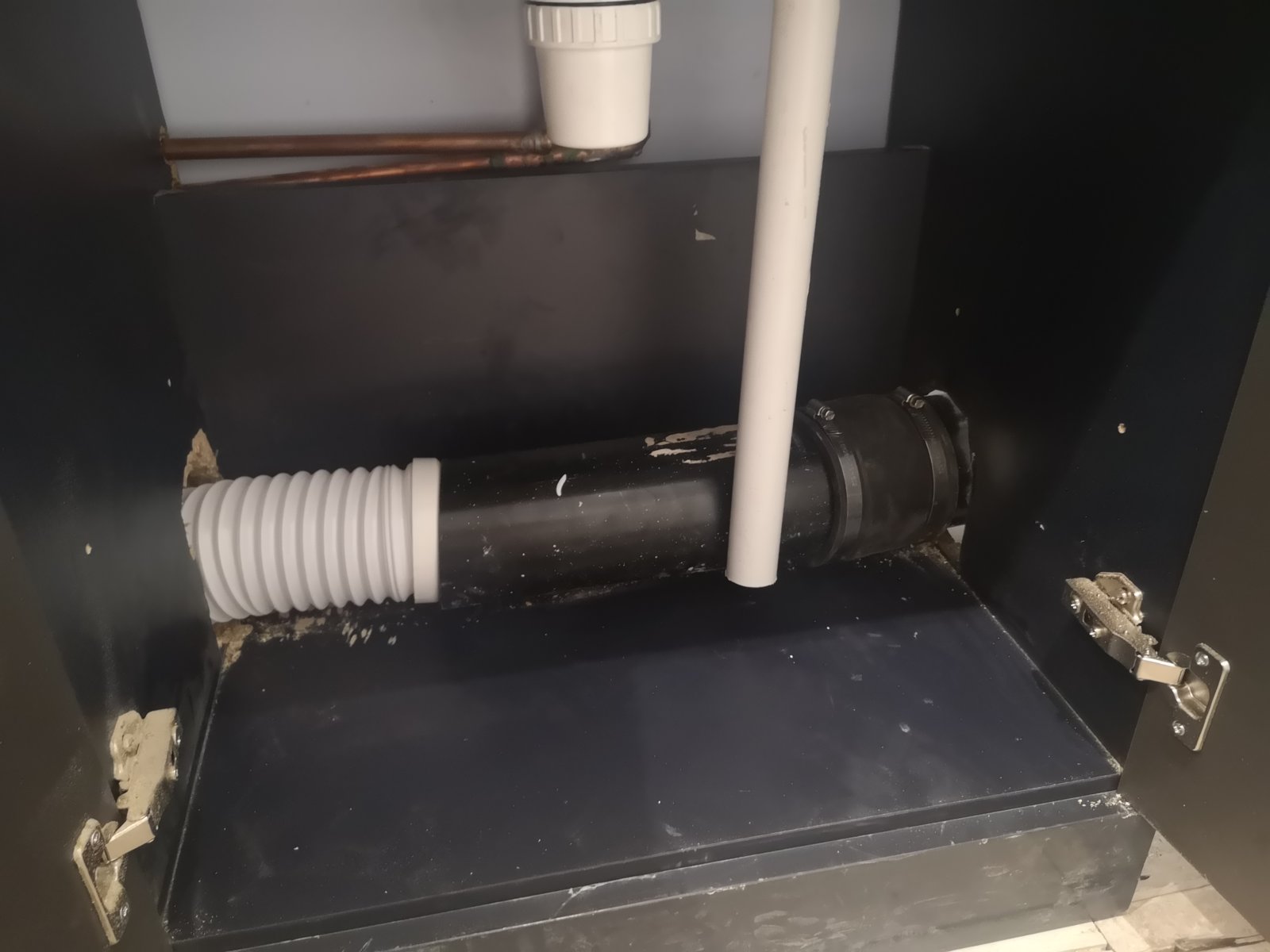

The toilet isn't plumbed in just yet, but my builder said in his opinion, this doesn't look great and feels its possible not at an angle enough to move waste along and down the soil pipe.
He said he's not a plumber and just his opinion but to though I'd ask on here so far. I'm paying him decent money so would be nice if the jobs correct or going that direction at least
Cheers
Photos so far

Hard to tell from the photos but it looks like the flexible pan connector is running uphill - they're not the great at the best of times but running horizontal or uphill is going to give you problems quite quickly!
That 'T' connection in the downpipe needs to be lower surely? Looks a bit of a lash up to me.
I missed the second photo when I read your post last night!
Branch to Fernco connector to PVC to flexible pan connector and they all look to be falling back to the pan.
As Motman says - a lash-up!
From the photos (only a spirit level will really tell you) the only "fall" on that soil pipe is the "fool" who installed it :LOL:
You can get away with a short horizontal run but not with a flexi and certainly not with a backfall.

Oh dear, he's not a very good plumber by the looks of it I'm afraid. His ability to look at a proposed installation and set it out properly is non existent IMO.
Firstly the branch should have been cut into the stack lower to provide at least a 45mm drop per m, then using a flexi - nothing inherently wrong with that TBH but - without any fall :eek: and then using a fernco to connect the soil pipes up to get around the slight offset, that's a major problem waiting to happen. The cabinet should also be opened up properly to suit the pipe run or toilet relocated.
I'd be binning him TBH.
I have had 2 plumbers come our and look at it now, both said the job isn't good as you guys would likely expect.
One said he'd rip it all out and start again, another said it shouldn't be a massive problem if he can get a decent fall on it all.
