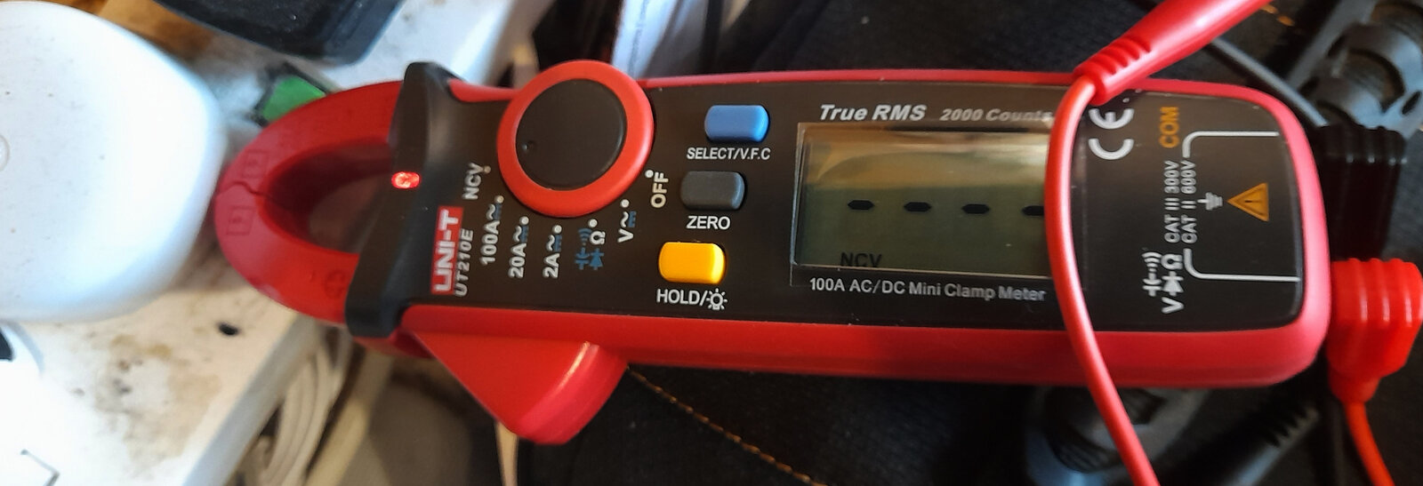

I use a multi meter with NCV (non contact volts) Testing for live.jpg which does allow testing without removing the covers to some extent, but in the main when a shower stops working we can either see the fault, simply using our eyes, like burnt contacts on the isolator, or simple continuity test, faulty on/off switch for example.
