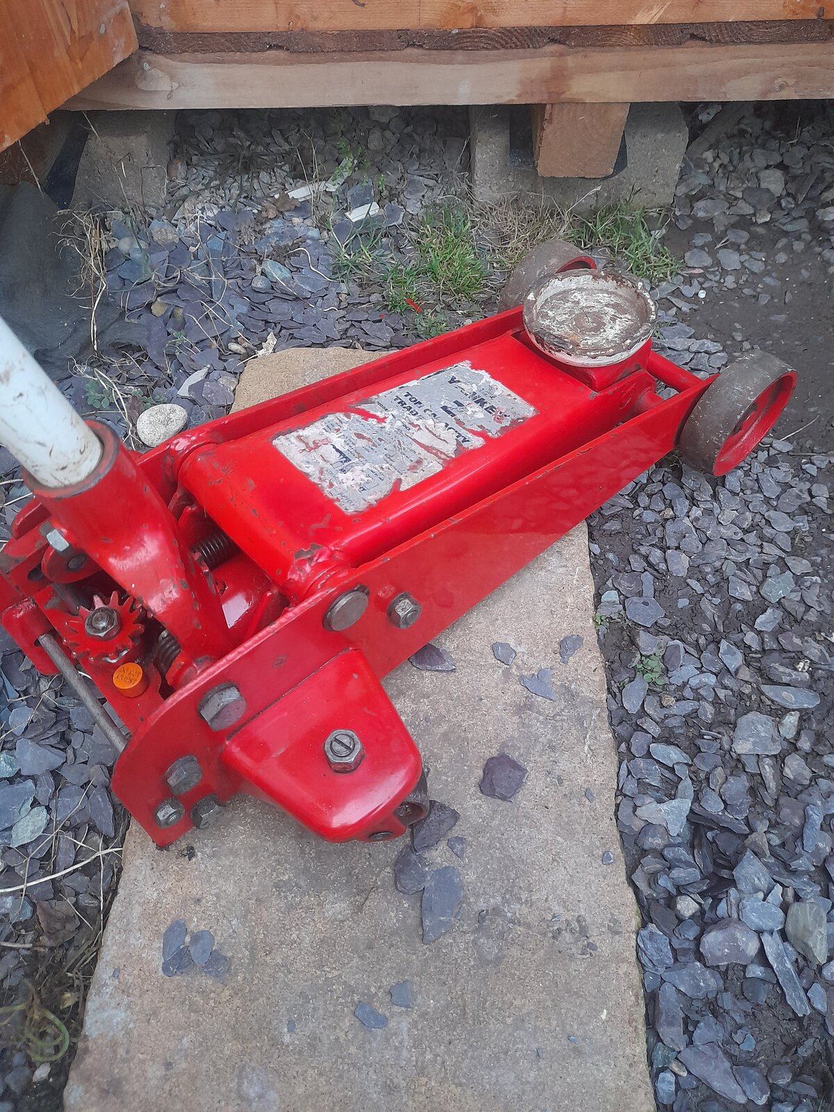

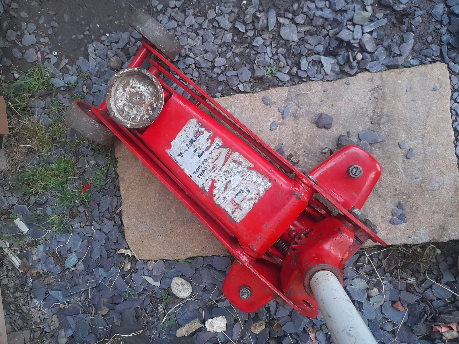

I bought a used sealey yankee 2 tonne trolley jack. When I got the jack it was low on hydrolic fluid, so I filled that up and bled the jack. The jack lifts ok but when lowering, it drops the vehicle way too quickly. And I'm careful when lowering not to release it too fast. Does anyone have any ideas on why the jack is behaving in this way? What do I need to do to repair it.

How easy is the release valve to turn or not ? By hand, not by using the jack handle?
Initially the release valve is a little tight right at the start but then it turns quite freely.
Sounds like the initial tightness is the issue then. Opens too far, too fast maybe. Any corrosion or dirt around it?
I think this is the v1 of the yankee jack, I will have a search online for a service kit for it. It doesn't drop suddenly after the initial tight bit,I would say a quarter turn after this and then drops suddenly.
