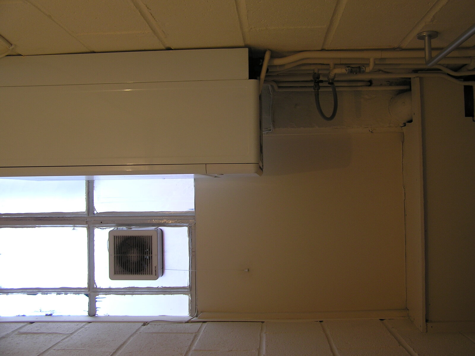

Nope he didn't do a thing, he turned the gas ON put boiler plug in wall socket fuse tripped and said "PCB blown old boiler no parts ... new boiler £1800", turned gas off, I asked him to confirm in writing, he said he will do in few hours but nothing since yesterday. He didn't even open front panel. So I suspect he is not genuine and making it a big issue. I think I won't tell the next gas engineer that boiler was turned off for so many years, I will just say tenant left and turned gas off.

The idea of it. Ring the socket is clutching at straws. Presumably the plug is for the whole system? Did he or you see a flash or hear a pop at the boiler?
Make, model and pics would help.

Don't know model number. Only have the pic which doesn't tell a lot, I am going there tomorrow. No flush or hear anything
