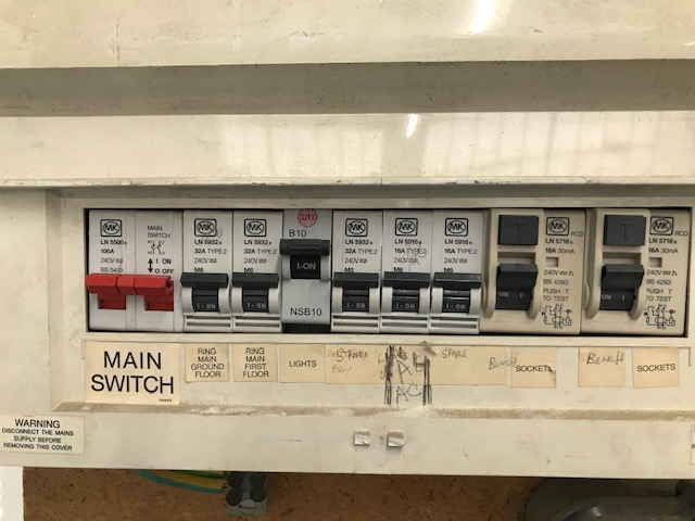

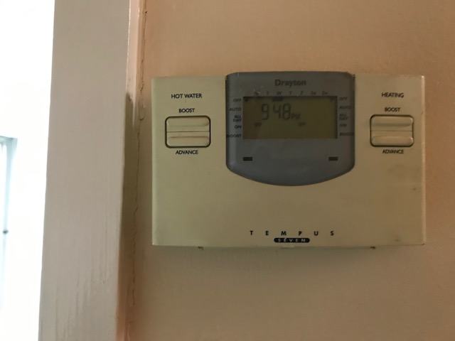

I plugged in boiler and gas on, boiler switch is ON, Central heating switch to constant, turn hot water tap nothing happens only a click from inside boiler. Turn heating ON from Drayton timer (pic below) and the fuse trips in Consumer unit, its the first from the right labelled BENCH (pic below)

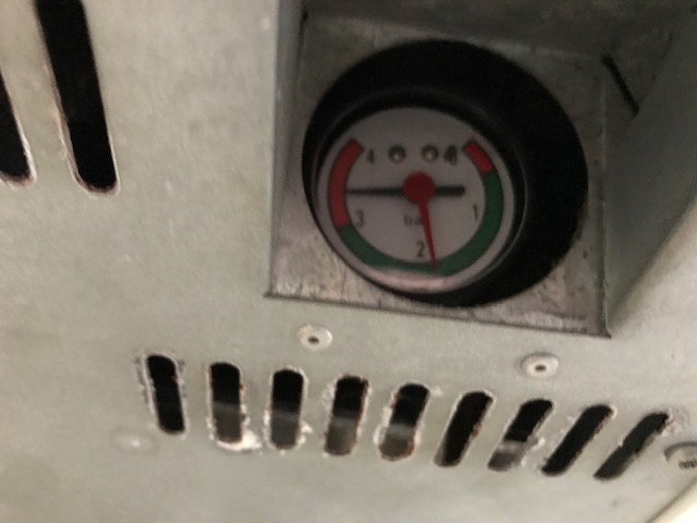

Panel shows "low system pressure", but gauge shows over 1 bar, why is that?
Firstly it's not the MCB that's tripping, that's an RCD. As suggested there could be a fault condition leaking to earth and it's tripping the RCD.
Secondly, tap the pressure gauge for the boiler and see if it moves, if it doesn't then the boiler is way over pressurised ..... more than 1 bar .... try more than 3, way too high if that's reading properly. You may be getting a faulty low pressure light because the sensor's goosed, again probably because it's been inactive for 10yrs. I would also expect the dump valve to have release some of that pressure though, unless the fill loop has been left open or the valve has jammed.

2. Clear out the impulse pipe to the pressure switch, and replace that switch (relatively cheap component).
3. Check/replace the safety relief valve.
4. Recharge/replace the expansion vessel.
In summary, it is reasonable to suggest that the expansion vessel has failed in one of several ways, the tenant has become tired of regularly topping up the pressure and has left the filling loop valve(s) open, leaving the relief valve to operate regularly, and possibly fail to close properly. The pressure switch may be a secondary casualty, and leaking also.

you would be better putting the £500 towards a new boiler, if it is indeed the boiler causing the problem, that boiler was a piece of shoite straight out of the box, another thing , you have a 2 channel programmer controlling a combi boiler, unusual but sometimes done, if you have another zone the motorised valve for that zone could be tripping the electrics
