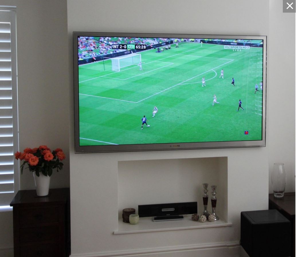

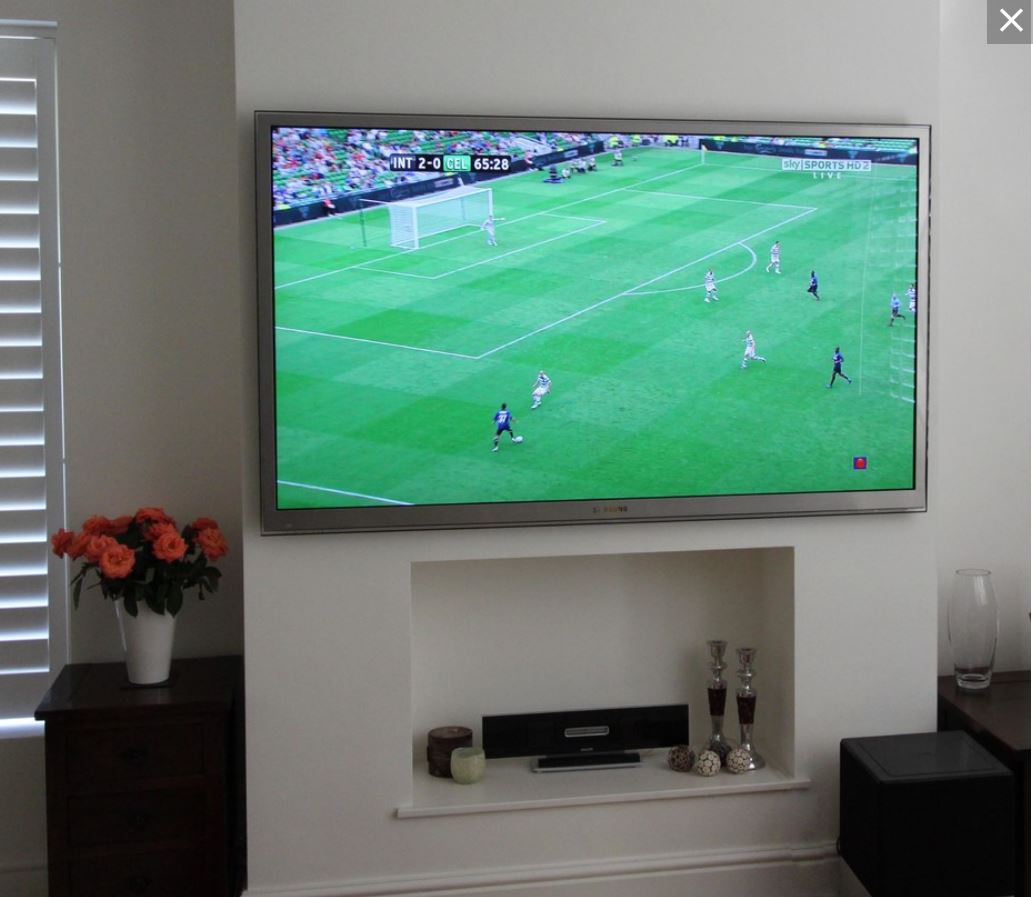

so you end up something like this - not my photo. But I have done the same but added an extra bit on the side that incorporates an ikea bookcase that facing to the side and not the front - this then gave me enough extra room on the brest for my surround sound speakers each side of the TV, unlike the picture that the tv gos right to the edge.
At the back of the fireplace hole - if that plasterboard is off the wall by 2 inch on battens then you can have your cables go behind this and up the chimney to the tv. Also if you did this you would not have to do any chopping in and you can use a drylining socket box.
Also on the front of the brest into the skirting board there can be fitted an air vent that gos under the dvd shelf and then behind the back section to maintain an airflow up the chimney.
This is brilliant. In the pic you shown above. Is the socket behind the TV ? I know its jot yrs but that's quite high up if it is.
I need to go home and check if it's plaster... if I end up putting a drylining socket box. Then the socket will below the TV as it will be below the TV height ?
I am guessing that this chaps socket is behind the TV.
In my set up I have two double sockets that are in the fireplace hole at the back - behind what looks like the chaps sound bar next to the candle sticks. I added them to the ring main to keep the ring, plugged in I have the TV, a sound system receiver and a bluray player and a now tV box. The wires and connections go down in a hole and up the back out through a hole behind the TV so no wires are seen. I also have wired LAN cable direct to the router in there too and the wires for the surround sound all hidden.
