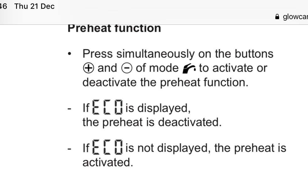

If the rads are heating up when the preheat is on then it’s likely the diverter stuck in heating mode. Try the following for turning preheat off, then get a gas safe registered engineer to come and take a look for you
So I think I've cracked it after reading the manual - I checked the code state and it said pre-heat mode, noticed that there was an option in the boiler settings to disable pre-heat mode...low and behold the boiler is behaving completely normal! I wonder why it decided to go into pre-heat mode continuously out of the blue?
For future reference (pages 51, 52 and 53):
