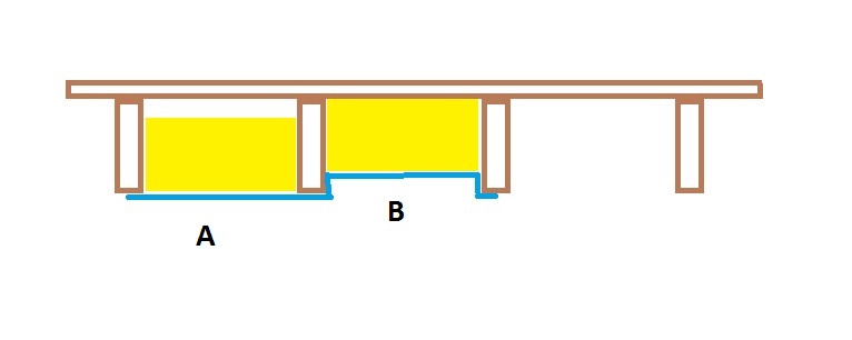

So the depth of the joists is 5 inches, so about 120mm however most insulation is either 100mm or 170mm. Practically it makes sense to use 100mm but how to fix it, flush with the bottom of the joists (A) or flush with the floorboards (B). I would have thought it probably more effective flush with the boards, but a bit more of a faff to install/

You should be able to find 150mm - squeeze that in. It's very compressible, and/or it can hang out a bit.
Rockwool flexi slabs are supposed to be available 120mm thick but may not match your joist spacing.
