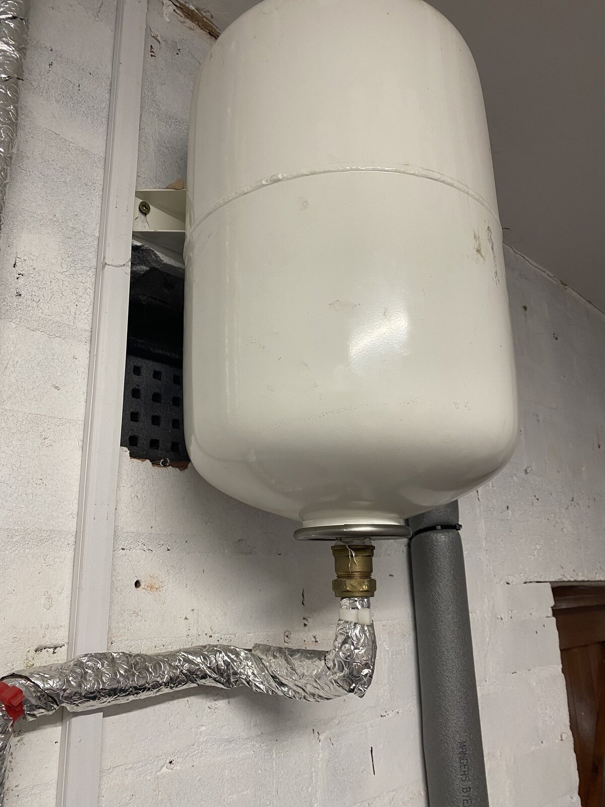

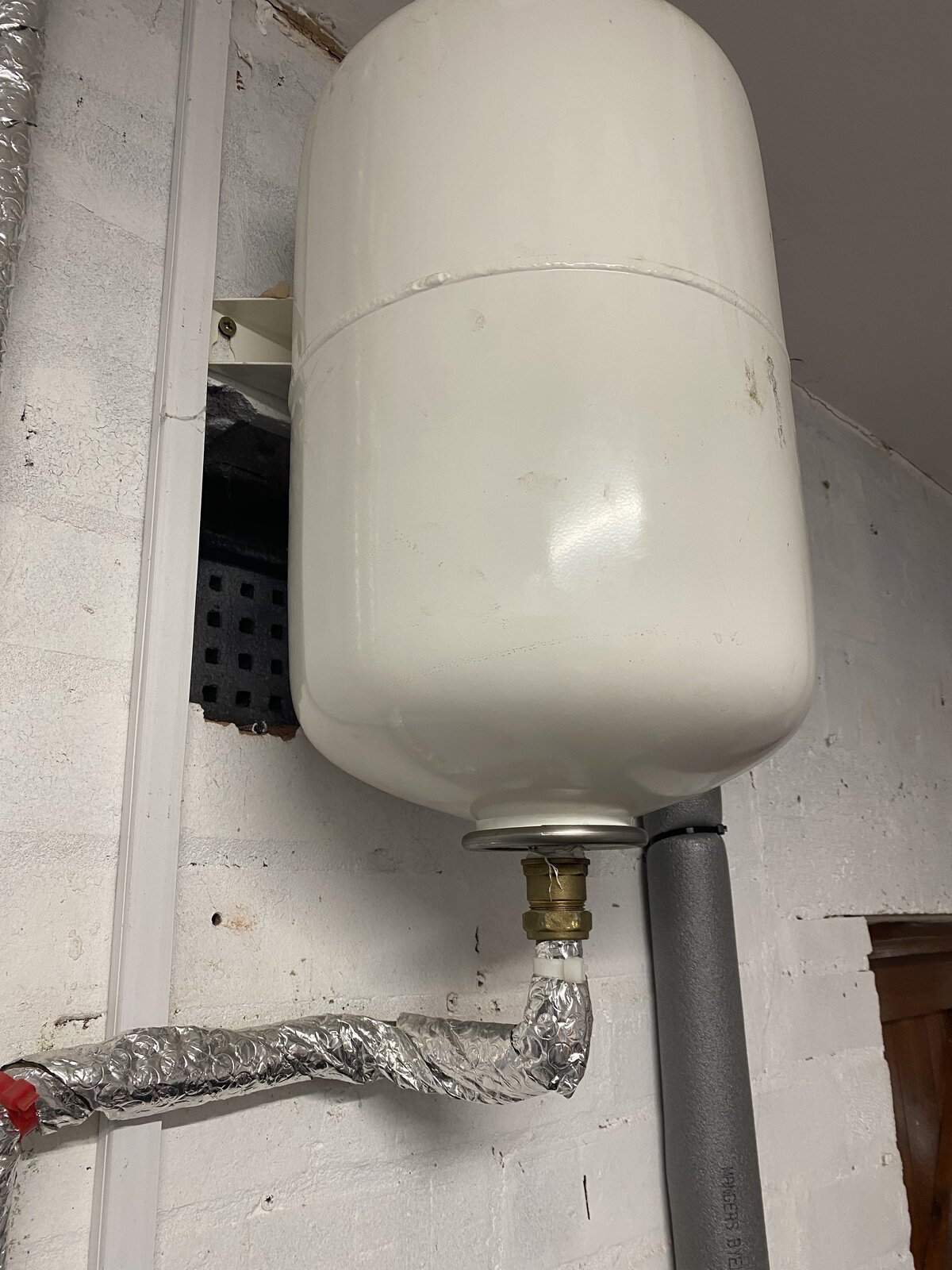

If it's only 5 yrs old I doubt the EV will need replaced, just re-charge but never say never, what size is the cylinder? post a pic of the UV and EV data plates if you can
vaillant 250/3 unistor. Says 245 litre. I got the part number of vaillant for their EV. It’s 200 quid
As you can see it’s mounted against above a vent . It is blocked out at other end. So I was looking for mount in same region
Invariably the larger vessels have the same integrated mounting bracket like that. They don't tend to use the separate screw tight bracket/band types. Always good to check though.
I wouldn't worry about it until the old one is condemned though you are looking to get Vaillant out to do the service, they £99 isn't too bad BTW. If so though and it needed replaced, they would replace it with a Vaillant item at the typically increased cost.

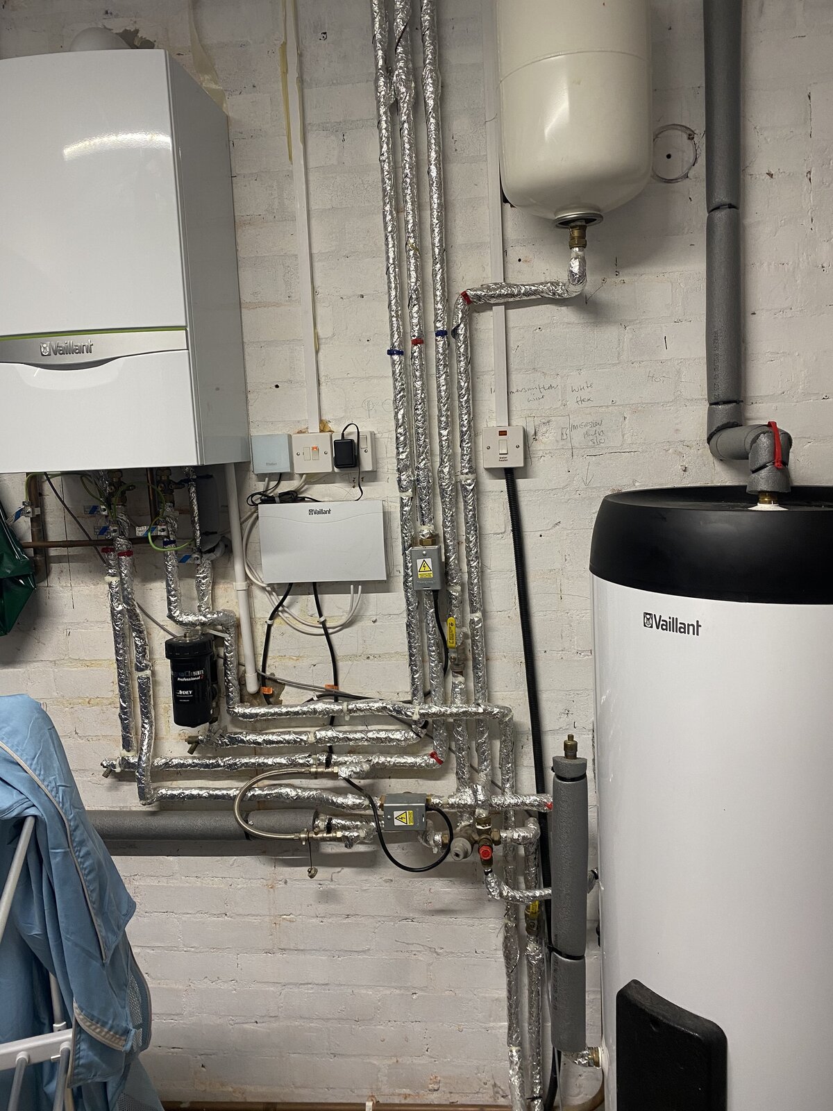

Vaillant back tracked and said they don’t service cylinders. They will look at them at most. It’s a real flaw in the model. So a local plumber with g3 is coming to service both for 100. If the EV needs to be replaced it would obviously cost more. I did get a prv valve from tool station incase. And I’ll return it if he doesn’t use/need it.
there is no service plan or option of service vaillant offer on the cylinder. They told me to ring vaillant advance engineers. i rang the nearest 5 “vaillant advance” plumbers for a service. The minute I said tundish is leaking they refused job and even said “no one will do it” the other told me I need a EV and and new prv. And quoted me based on that. Without even looking.
I did previously contact HomeServe and BG for a policy. They offer boiler and central heating. Which does cover the unvented cylinder. But I was not eligible to buy the product as terms state “if boiler is under manufacturer gaurantee you can’t take the policy.” Even if I wanted to exclude the boiler element and was paying for a element I did not use.
next time I will purchase megaflow. I would lose out the functionality to set the cylinder tempreture on the app AND the hot water boost function but I can probably live with that.

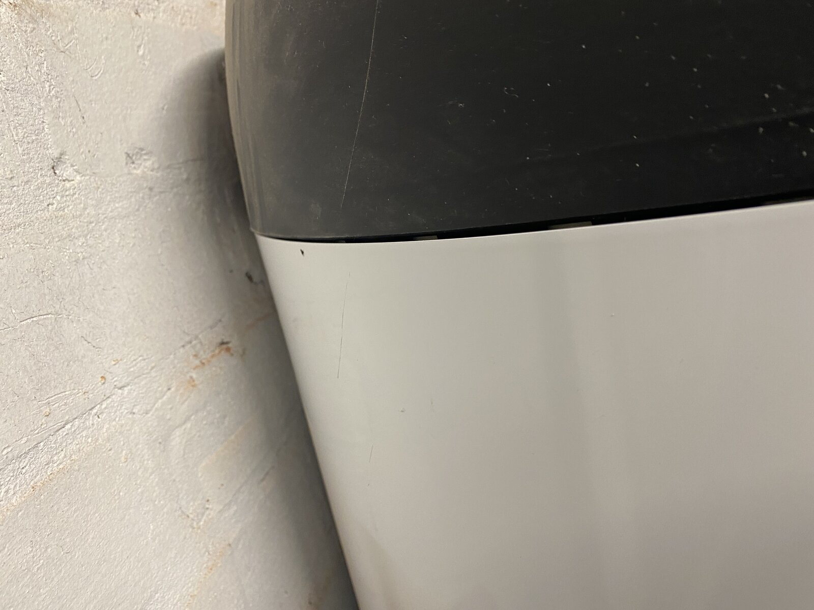

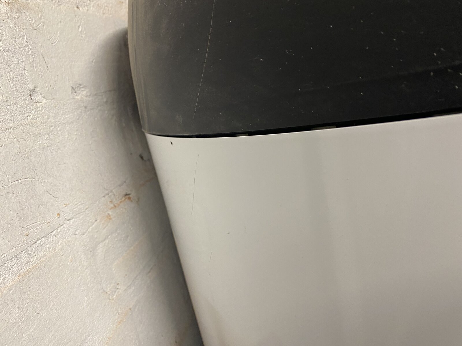

To compile to the misery the shell has gone a bit loose. Vaillant came down and said it’s coesmtic and can’t cover it (there’s a additional 25 year cylinder gaurantee , which only covers the inner shell).
I have started a complaint to vaillant out of principle .
