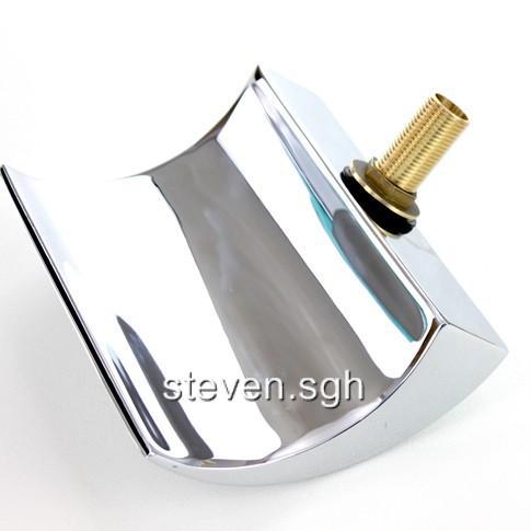

Hi.
I have bought a waterfall bath tap off the net and it has been shipped from china.
I had to cut a particular part down but messed up and cut to much off. I need to get another one, but don't know what the part is.
In the image, it is the brass part coming out of the bottom of the main tap.
It has a 20mm outside thread and the other thread is 16mm outside.
Does anyone know what this part is?
Cheers.
There's a thread one end that screws into the chrome tap. I can't measure the internal dimensions properly because it is a hexagon shape to allow you to tighten it using a radiator key.
The other end accepts standard fittings. Internal dimensions 15mm.
Cheers
It looks like this. http://www.bes.co.uk/products/158b.asp Hexagon BSP Taper, Reducing. By your description you want the 1/2" to 3/4" reducer. But I don't know the length. This is the problem you get if you get something from China or India you've got no backup if something goes wrong. Save a few quid on the internet and loose a fortune if you have a problem :rolleyes:
Hi Mountainmick.
Yes that looks like the part.
I hope that it is 3/4 to 1/2" now and not some weird chinese size.

If you mean Part # 10596 it wont do the job. Much too short. It's just a bog standard reducing hex nipple. There will not be enough thread to fit a washer, locknut and tap connector.
I took the part and tap to a plumbers merchant and guess what, They didn't have a replacement part.
He said it was typical, as I've bought it of the net.
He managed to give me a few other part that I've had to put together, which I've done, but can't test it properly.
The extended bath waste that I also bought off the net has a screw that is to short, so I cannot fit it yet. I'll have to pop back to the merchants to get a longer screw.
Cheers.
You won't get anything to fit I'm sure of it, only option is buy again or if poss contact the Chinese lot
