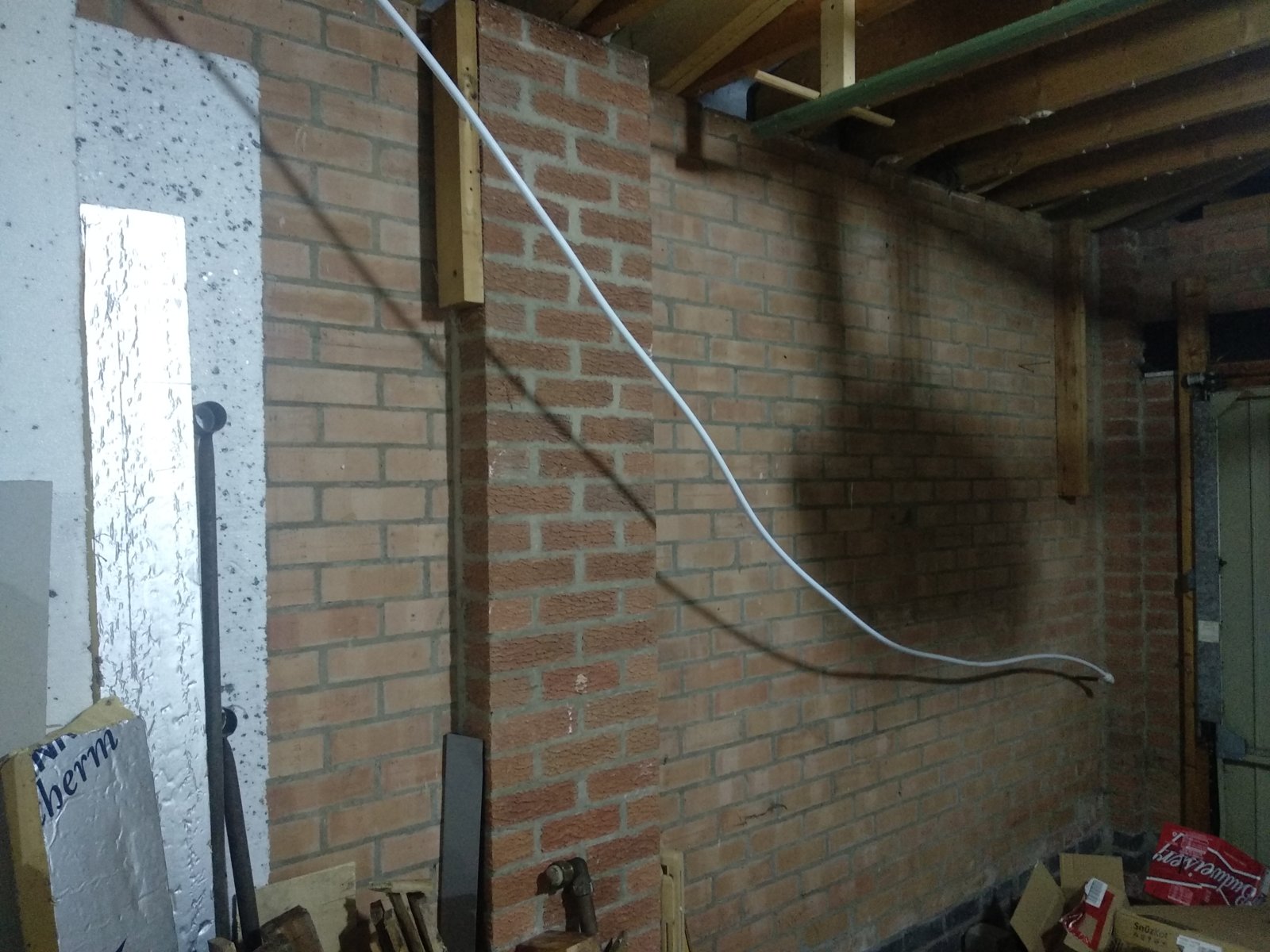

Hoping to get some advice on a few building questions before the new work starts. We are extending above our single brick garage (with double brick piers every 2.4ish M)
In order to create the 100mm cavity above we need to build out the existing piers to support an 8M long 203 X 102mm UB.
Are wall starters sufficient enough to secure the new blockwork (starting off the "to be exposed" footings) to the piers or does the new need to be somehow bonded to the existing?

You can't normally tie piers supporting beams with vertical wall starters.
What do the engineers calcs say, that's what you need to do, as the engineer is guaranteeing the design.
For the block and brick question, you could do that, but you don't seem to have a plan, you can't make it up as you go. Building inspectors are not there to tell you how to build and may hate lots of questions

It depends how (if) the engineer has calculated the load transfer from these piers.
Normally loads are shared between the pier and the wall it is attached to, so it's either bonded in, or thicker ties built in. Wall starters don't perform in this way, and are designed to allow vertical movement so are the wrong solution.
Sometimes piers are large enough to take the loads on their own, with just some nominal support off the existing wall, so different lighter duty ties may be suitable.
But you won't know unless the engineer tells you how he has worked it out.

Agree, that makes alot of sense now I think about the construction of a wall starter as they are designed to slide. Sounds like bonding in would be the best option and maybe a mechanical fixing as a belt and braces.
I've included a photo of the piers at present, they aren't toothed in but I'm assuming wall tied together as they don't seem to have moved over the years. The front of the garage is being rebuilt so the initial pier will be pukka.

Just to update and hopefully get some more advice. The structural engineer has replied and said that the piers are to be built (bonded) into the original brickwork using 7N blocks (assuming toothing in every 3 courses?) So from the front it will be a full block and two half blocks bonded into the pier. If that makes sense.
Where the proposed timberwork is doubled up (i.e under proposed stud walling) it says to bolt using M10 bolts and form G washers. Can we use carriage bolts and G washers? Or is there another method? I think I've seen something called Joyner bolts?

Use any bolt, or threaded rod, or coach bolt, as long as you also add a wide thick 'penny' or square washer.
If these double joists are more than 150 deep, then put the bolts on the 1/3 depth axis (ie 1/3 down and 1/3 up) and stagger these, so one on the top axis and the next one on the lower axis etc. First one about 200 in from the ends, then 500 centres will be OK.
