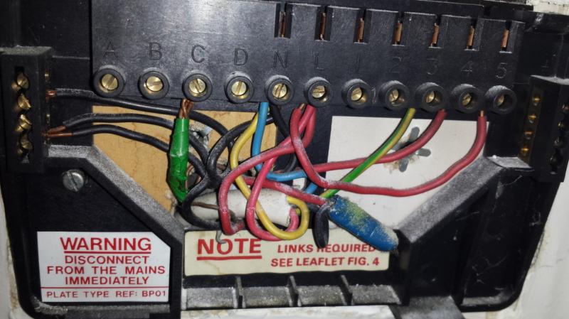

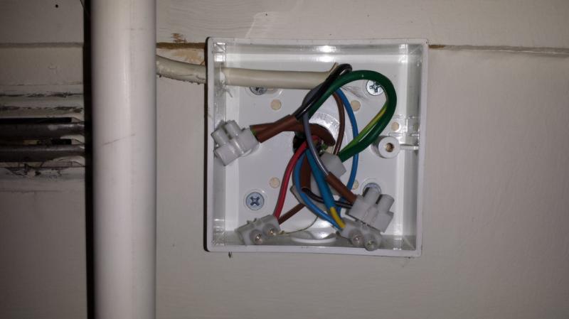

Hello all I still did not find decent engineer in Aberdeen. However did manage to trace the pipes with the help of Friend. Could you please see the attached diagram and advice what type system I have my friend reckon that its fully pumped system and easy to convert to S plan.
Please note this what happens when Potterton EP2002programmer operated.
When H/W is called from programmer: boiler switches on along with pump and supply hot water and when desired temperature is met Tap stat will shut and boiler will switch off but programmer H/W light still stays on.
When C/H is called from programmer 2Port valve will open and switch on and fire up boiler and pump and heat will be supplied to radiator.
What type of system is? and what is the best option for me to upgrade. Please advice. Thanks

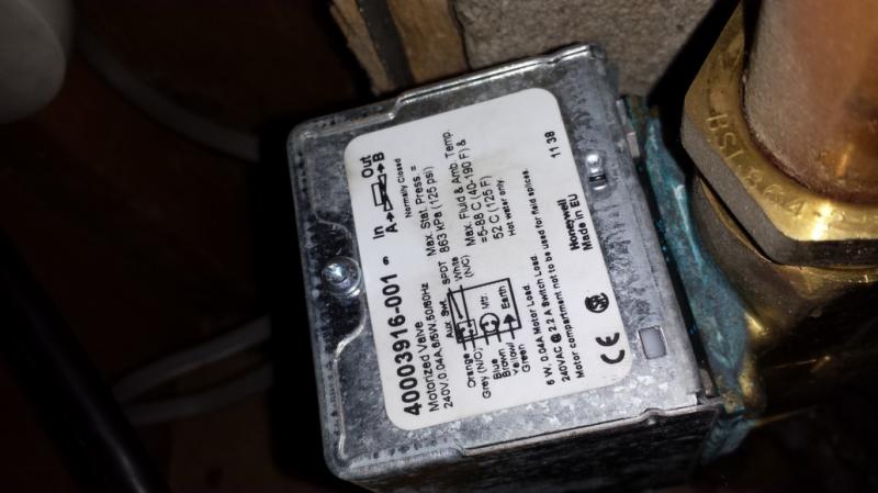

Mogget: Thanks very much detailed explanation looks like Mitime 5 pack is the way forward. Only draw back from the pack is does not allow to control through internet or phone...(May be I am being crazy)
I know you always mentioned about auto bypass and also upgraded diagram. I went had another look on the system I see there is by pass already and looks like 15mm pipe not sure it is auto or manual. Will post some picture tomorrow. Then again if I decide to it myself using Mitime, I will update the reviews. Thanks for all your help

Blagard: There is pipe from the boiler which runs to expansion tank believe it is vent and 22 mm back to boiler I assume it is cold feed. From cylinder 1 pipe goes up to the header tank and another one come back to cylinder. I will try to put some photos tomorrow.
with respect to upstairs and downstairs manofileds its not straight forward...I still need to trace which is going upstairs and downstairs but certainly they are set of 2 branches. thankfully our suspended floor are more than 1 meter headroom so can easily go and trace the pipes!! Thanks for your help again
