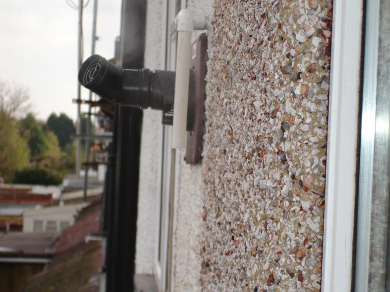

I am attaching a photo it is taken from my window the pebble dash is the start of my house, and you can also see the start of my window frame (right side of photo).
I am not sure if you can zoom in on the photo through this forum
It has also just occured to me why it has been put at this height the guy simply stood on the flat roof and this was his height so drilled it at that height, rather then use an additional ladder to move it higher!!

that flue is directional, you can twist it away from your property quite easily by hand. ;)
[that flue is directional, you can twist it away from your property quite easily by hand. ;)[/quote]
I don't think that will do it if the wind is blowing in my direction, far better that it goes over the roof.
good photo.
looks like an ideal boiler,i have checked the manufactures instructions for the most recent boilers.ie isar.icos and esprit.
in the flueing section ideal state.
IMPORTANT it is absolutely essentail to ensure in practice that products of combustion discharging from the terminal cannot re enter the building or any other adjacent buildings through ventilators,windows,doors or other sources of natural air filtration or forced ventilation/air conditioning.
if this occurs the appliance MUST be turned OFF and labelled as 'unsafe' until corrective actions can be made.
well thats what they state,although they print many dimensions in the manufactures instructions every installation is different your neighbour has an additional flue diffuser fitted and they (ideal the boiler manufacture)cover themselves by the above statement.
personally if i was doing this install i would chose a vertical flue kit which terminates above the roof line.try and take a photo of the plume (steam) entering your window,this will happen more at windy times ets.
good photo.
your neighbour has an additional flue diffuser fitted and they cover themselves by the above statement.
