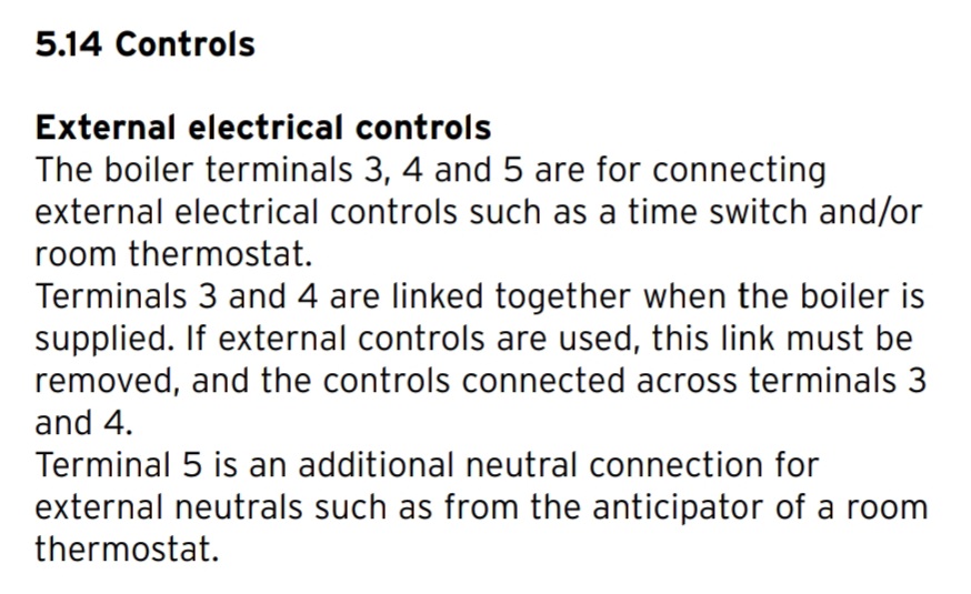

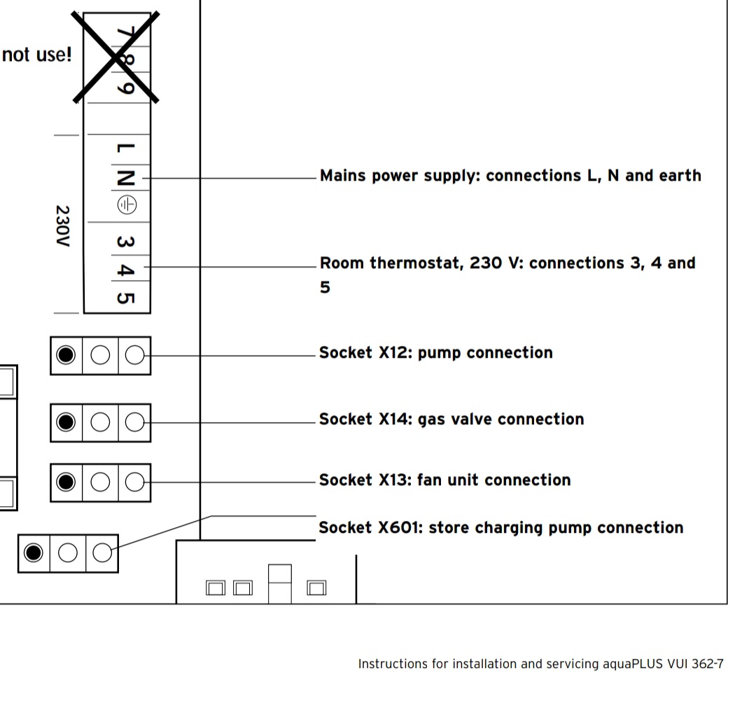

Based on this I've found in the installation guide I'll check what colours are where in here. It's a quick cover to remove (clipped) so should be a quick cross check of what's where

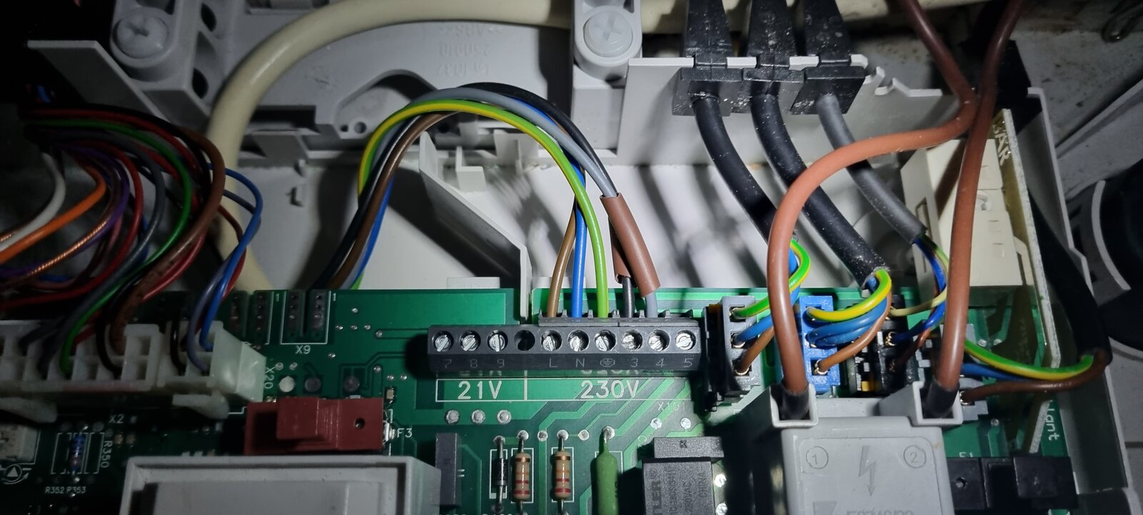

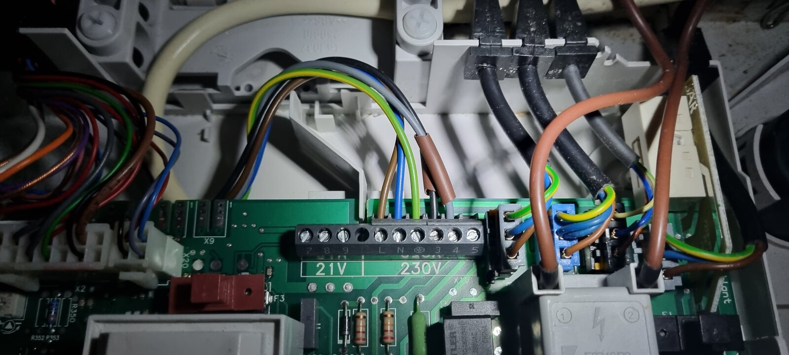

On the money @ianmcd looks like the neutral is wired in but it doesn't track down to the stat. I'll double check where the stat is that I didn't miss anything.
Assuming the neutral doesn't run to the stat location, what are my options now?!
I probably need to check behind the fused spur also go see what's happening with the bridge off cabling down to the stat, that neutral must terminate in the spur if it doesn't track to the stat.

To be honest you would be better and quicker to mount the receiver next to the boiler and get a length of 4 core or 5 core flex (B&Q) sell it by the metre, and wire the receiver direct to the boiler, then simply remove or leave in place the redundant existing thermostat. That is how it should be done, simply L&N from boiler to L&N on receiver, 3&4 from boiler to 1&3 on hive , either way round it doesnt matter, no links like you may have seen on other posts and job done
Would I just wire it out from the 5 terminals in the boiler using all the cores? Take it I can just daisy off from the boiler terminals in my pic and run a new cable to the hive on the wall? That would still enable the hive to be killed by the Spur correctly
Where would the two brown sheathed ones go Hive side?
Perfect just seen your post edit.

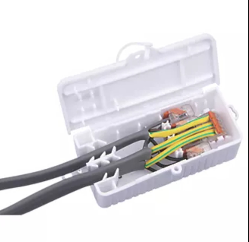

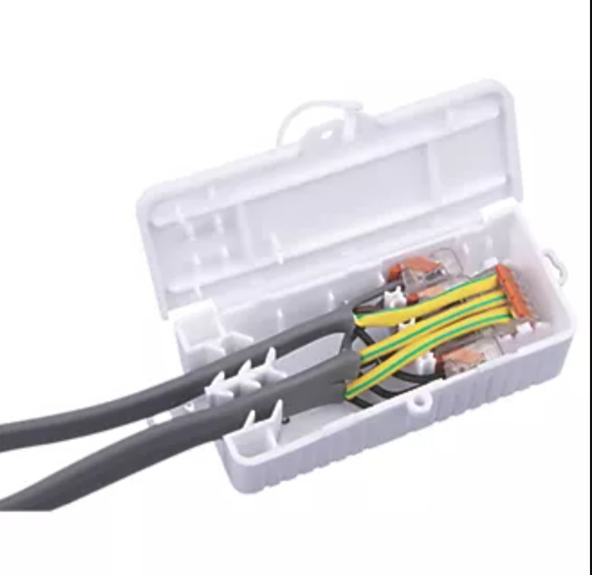

I'll just terminate the existing stat I guess at the point and chok box the terms
Where I remove the stat can I just terminate all the cables into a junction box with some wagos? Don't need to create a loop or anything daft.
Also, the boiler in 3 and 4, do I need to remove those cables and terminate them or just leave in and put the other new cable into the same screw port and therefore have double cables in those ports

3 and 4 just trim wires back to the white sheath of cable. As for removing the stat no power should be going to it, so no need to terminate safely.
